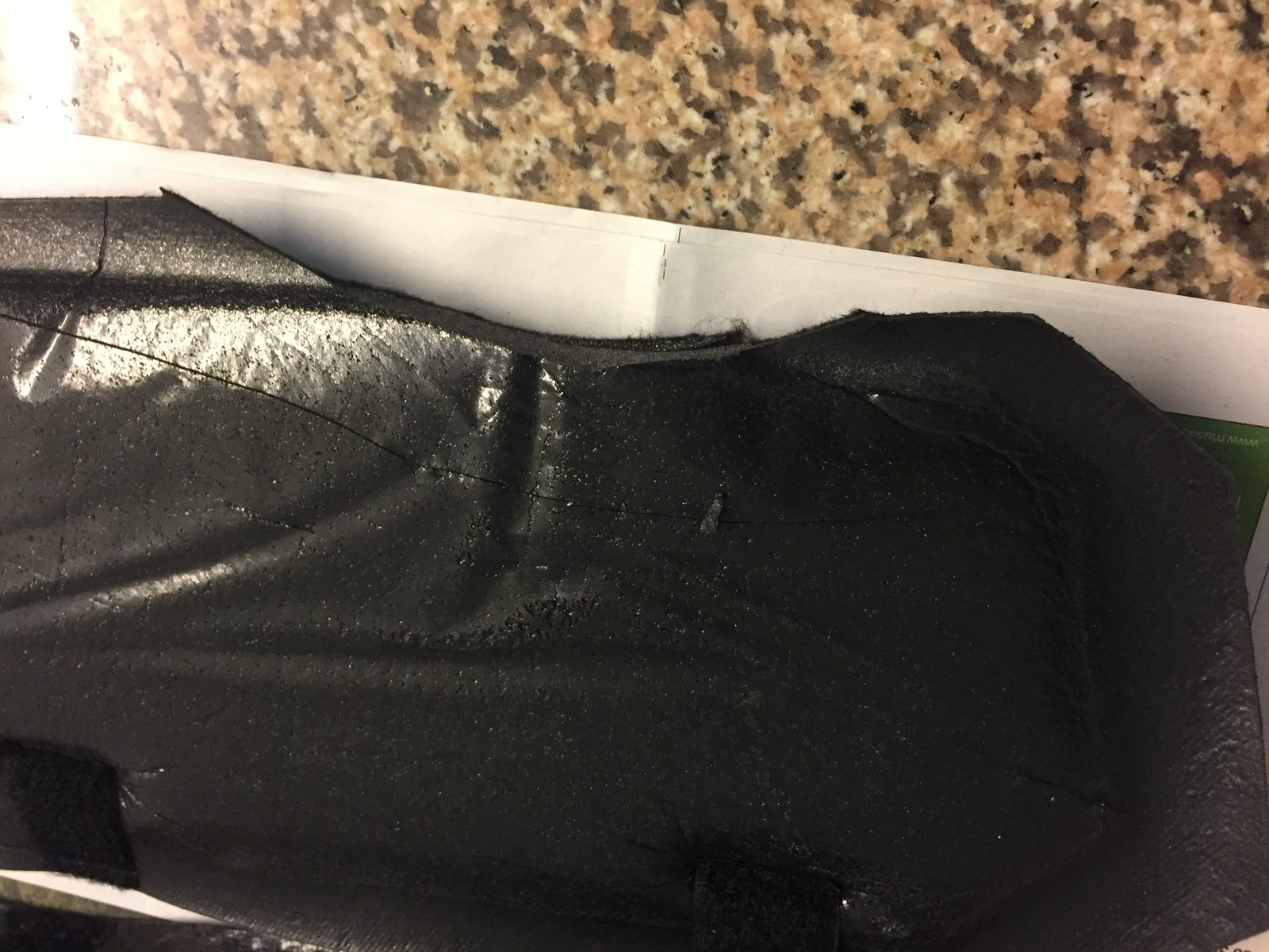

  1. Importing my bike to Switzerland only to find that the Swiss MOT requires that the under tank sound insulation be present. Not sure my bike ever had it. Unsurprisingly the parts are no longer available.

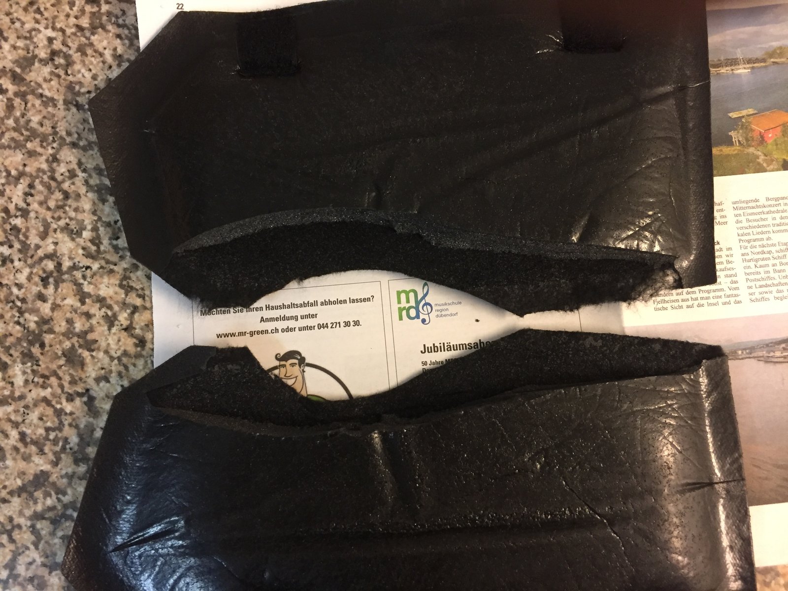

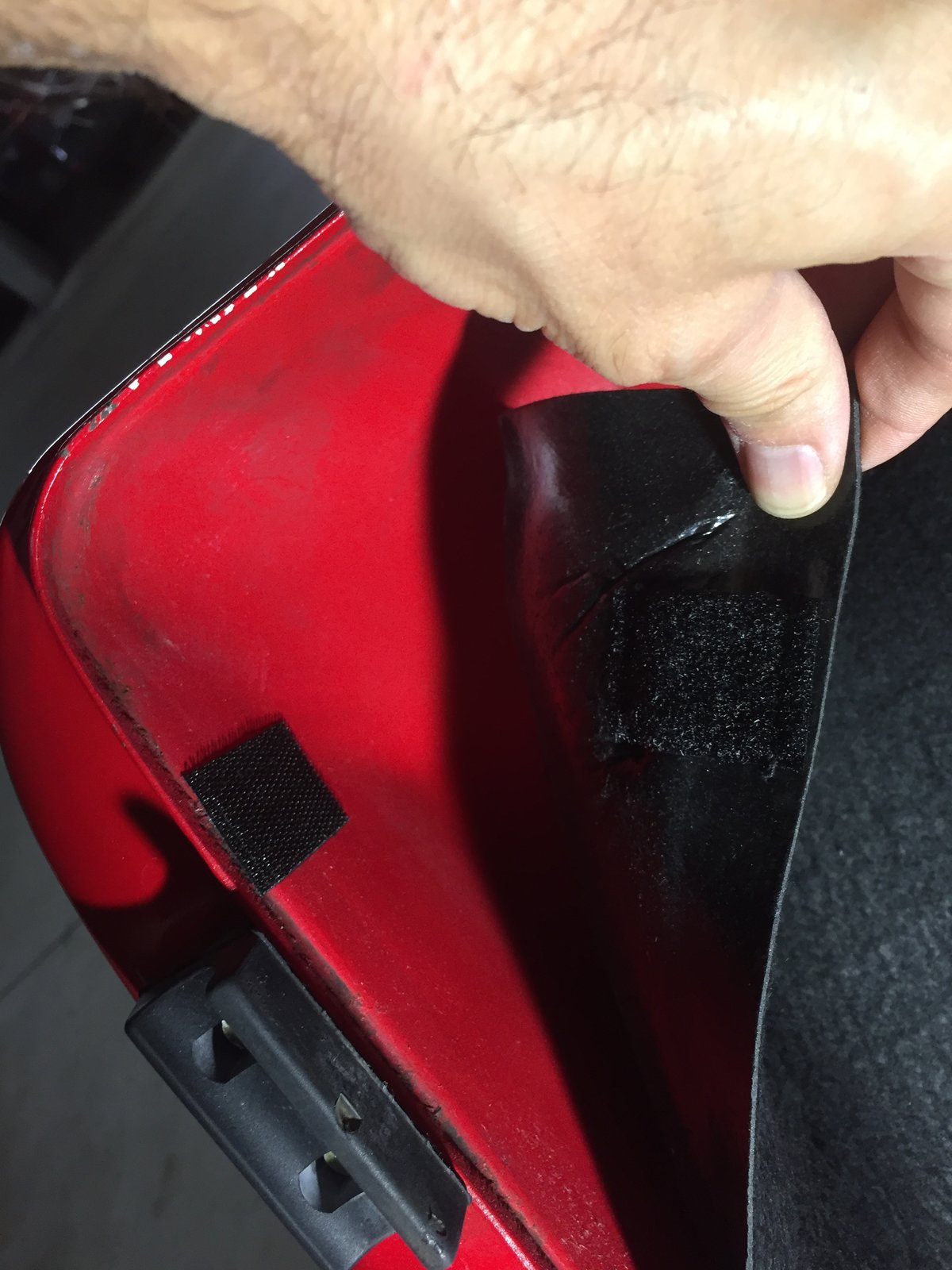

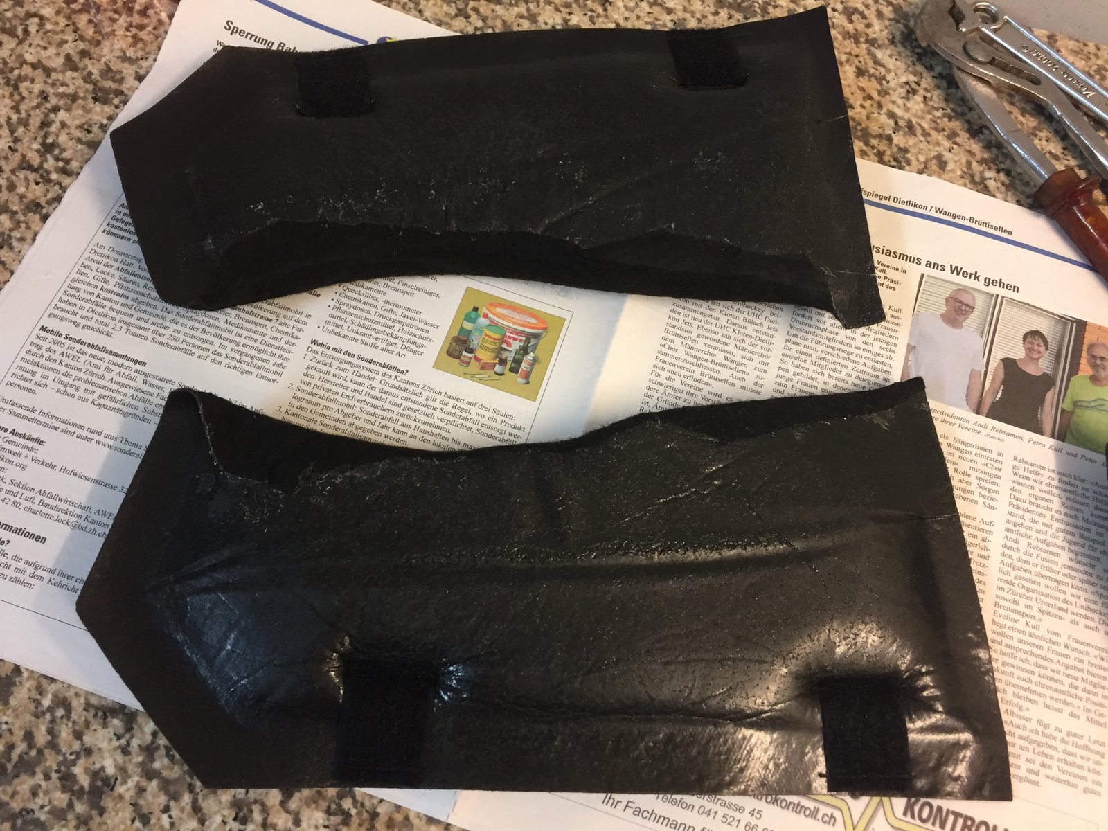

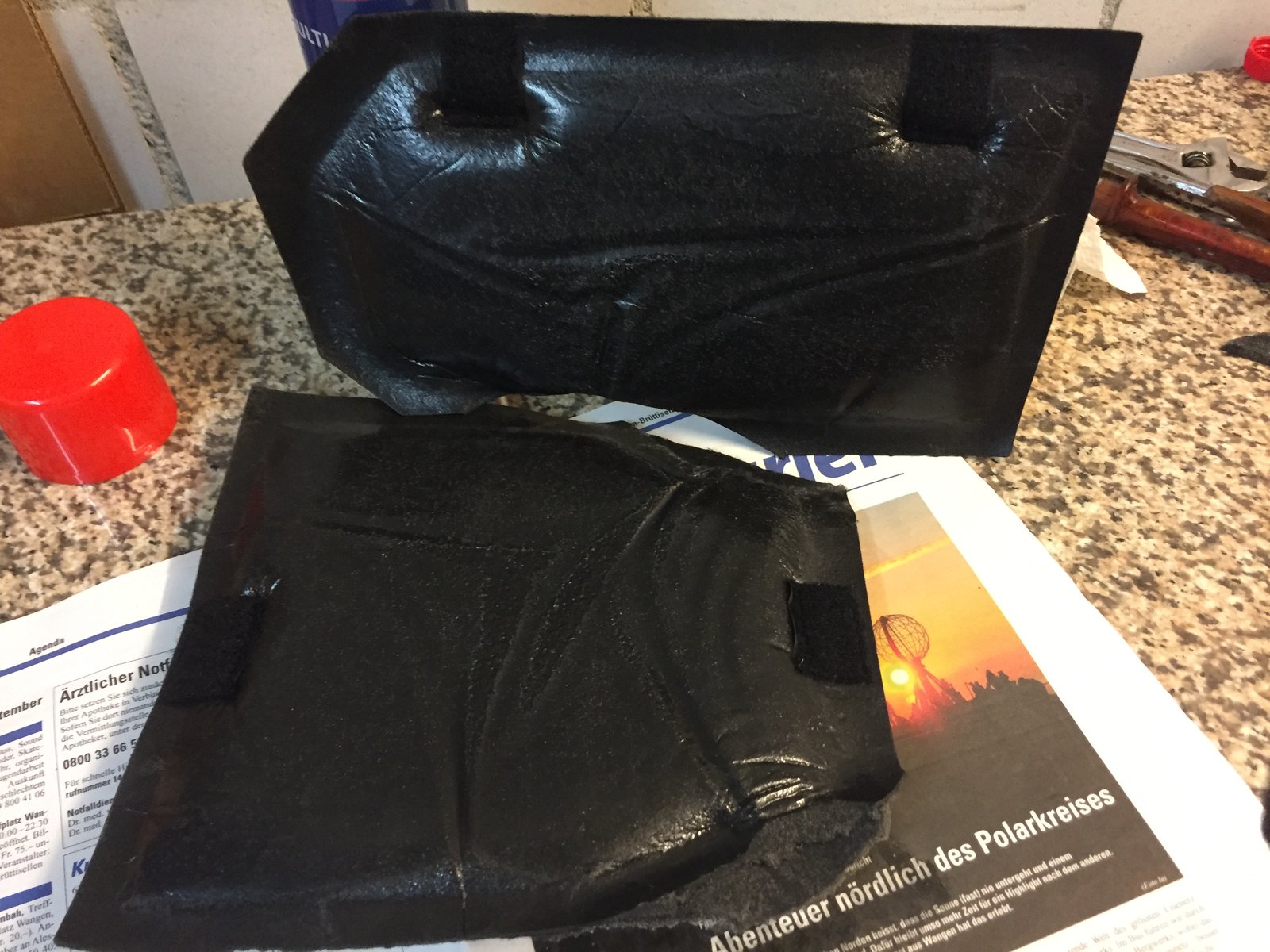

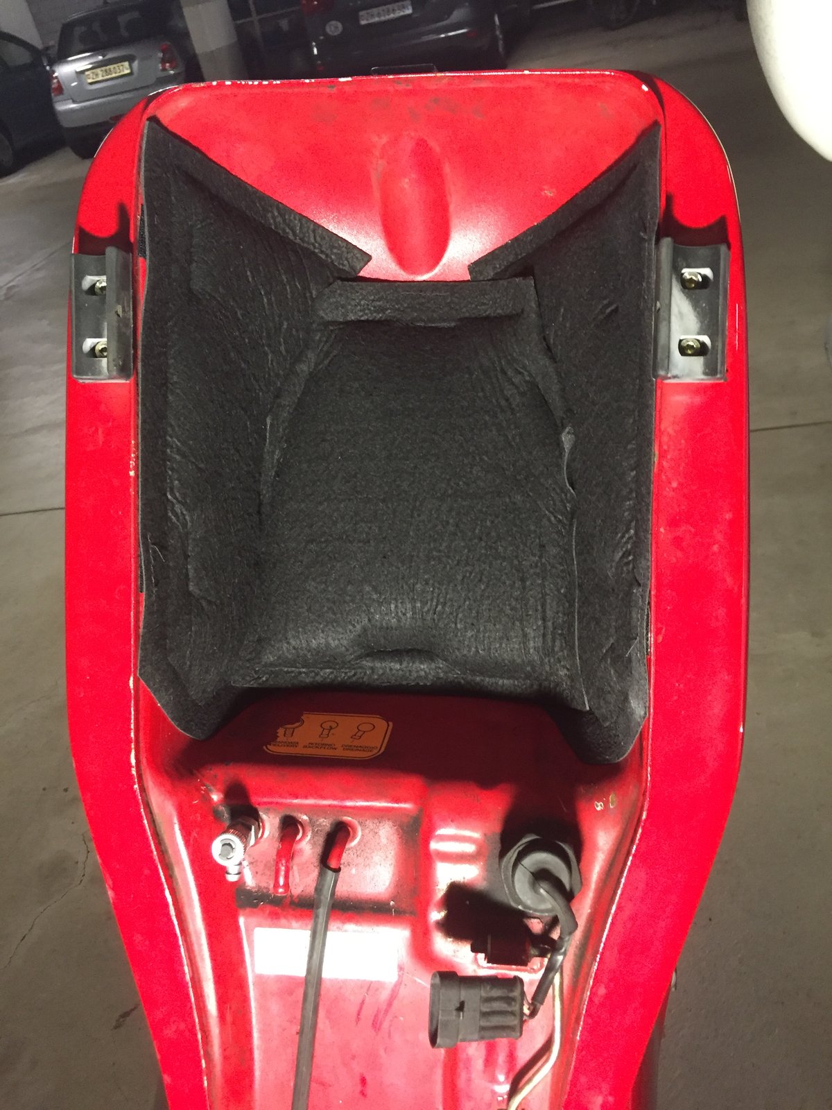

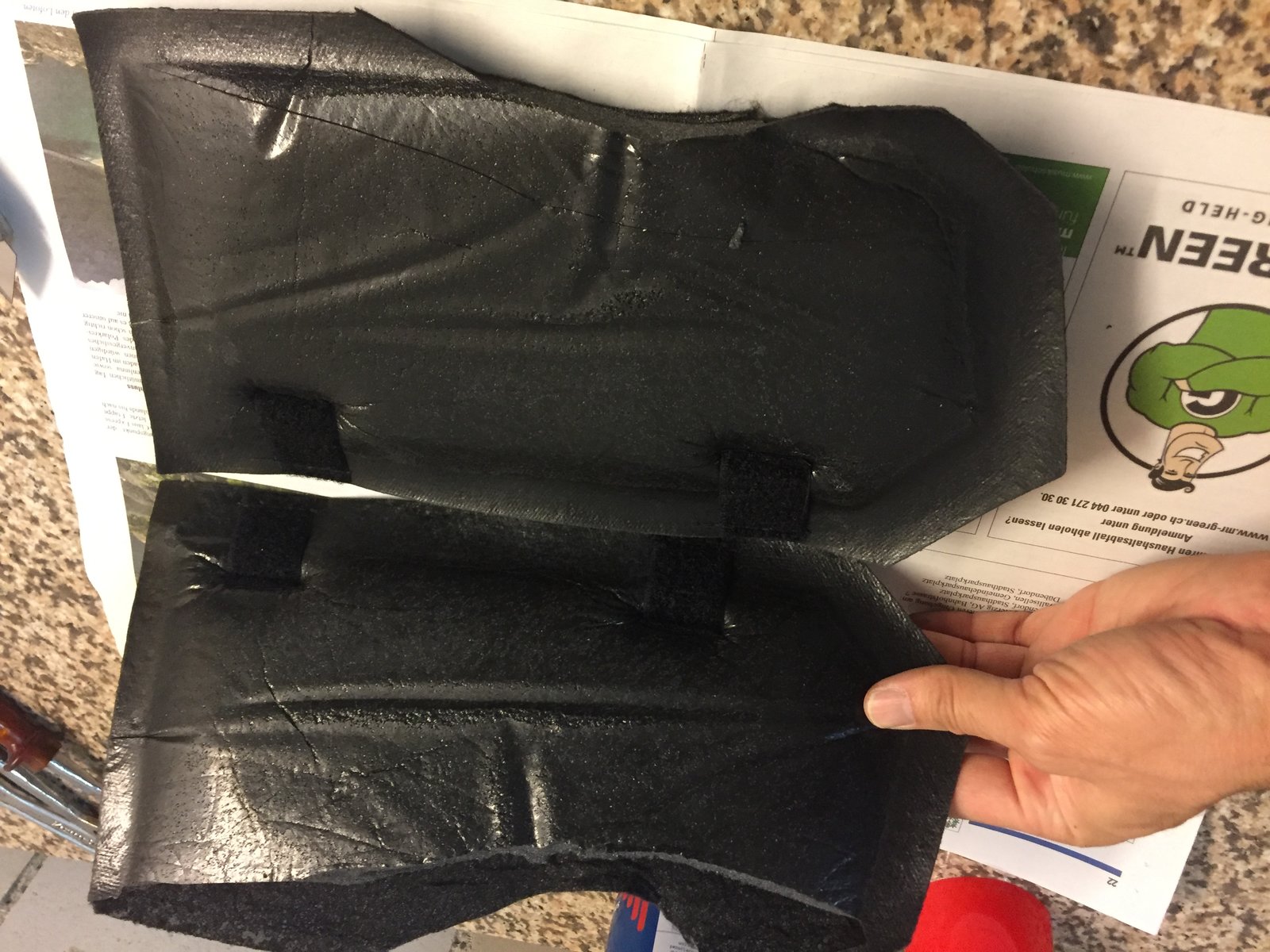

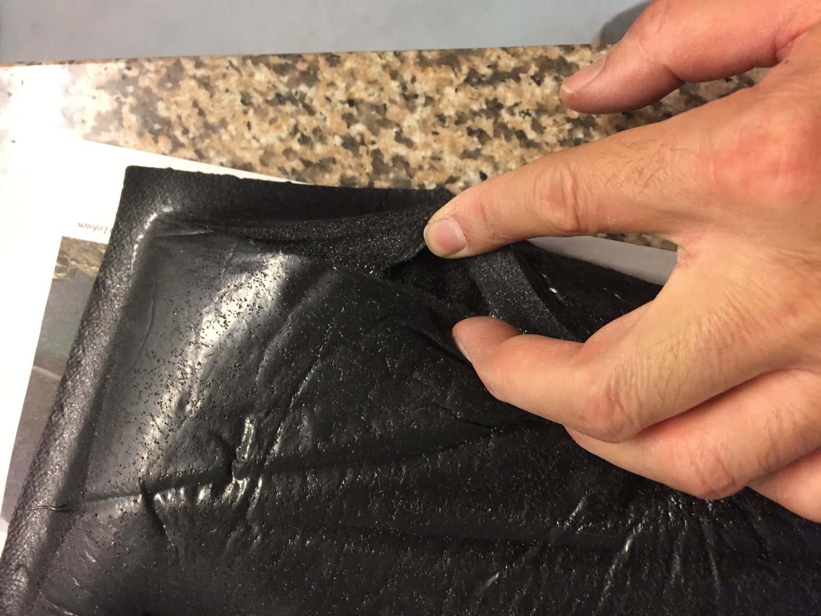

    Bought the pads for a 600 monster and did a little hacking. Sharp stanley knife, spray on contact adhesive, and some patience... The pads fit perfectly. I have attached some pictures if anyone, for any crazy reason, wants to put pads back onto their tank.
    Note that the internal foam of the pad can be gently teased off the cloth backing and cut away. You see this in some pics. This allows you to take the excess material and fold it over, closing the cut foam section and glued shut with contact adhesive.
    No idea if anyone finds this useful.. but maybe.

  8. I recon that stuff would achieve the result just fine. But Swiss mot is super strict about tuv marked correct parts. Didn't want to take any chance.

  13. So.... Bike passed and now fully legal in Swiss :)
    Sound pads accepted.. Brake pedal hammered straight again... New chain and sprockets. Kmh clocks. Couple other bits too
