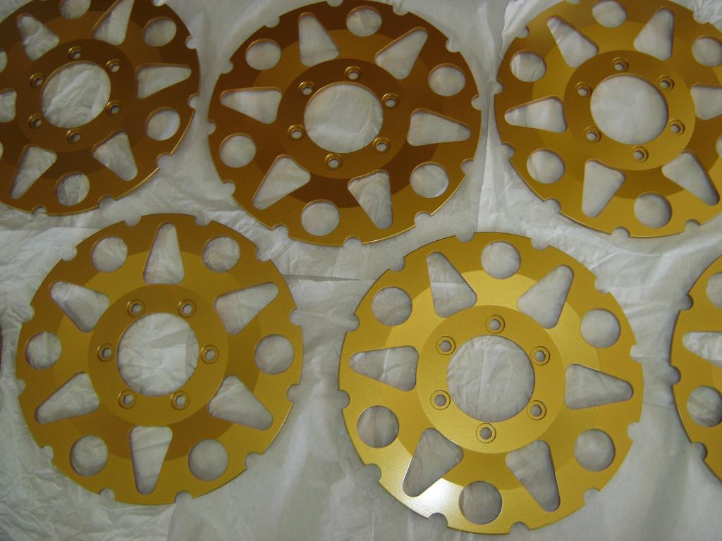

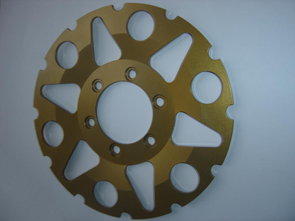

  6. All the rotors from my first batch have now been hard anodised and this is a picture of the first disc that has also gone through the second stage colouring process. The colour is not a perfect match but then again their doesn't seem to have been perfect consistency in the original carriers. I have two sets of originals here that are distinctly different gold colours.
    If we had tried to gold anodise the 7075-T6 alloy that we used for these discs we would have got a different gold colour from the original gold anodising on the softer 6000 series alloy because the type of alloy used effects the colouring. In addition it is impossible to hard anodise in gold. (You can only achieve much darker colours).
    I was determined to use a much harder and stronger alloy than the original soft alloy AND to hard anodise them to give these a diamond hard finish that would have a much longer wear life than the originals.
    Subsequent to the hard anodising we are using a proprietary colouring process on these that allows us to hard anodise them and achieve a reasonably close match to the original gold colour. I am thrilled with how this process has turned out. The final gold finish is very tough and chemically resistive We did some scratch testing on the finaly gold finish today and I can report it is toughter than the gold finsh on the original sets we used for comaparison ....and of course underneath our is also the hard anodising and the 70575-T6 Ergal. It's belts and braces and braces...should last for years! Photo 27-06-13 4 07 53 PM.jpg

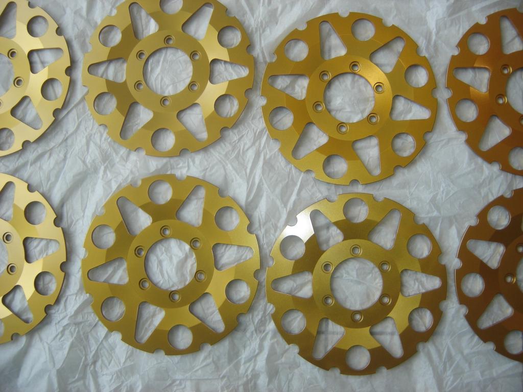

  10. Just got the rest of the carriers back from the second stage of the hard anodizing/coloring process. We tweaked the process slightly from the sample shown in my previous post above and we now have an excellent colour match with the originals (except our ones are hard anodized as well).
    They are all ready to ship out the door.
    I have already mounted up my old cast iton rotors on to one of the sets of carriers for my own bike. I Couldn't be happier with the finished product.

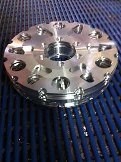

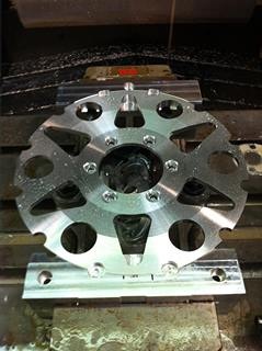

    At some stage with any project like this you have to decide whether to take the plunge and financial risk, as the brits say you have to either piss or get off the pot. Once you make the commitment to proceed, the development work starts. With modern design and manufacturing tools a low volume project is lot more simple and cost effective on a small scale than it used to be. First you do your feasibility and materials research. The you create the item in solids works and send it to 3D printer to give you a physical item that you can bolt into place and check your fit and tolerances, ect, Then you machine one out of soft cheap alloy to validate your CNC files/ tooling/mounting jigs. Then you machine a sample out of the material you are going to use for production. (In our case at this stage we discovered real issues that took some experimentation and many attempts to resolve). Having done this you do a small production run. Next you use some samples from the same parent billet stock to test and tune your anodising /colour match. Different batches of stock and even the same batches of stock on different days if all environmental conditions arn't perfectly controlled will vary the colour matching.

  18. I just picked up our last batch of these carriers from the anodisers today.
    They look fantastic! See pic below.
    If you want a set EMAIL me your delivery address I can quote your for a price including delivery.
