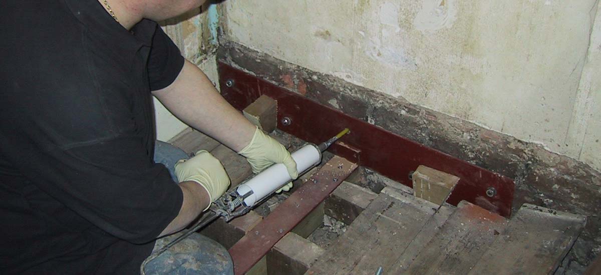

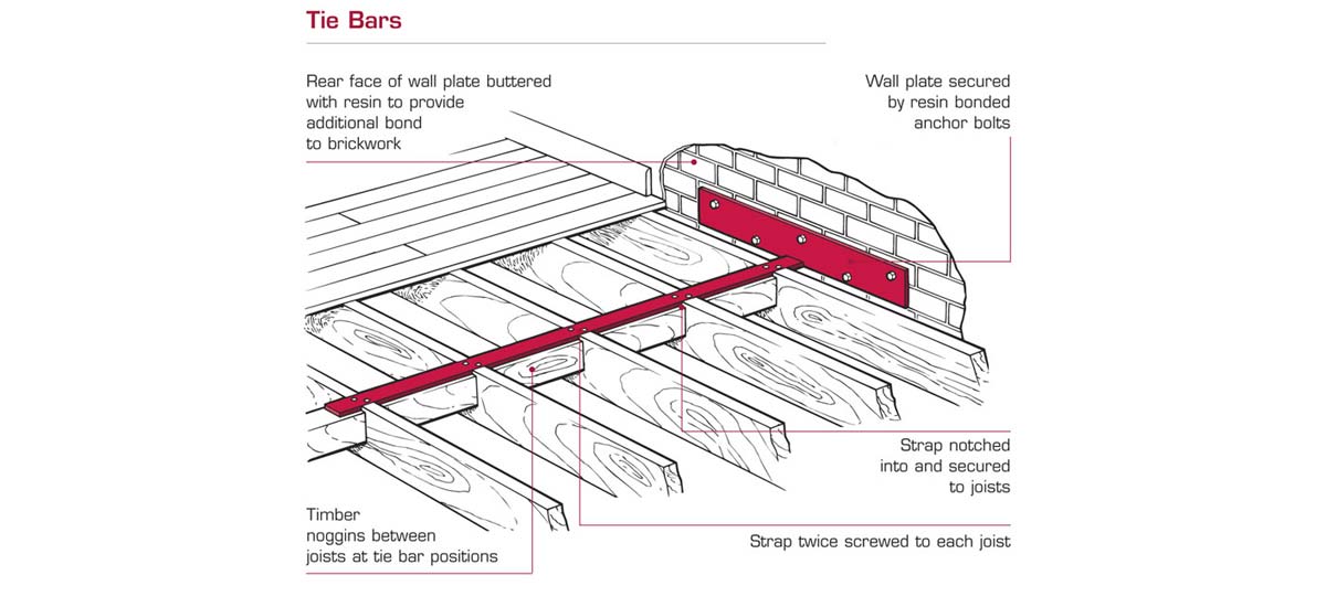

Resin/chemical Anchors For Masonry
Discussion in 'Lounge' started by Martin D, Jun 15, 2018.
  1. .
    #1 Martin D, Jun 15, 2018
  2. It's easy just follow the instructions or check their web site out,i fixed a staircase string back to a flint wall last year with these fixings.............brilliant:upyeah:
  3. This ... it is amazing stuff, sets like iron. Bigger hole, brim it, then ‘screw’ in the threaded bar, wipe off the excess.
  4. Yes that's correct on the rod size,but are the sizes not noted on the tube?
  5. and don't forget blow out the brick dust!!!!
  6. Yes!! This too ... :upyeah:
  7. I've looked on the silly net and oversize the holes by 4mm....but do your own checks!
  8. I wouldnt worry to much about being exact, I have fitted some parking posts before with this as a last ditch attempt as ot was bad ground and the client had already purchased the posts that you bolt down and they fold flat. A lorry backed into one of them once, it snapped the post at the base across the bottom and the bolts were still rock solid!
  9. Yes it is thick
  10. I've looked on the silly net and oversize the holes by 4mm....but do your own checks!
    If you ride a motorcycle you will have the strength in your wrist:upyeah:
  11. Don't overfill the hole with resin, the excess will come out and cover the threads which wont allow you to tighten the nut after it has set, if it does cover the threads make sure you clean them before it sets. AS mentioned blow all the dust out of the hole first.
    Resin fix has it's uses but is being used less and less nowadays as Thunder bolts (self tapping bolts) are quicker stronger and easier to use.
    https://www.toolstation.com/shop/p1...MIi4HklKDV2wIVhfdRCh24-wv3EAQYAiABEgKtl_D_BwE
    Steve
  12. Make sure you have all your holes ready to pump the resin into in one go as the resin mixes as it goes through the nozzle and sets rather quick, which means you will have to have a few extra nozzles available.
    Steve
  13. Its not that hard to squeeze through, just get a good gun and you will be fine :upyeah: it is quite thick but I think it is just the resistance of it going through the ‘mixer’ nozzle that makes it tough.
  14. All the resins I've used have thinned with heat but also go off faster.
  15. Good luck.
  16. You need to make sure theres no dust left in the hole after drilling hilti supply a special pump to do this but we used a compressior
  17. A bicycle pump with the flexible end will do the job, push the flex into the hole and pump.
    Steve
  18. Martain...judging your performance on this forum you don't need any extra help on the dust as you have a set of healthy Lungs:D
    tongue in cheek my friend:):)
  19. We tend to use stainless and cut it to length.
    Steve
