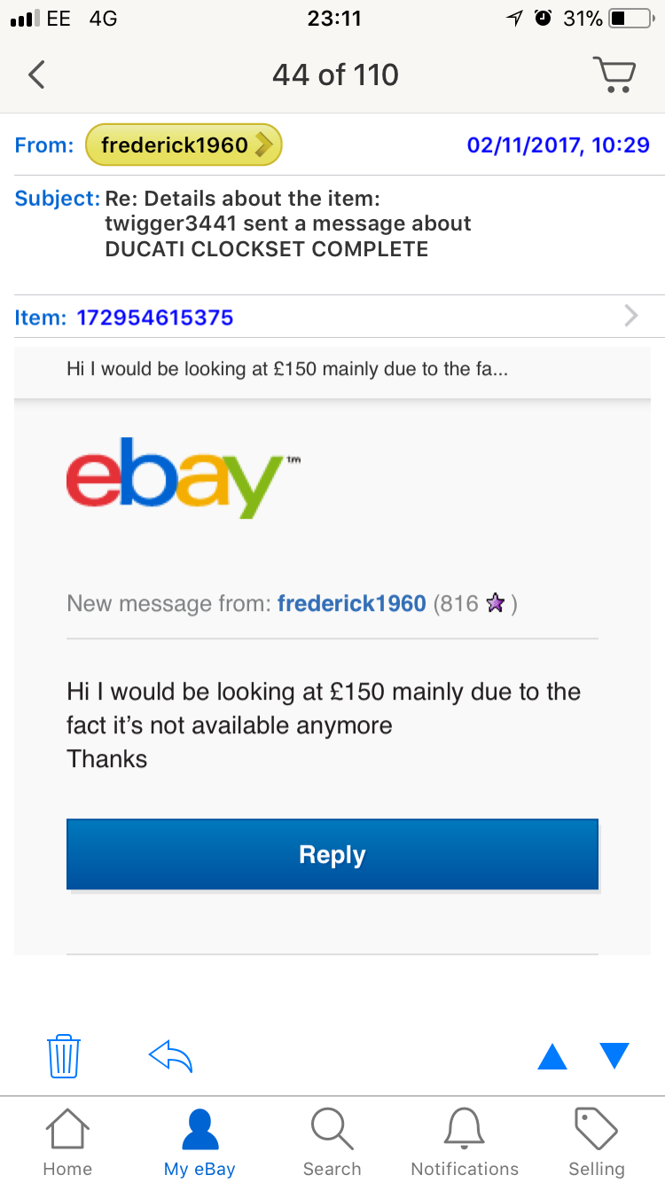

  2. im pretty sure that 1 of the 2 pick ups on the crank case runs the rev counter, check you connectors there, iv got a 996 with P8 and jumped it numerous times, cant imagine it causing a problem, ideally find sum body who's willing to let you try theres, theres a chap on ebay got a NOS for P8 £150 bargain
  3. Can u send me link to this on ebay? I cant seem to find this. Thanks
  4. Hi,, sorry there is no link,, I spoke to him about some thing else and he mentioned he had a NOS at £150 and also a cracked screen 1,, iv uploaded the message for you
