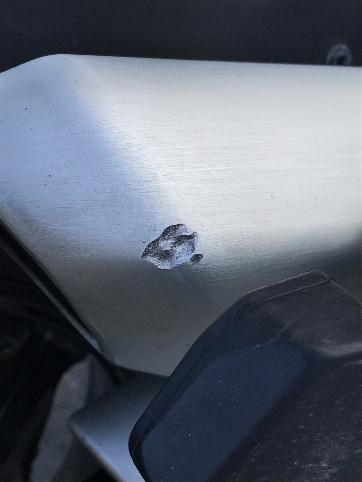

  1. Just back from a week away. On removing RH pannier noticed it has damaged the end can. The pannier was not overweight. Anyone had similar experience?
  2. Mate, something not right there, Just mounted mine and the gap between the can and the heat guard is substantial, so guessing you have something bent somewhere?
  3. I have the same set of dents on my can. I'm pretty sure I did it when I mounted the pannier for the first time and was unfamiliar with the process......Doing!

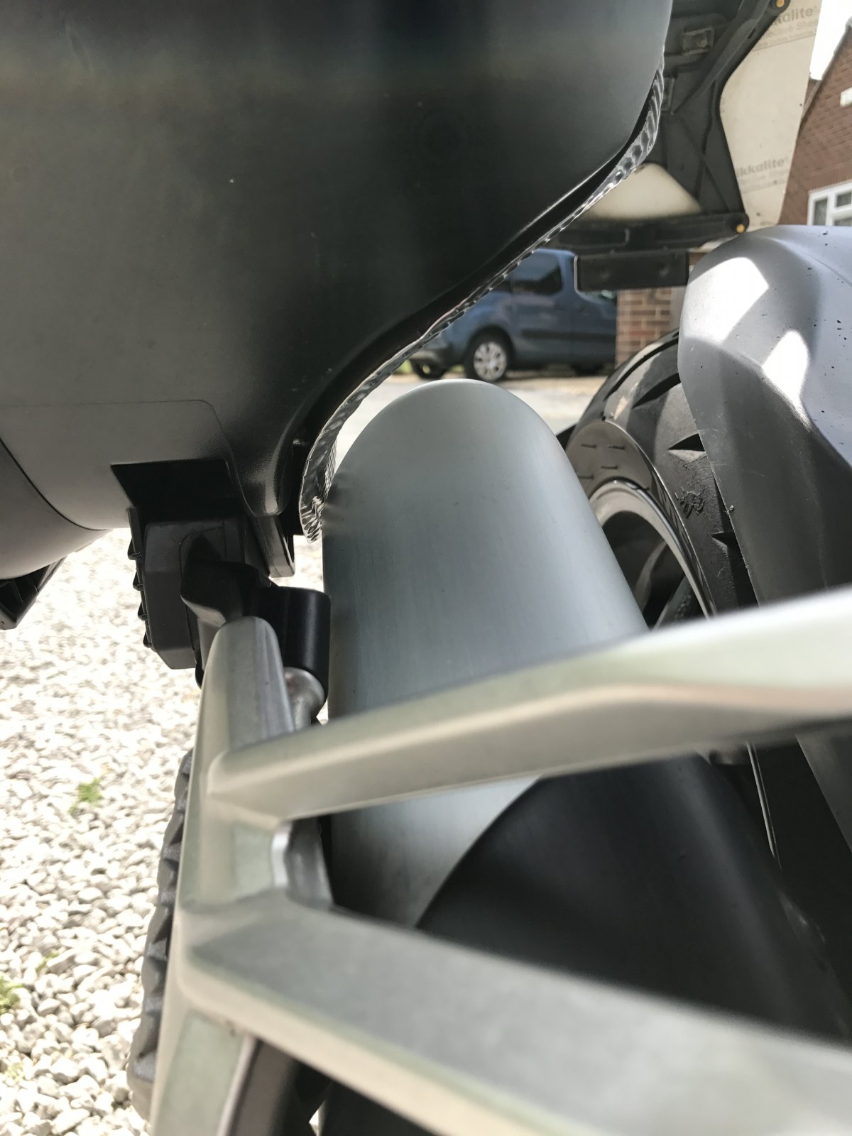

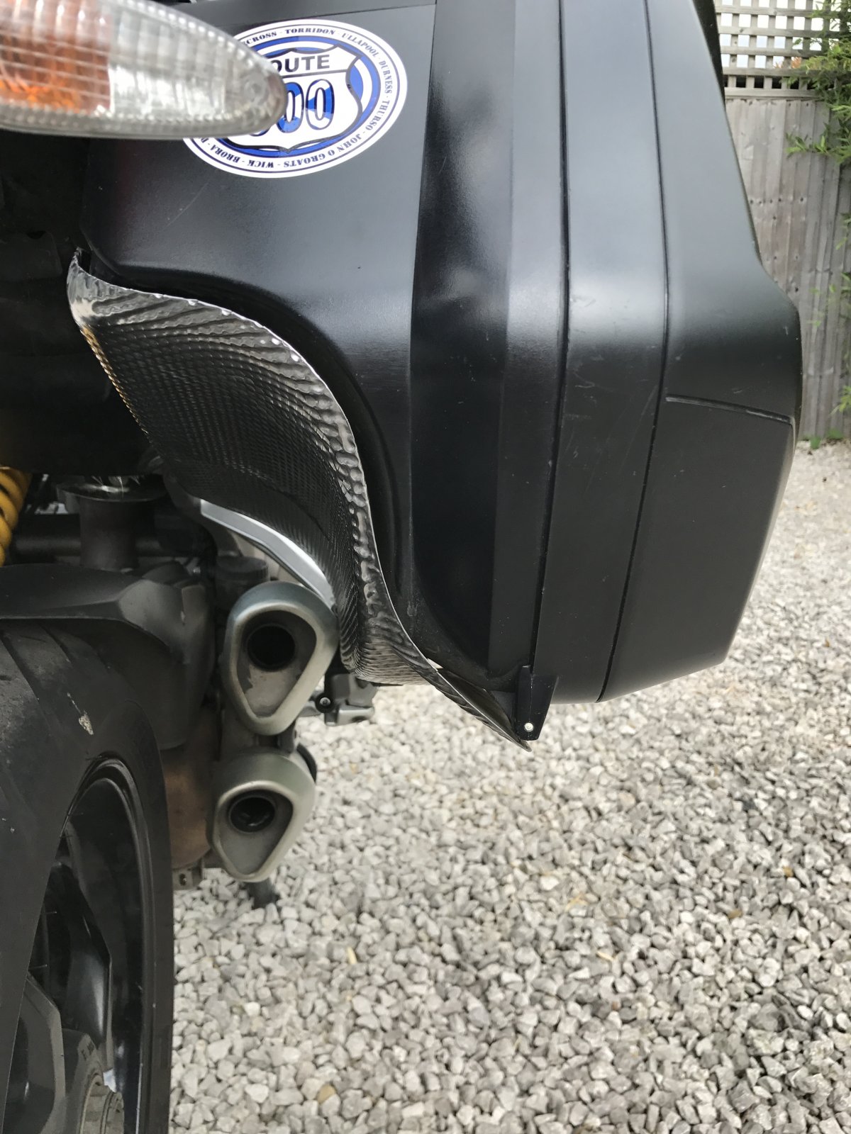

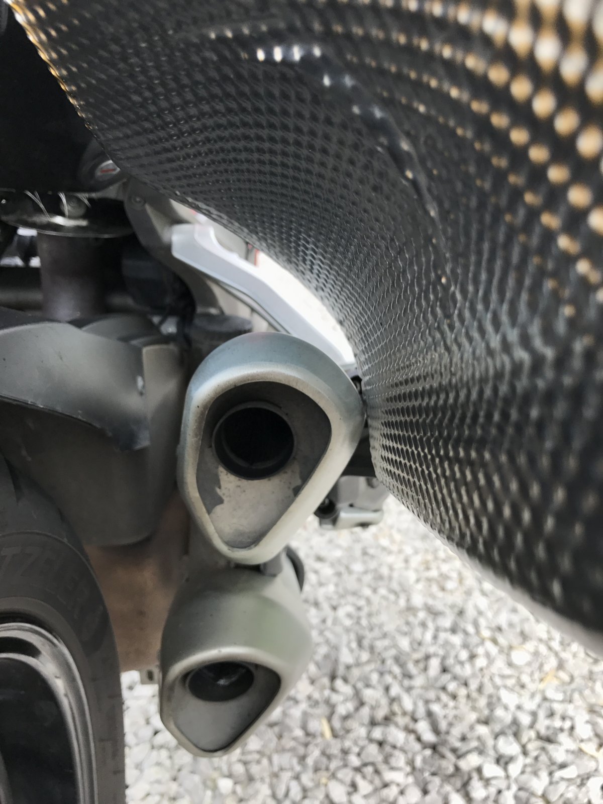

  4. Thanks gents. I'm guessing this is too close.
  5. looks to me like your end can is slightly on the cock, undo the Allen bolt underneath and rotate slightly anti clockwise ?
  6. I'll have a look. Cheers.

  9. Makes sense. Dealer replaced the exhaust recently under warranty (the sticking valve issue). I'm guessing the end can hasn't gone back on as it should. Don't worry about photos but very decent of you to offer.

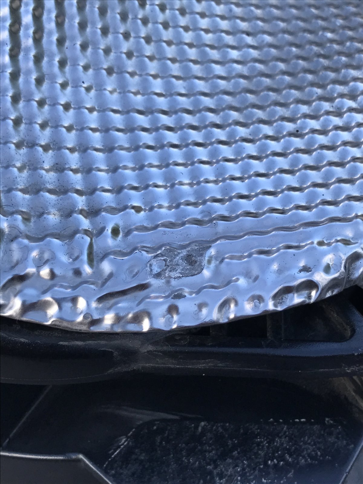

  12. Same thing happened to me after dealer had to remove the can for a maintenance issue and replaced it not fully vertical. Can was replaced under warranty.

  17. Has your bike been into a dealer at all (service etc) as there was a bulletin to re-position the silencer cover- moving it round -best check with them
