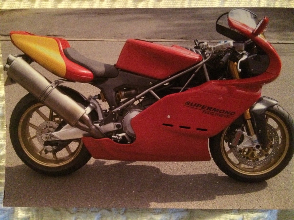

  4. Without a doubt it was an improvement, for me it was back related. Lovely bike in your Avatar!
    Good to hear Chris....I anticipate an improvement too! Yes , its a lovely Desmo single which is nurtured periodically by my long time college pal in Northampton who looks after customers bikes and stores them....sometimes for a very long term in secure premises. Many old and new Ducatis, Benellis, MVs etc incl those owned by P Smart and Alan Cathcart etc He is a Ducati Engineer who also produces a bespoke Ducati SuperMono single with parts provided by the factory etc ....he just wishes he had more time to ride the bikes!:confused:
  6. Lovely, what a special bonus to that friendship. :upyeah:
  7. Sure is Chris....we went to the old 'Vic Camp Racing School' together back in the early 70's.....quiet an experience! We both did very well on the Ducati 350 Mk 3 ? singles shod with TT100s....riding on rails on the grippy surface was a revelation! Wore my Lewis Leather boots toes out !......but it was my friend who was invited back for an end of term race-off.....he did well.....worked for Mick Hemmings Triumph and went on to race for Andy Barrs in Corby on a Suzi GS 1000 in that Avon Roadrunner series way back then his own Seeley Norton. Spannered for many well known racers and did a lot in the USA....worked for Yamaha developing race kit and progressed to building Ducatis on his own account.....quiet a struggle! He is also designing an engine of his own and parts for the Scrambler....he's a hell of a creative type. Lucky to have him as a friend.
