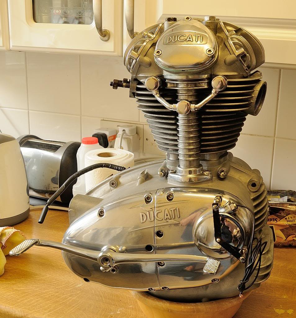

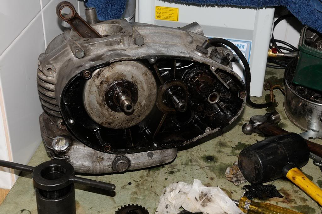

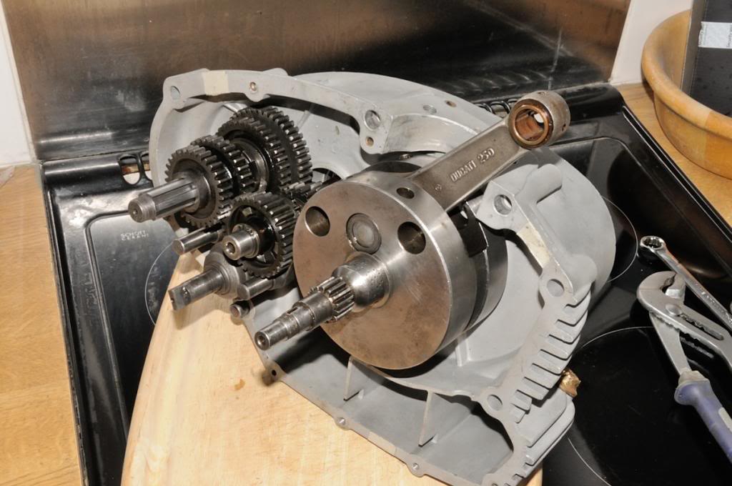

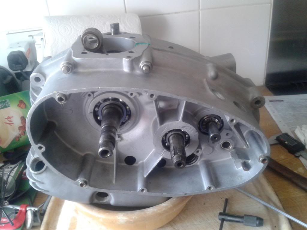

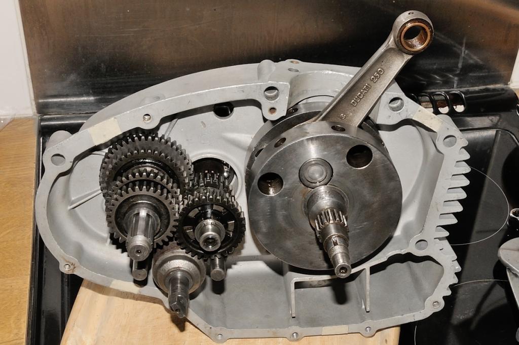

  2. All the bearings are standard, use a good quality like SKF. The ones with an asterix are probably C3 which have a slightly slacker tolerance to allow a bit for alignment.
    i have built a few :)
    2013-05-16111856_zps61ea288e.jpg 9513engine2_zps2ccc4e90.jpg DSC_8012_zps28e67806.jpg DSC_8226_zpsbc21b7d1.jpg DSC_8227_zpse0e55992.jpg
