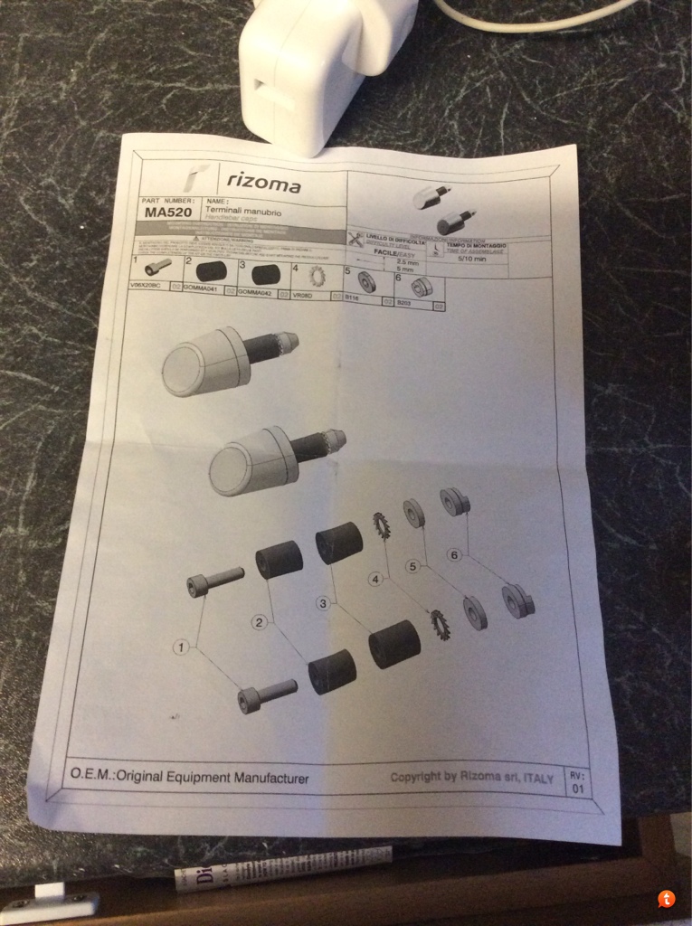

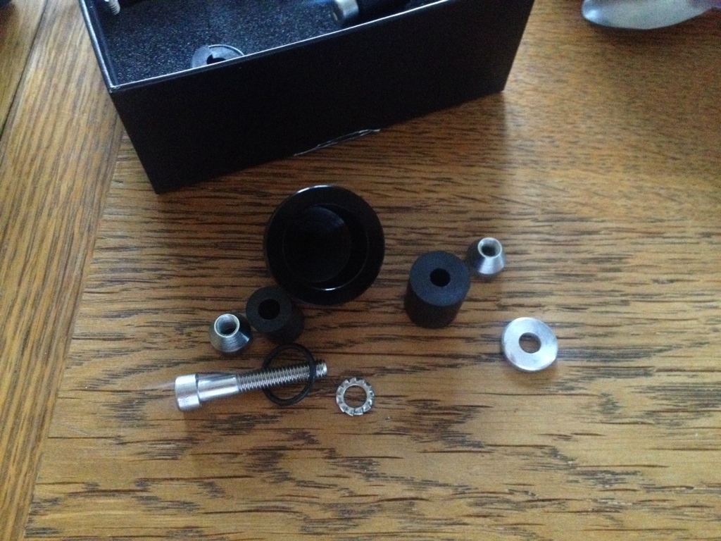

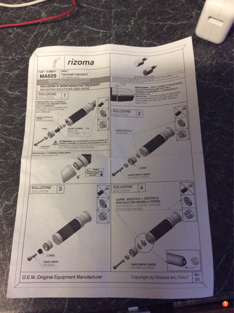

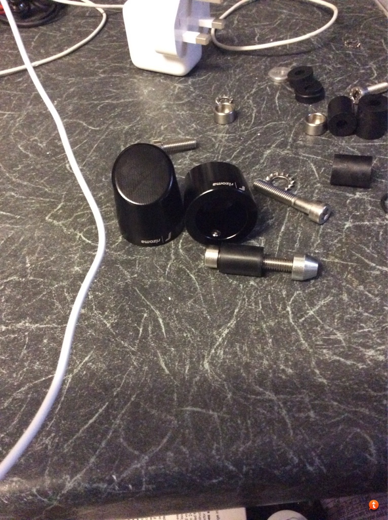

  4. Hope these pics show what I mean better I under stand the bold and rubber spacer goes inside the bike handle then it expands but if you loom at the bar end the hole is quite big and needs to grip on something I just cannot work it out? Come in lads tell me I'm being thick here lo,

  7. Wonder if your missing a piece. From the instructions it would appear that you need that alloy piece with the O Ring, shown in the instructions. You assemble the whole thing into the bar with the alloy piece you haven't shown on the outside of the bar i.e sticking out of the bar.
    The actual barend then slips over the alloy piece with the O Ring (which I imagine would be a tight fit) then is finally secured with the grub screw. Does that make any sense?
    Not saying I'm right but that's what it looks like to me
    John
  8. That's what I was thinking john I have the I ring just not the alloy piece lol
    What I was think was screwing them on the the oem ones as then fit over then glueing the oem in so they cannot be just pulled out?
  9. If it fits then you could, the obvious way is to contact whoever sold you them and tell them the piece is missing. You could also try a good will letter to Rizoma requesting the part, you never know.
    Failing all that an alloy spacer with a groove cut into it would do the job, which you could probably get made by anybody you know locally with a lathe it would be an easy job. You could re-post asking if there is anybody on here, just size it all up. There are folks on here who have done a lot of goodwill stuff for others for nowt or next nowt, all worth a try.
