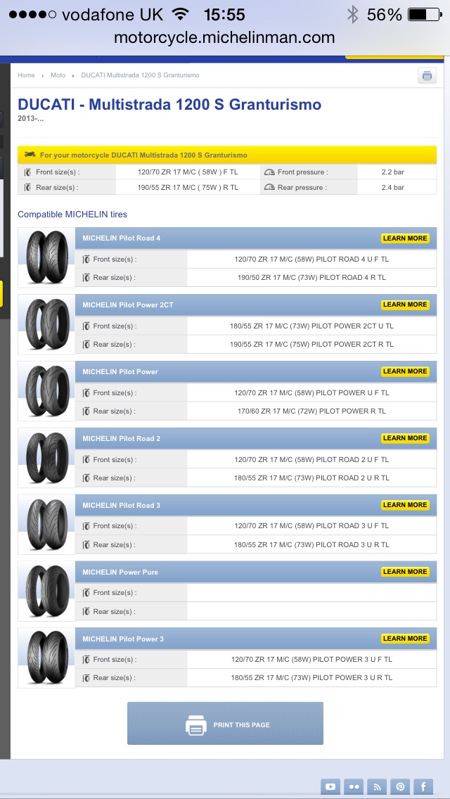

  10. I agree with you, just wanted to make sure I hadn't missed some wisdom shared elsewhere. I can find nothing useful from Michelin. I think I'll drop it down to the pressures in the manual and see how I get on (pretty much what Paul AKA bradders mentioned).

  20. Well....adjusted to 2.2 bar front and 2.4 bar rear (both gauge readings)....perfect.
    I'm no longer falling off a cliff when I approach a bend.
