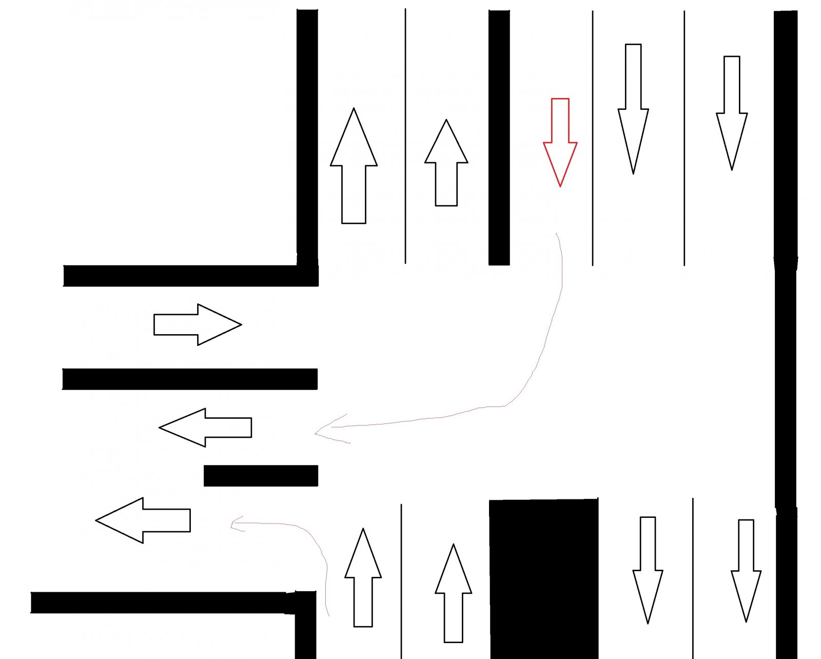

So not here to argue, no did not get stopped but seen someone else did and wondering how it was illegal under which road act. And to those funny people no driving without due care and attention does not apply here just read below and look at graph. As you can see at top the red arrow is lane to turn right only. There are traffic lights there for that lane to turn right and another for lanes that go forward. There is no sign saying no right turn from outside lane or center lane neither there is a sign forward only. There is a waiting area between both sides of the road as it is possible to get stuck in between due to quick lights. So now a biker was coming on center lane, went past all the stationary vehicles (red arrow), went forward on green light then turned to right side lane and stopped in waiting area. The lights for right turn and forward are past the wait box so he did not pass any traffic lights yet. However he was pulled for that stunt and given ticket. So what rule did he brake? He was not speeding and when he moved to right lane he indicated and was going at safe speed with no traffic behind him.

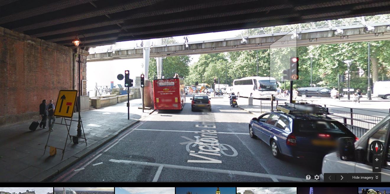

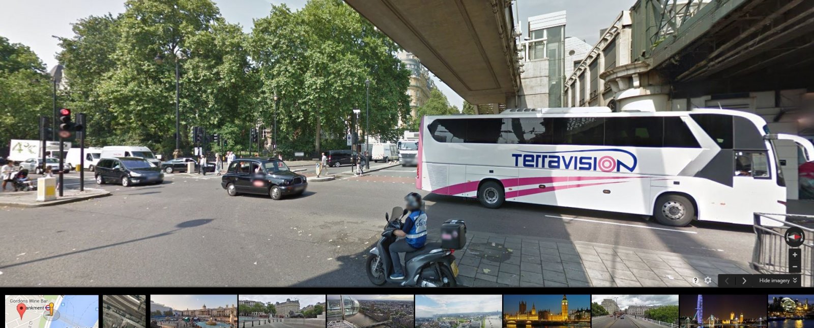

If he was in the area where the blue estate car is, he would have been nicked.....It's for cyclists. If he was past the blue car and before the lights, he would have been nicked. The STOP line is the one where the front of the white van is sitting. The roadworks sign on the left is pretty confusing......it suggests the right lane is closed. It also looks like matey boy on his moped should have been nicked too.
I know this junction very well. The green arrow is for traffic going straight on only. If you are not going straight on, the red light applies to you. If the biker went through the red light even though he was not going straight on (because he was turning right), then he was committing an offence. And if he did so notwithstanding there was a policeman in a yellow jacket right there, he was not paying much attention. The lane markings are not very consistent from any of the three directions, and can be quite confusing, but the red traffic light is actually pretty clear.
