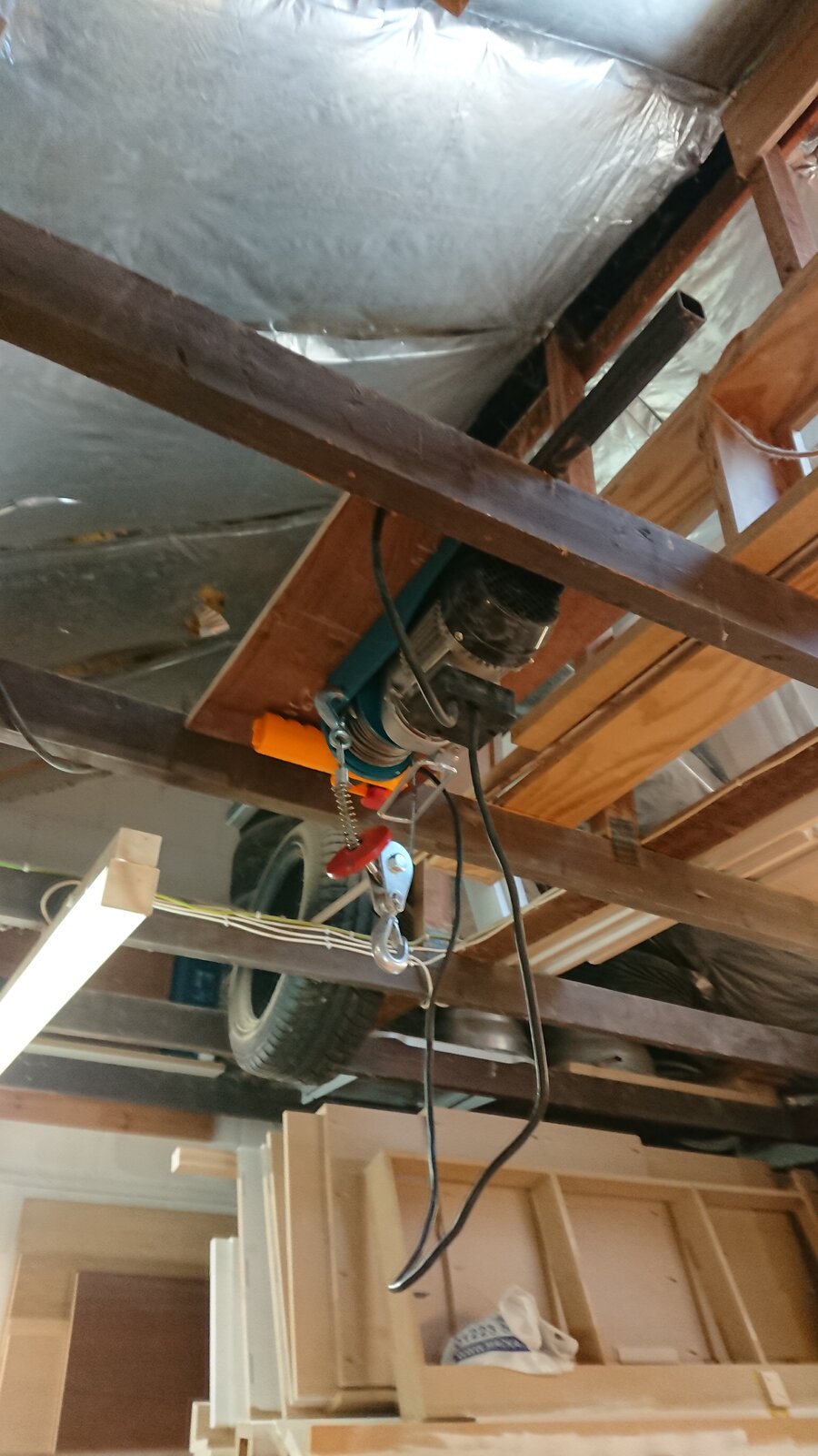

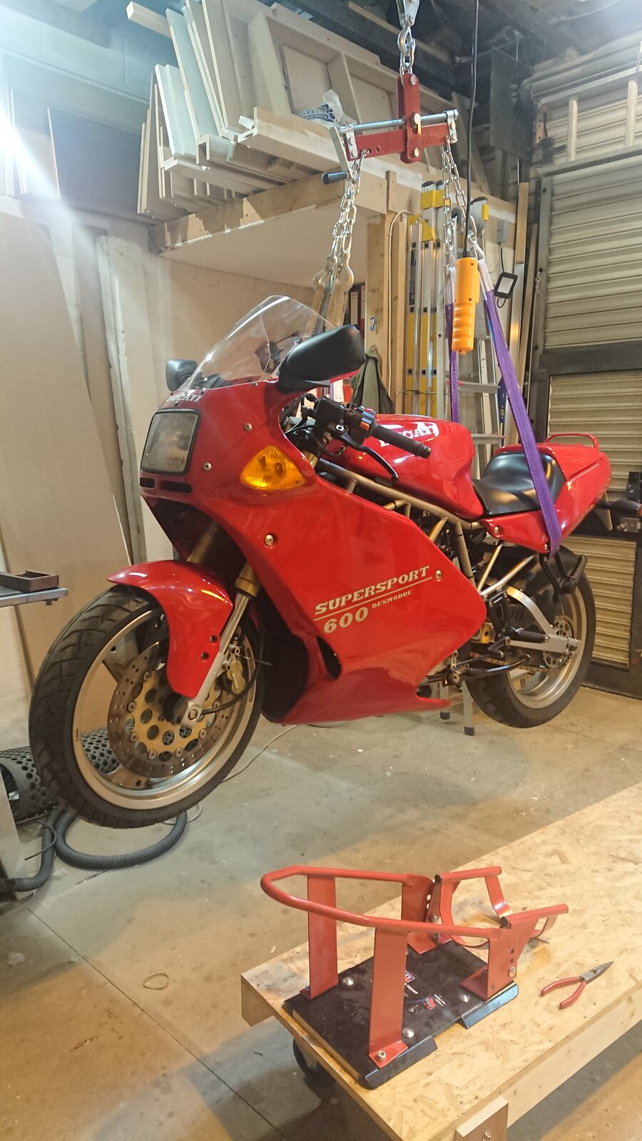

  1. I've made a mobile platform to make working on the bike easier but getting it on and off wasn't easier so I've made this.
    Now I can roll the bike underneath, pass a 1m lifting strap through the headstock and a 2m strap through the rear footpeg mounted and the hoist does the work.

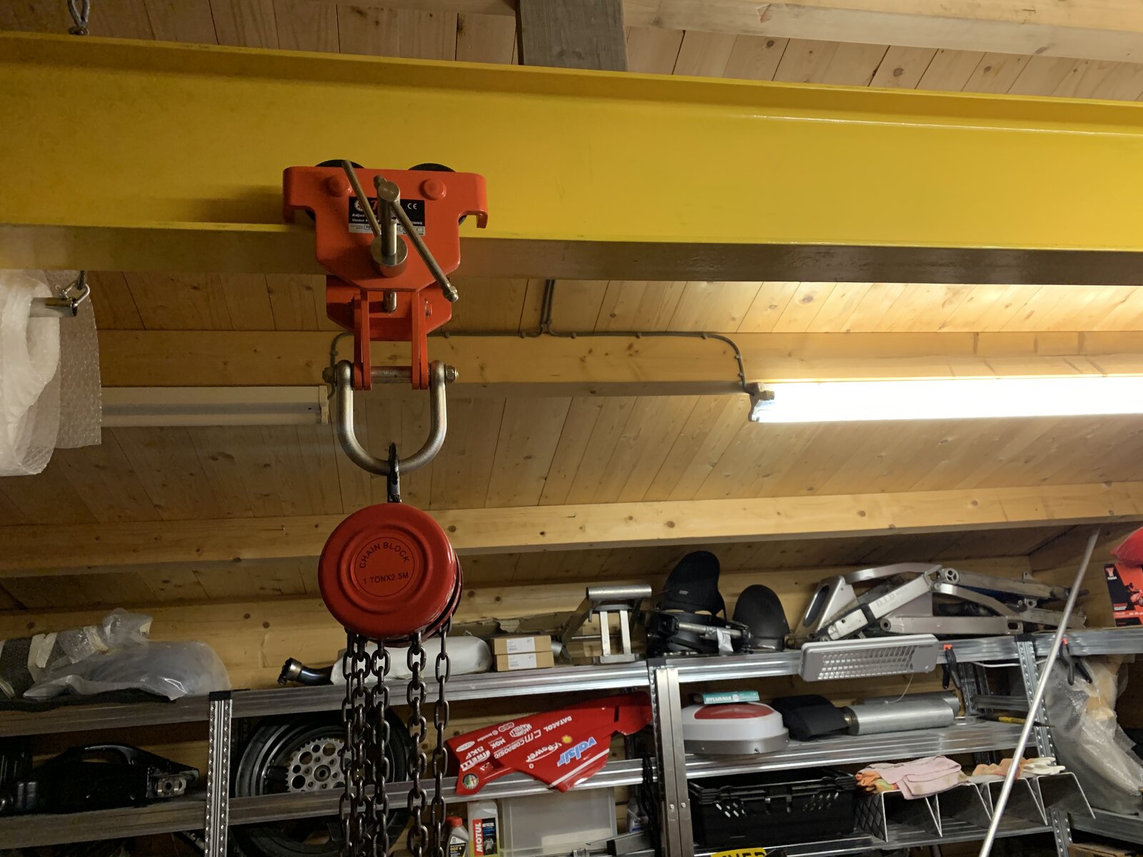

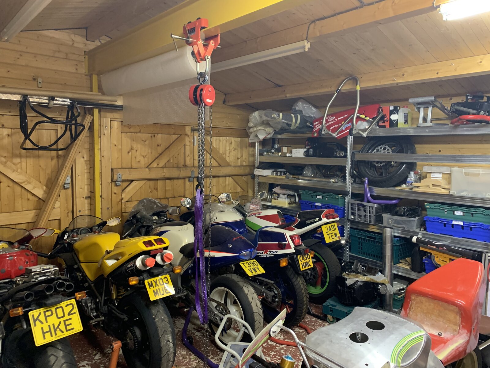

  2. I would extend the metal hanging structure to cover at least 4-beams. Looks well sketchy imho on just two. But the concept is great, I've looked into doing this.
    I-beam with Lifting & Crane GT1 1 Tonne Girder Trolley
  3. I don't have room for a hydraulic ramp, that's why I did this.
  4. Mine cost £90 in total and is very useful - still need to put the bath under it though :thinkingface:
    Free I section from work, Manual 2 Tonne Hoist was £80 NIB off Ebay (second hand but never used) Straps £10...
  5. Good idea, I'll look at the straps today.
