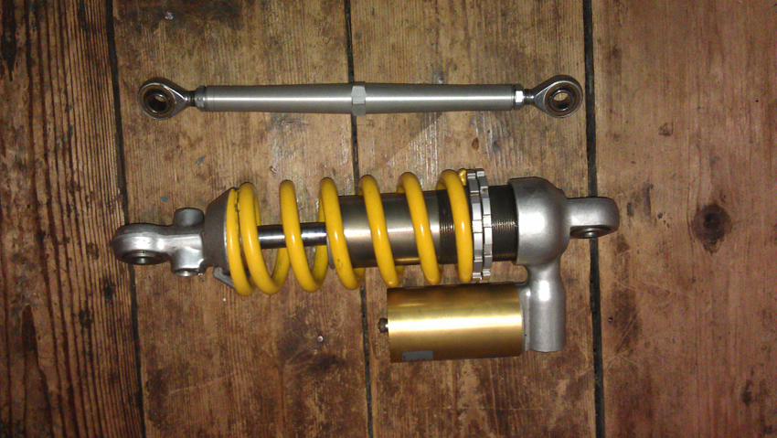

  8. Update....
    I dropped the shock and ride height adjuster out this evening :upyeah: A really easy job with a center stand and something I will think about doing annually if for nothing other than to give it a proper clean :biggrin:
    I went with the Mcgill ultra high performance ends as suggested and included one of the neoprene covers and im hoping that should keep the crap out of it.
    All that delivered for 27 quid so a pretty good saving over the inferior OEM stuff.
    Next the shock and forks are getting rebuilt and im going to drop the suspension rocker arm off over the weekend to give it a good clean and re-grease as theres no point doing a half-arsed job.
