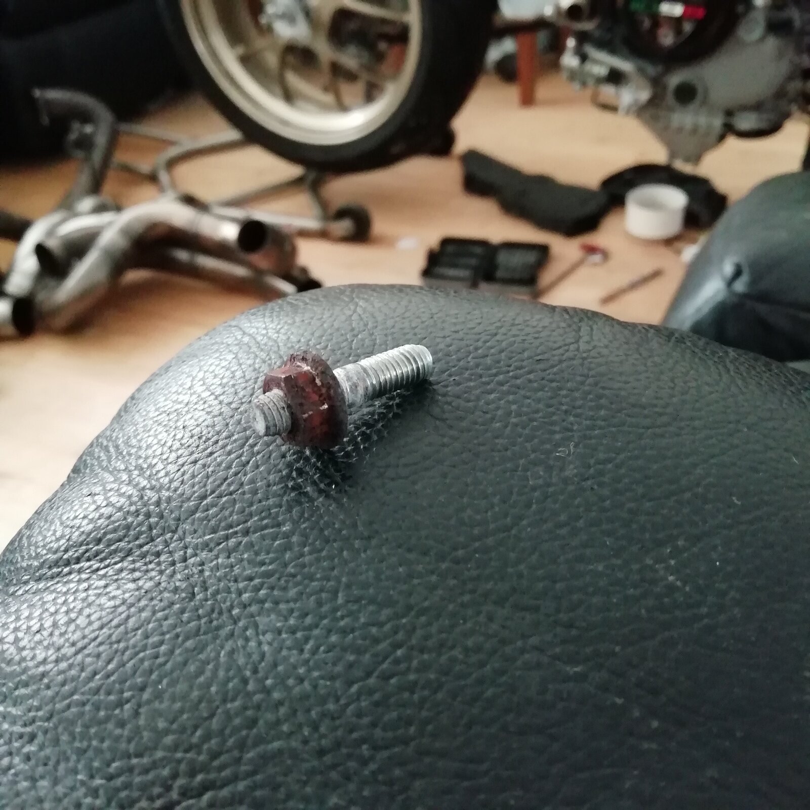

    Yes, here's one that wound itself out of my 1098 when I took the exhaust off the other day.
