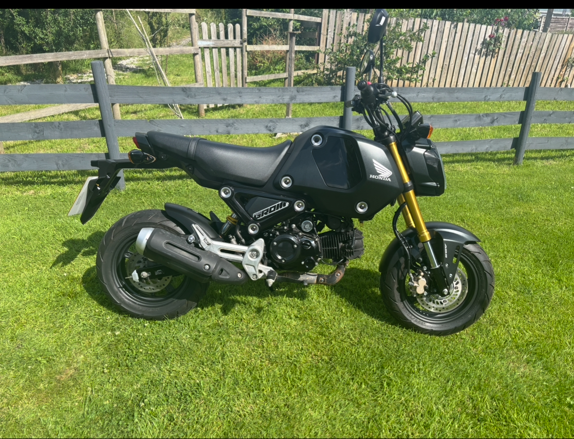

  1. hi guys bought the missus a Honda GROM and its got quite a few bolts with the usual white corrosion, cleans up spot on with the wire wheel however im wondering if anyone knows of anything to protect them afterwards without having to paint them, like something I can brush on or wipe on, at the moment ive just used grease then wiped it off so hoping they have a light coating but want something abit more solid if anyone knows if anything!

  7. IMG_9384.jpeg Cheers for replies guys, I spent the afternoon removing various bolts and cleaning them up then smearing grease on them and wiping them over, she’ll only be riding it on dry days and like all my bikes now it’s in my ownership I’ll mint it up and keep on top of it, probably end up replacing half the bolts but did get the bike cheap from a Honda dealer as they said it was too rusty for them to sell, it’s only 2 years old with 2k miles but previous owner must have used it right through winters and it had literally never been washed since day 1, took me nearly an hour just to get the old chain grease off the back wheel as previous owner was one of those who put grease on old grease on the chain lol
    Will be a good first bike for Mrs until she’s done her direct access eventually and then I’ll probably end up keeping it as spare play bike, it’s actually quite fun to ride and I’ve ordered her a twin underseat exhaust, tail tidy and short indicators, got some bits off for powder coating black and hopefully she’ll be happy with it
