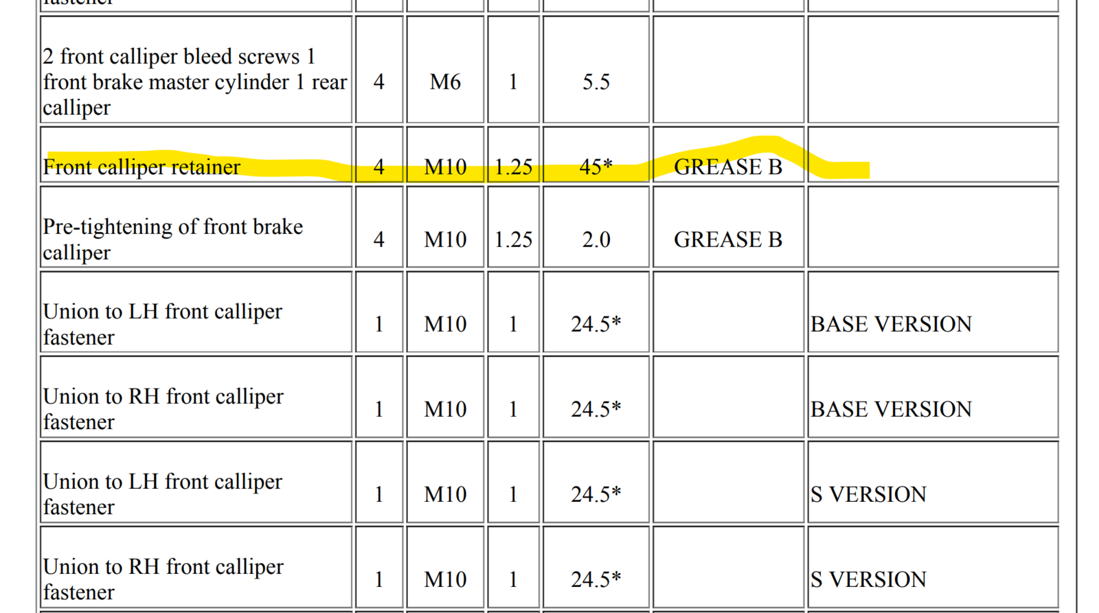

  4. Here's a screen shot of the MTS V4S extracted torque values that I have, I'm guessing it's the same calliper retaining bolts. Certainly the values are the same at 45Nm.

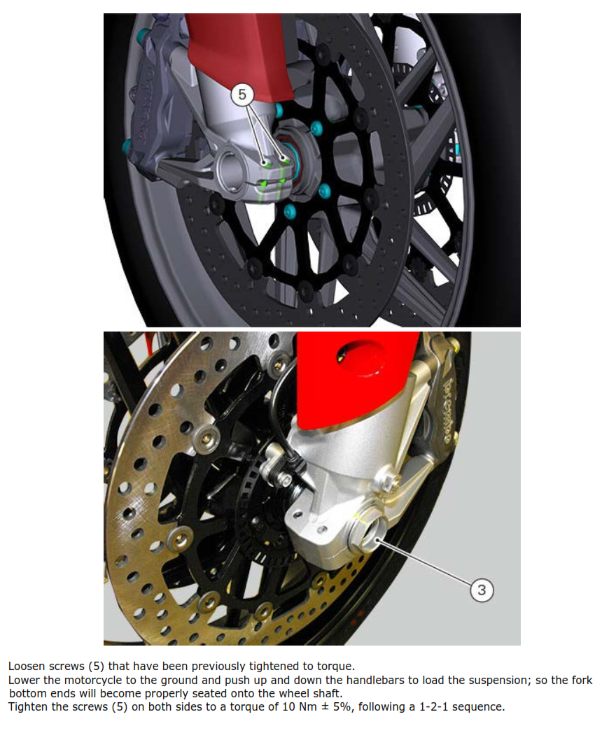

  8. It is definitely worth following the process in the manual when re-fitting the front wheel, see below. I know this because after a tyre change I had a very bad weave at high speed which went away after re-fitting the front wheel.
  9. Thats the way to do it , thanks for posting . Well worth it , did this when racing off road but carried on to road as well , need to read my manual as well lol...
