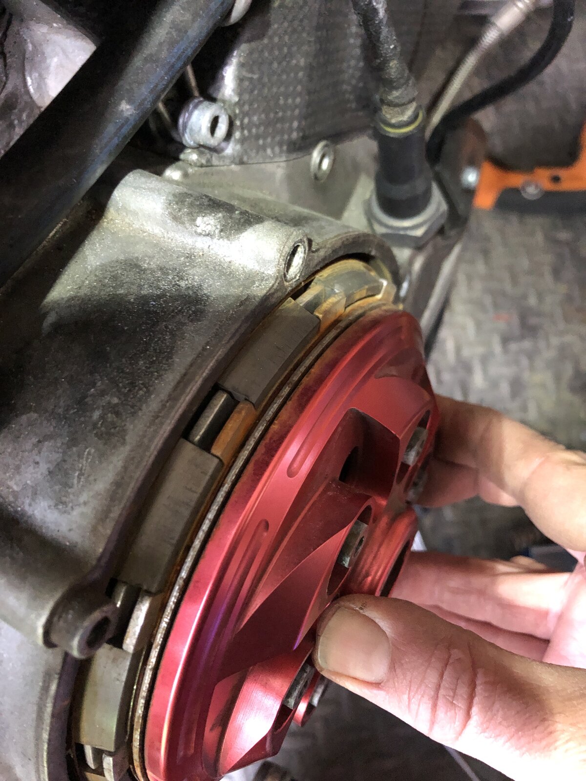

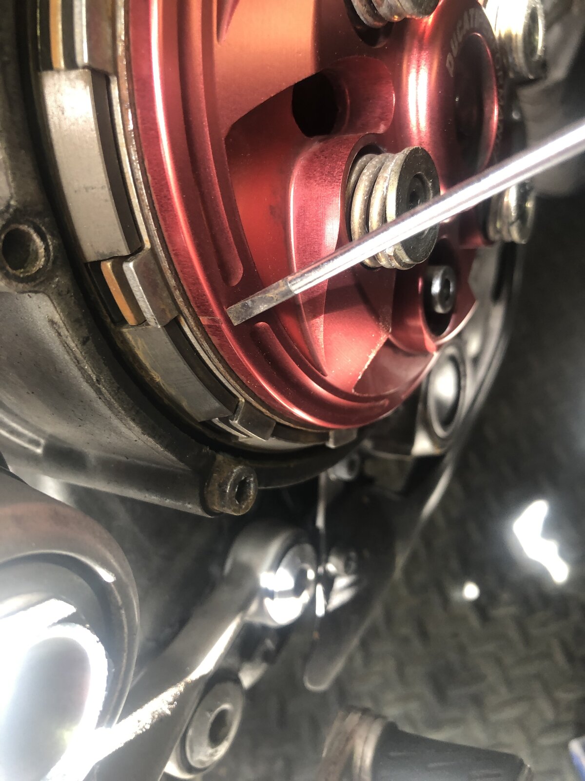

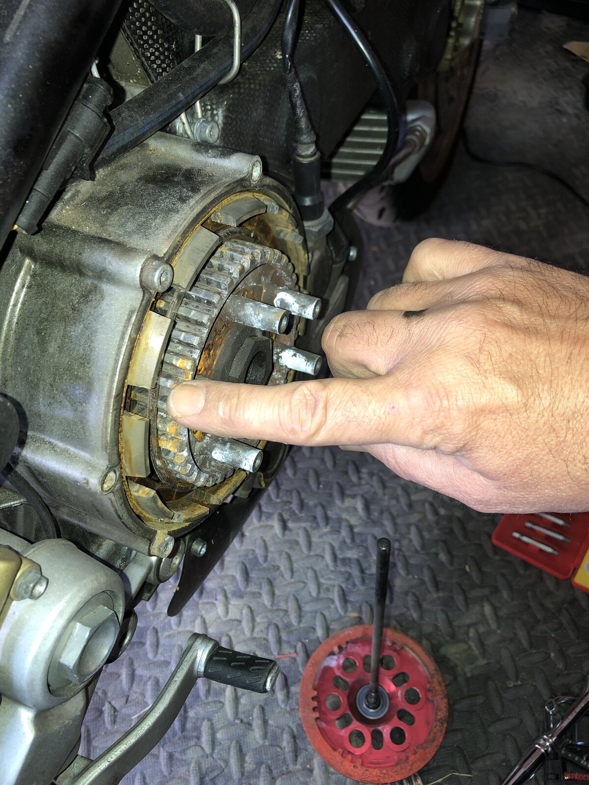

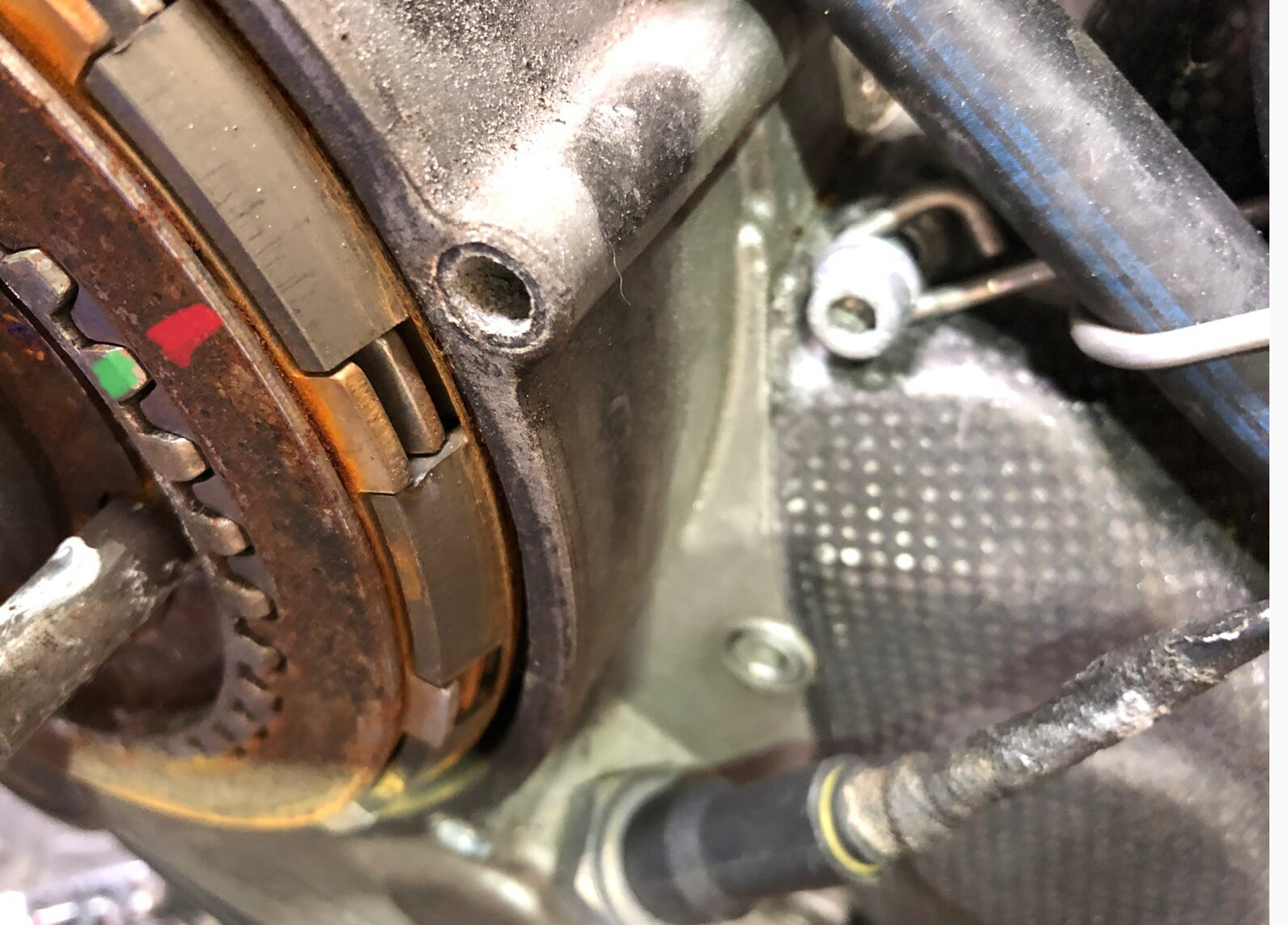

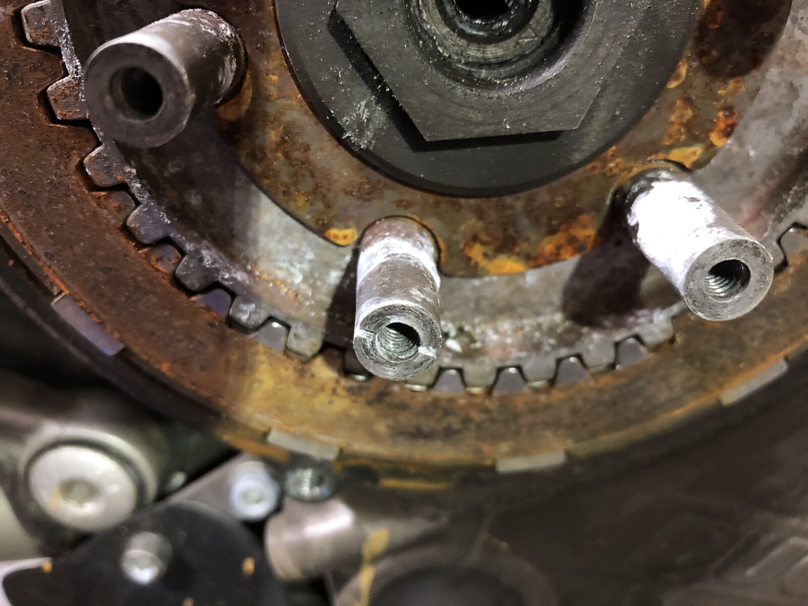

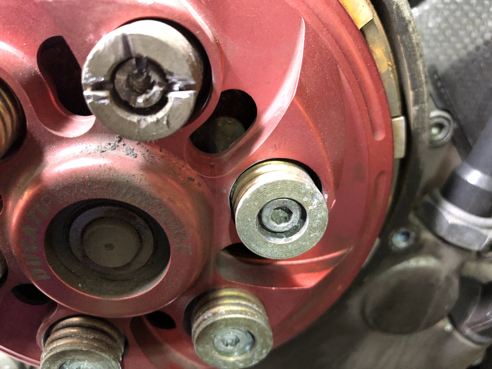

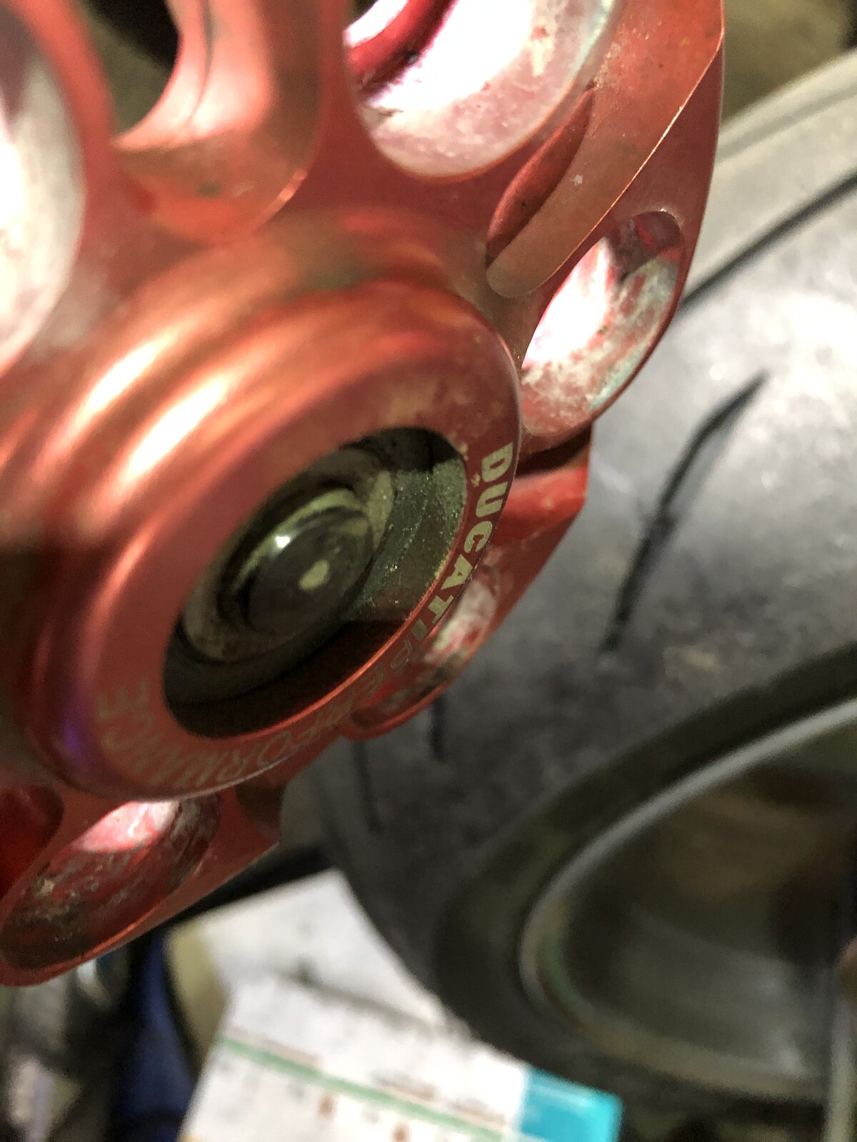

    I’ve managed to get the rounded off fastener out but only by sacrificing a spring post cap in the process. The screw extractors wouldn’t budge it, so I cut a slot in it with my Dremel and used a flat head screwdriver to back it out, but as the head of the fastener was recessed in the “well” of the spring post cap I couldn’t avoid cutting that too. Thankfully I have some spare caps somewhere but I’m sure, as is the case 90% of the time, I won’t be able to find them so I’ll buy some more on eBay and then they’ll turn up once the new ones have arrived.
    Anyway, this is how things appear at the moment.
    32D86BA8-07D7-4202-9223-AE96BC0FF6C6.jpeg 698855B0-1F9A-49D5-97D8-FA868B19B764.jpeg 16DFFDCE-1A4B-49F3-A69B-128817BC53CE.jpeg F41A54B8-471F-458C-A761-1767312418EF.jpeg

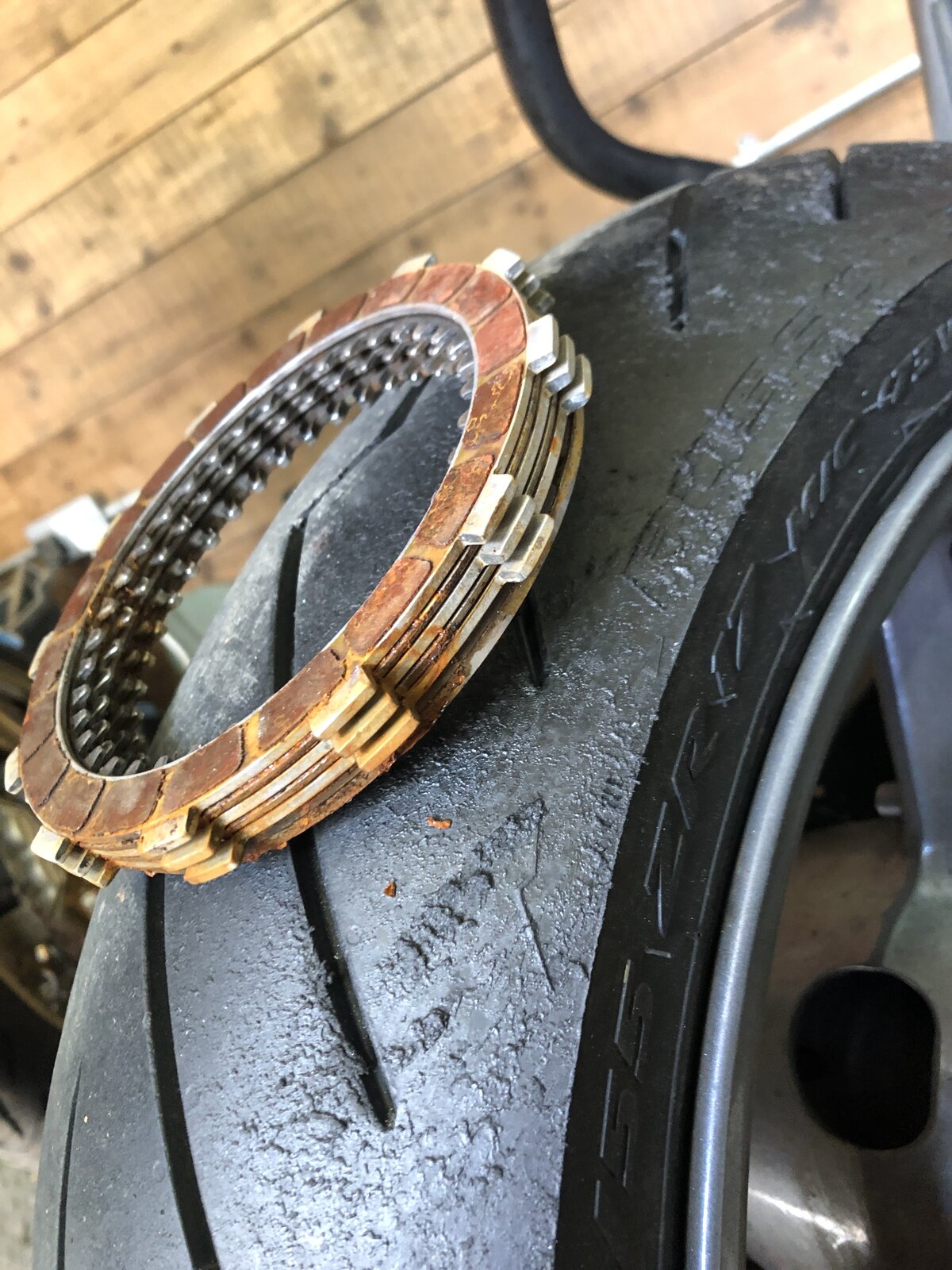

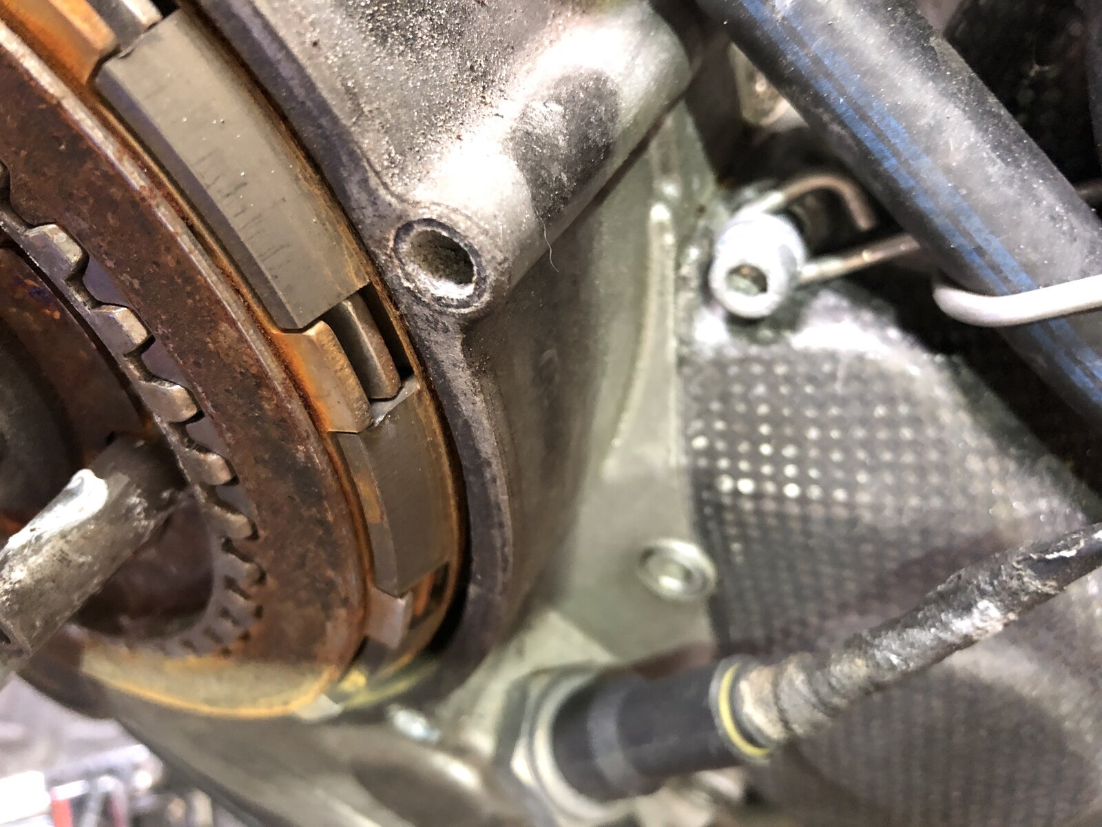

    The clutch pack looks like it’s been at the bottom of the English Channel but all the plates are moving freely and the basket isn’t badly notched.
    The pushrod bearing seems to be seated correctly.
    One thing I did notice when I had it all apart yesterday is that the pack contains additional thin steel rings that fit inside the inner radius of the plates, which I haven’t seen before in other Ducati clutches I’ve dismantled. Unfortunately I forgot to take a photo.
    Right....I only came back in to use the WiFi to post these pics so I’m off out again for a fiddle.
    If those pics raise any obvious issues please post comments/advice. Thanks

    This time I pulled the whole stack out and found that I’d been wrong when I thought that only the top half of the plates were seized. So I freed the remaining plates cleaned everything up and reassembled it (drum roll).........
    The remaining seized plates

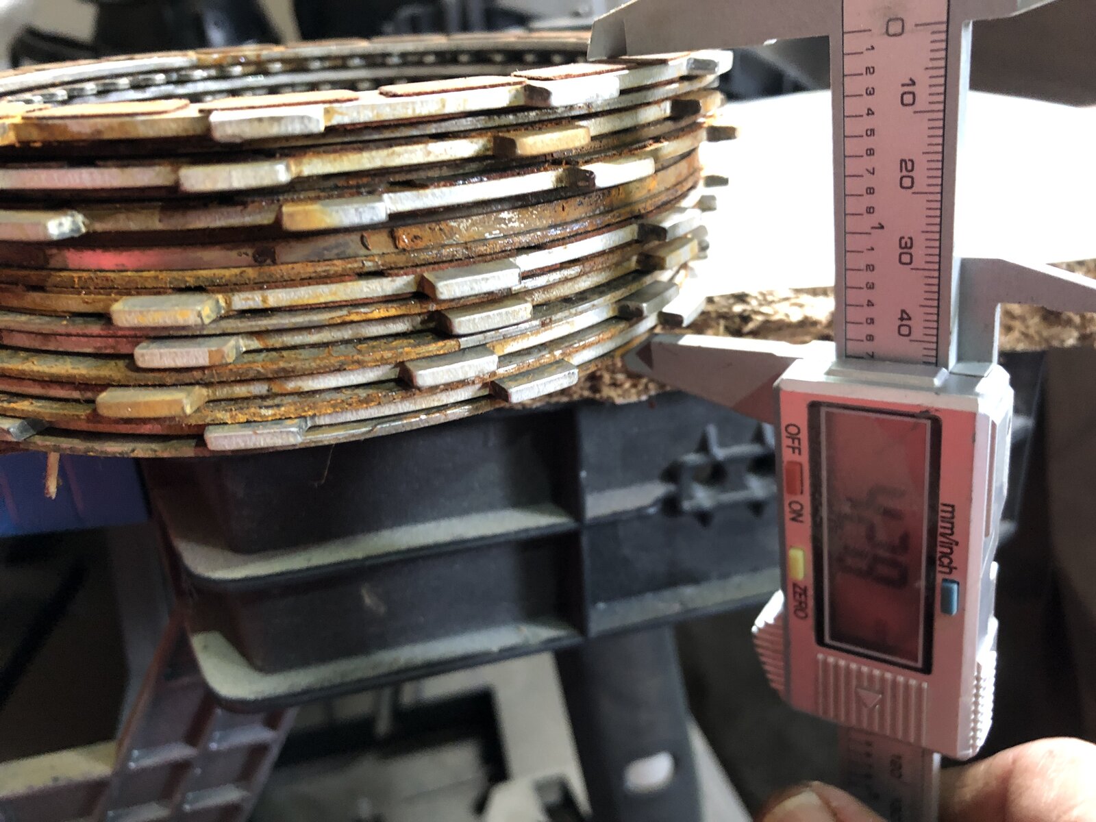

    Stack seems a bit chunky. IIRC, shouldn’t it be 38mm?
    One of the two thin steel rings which sit inside one of the friction plates.
    ........only to find the problem remained :triumph:

    When refitting the PP again after the first disassembly I couldn’t find the usual dot that is on the OE PP and which you need to line up with the slotted post. It’s an aftermarket DP item and so I just assumed that the absence of the dot must mean it doesn’t need to be lined up with any particular post.
    Wrong. Purely by chance when refitting the PP after a further unsuccessful round of experimentation, I found a notch on the outer rim of the PP, lined that up with the slotted post and “presto hey”, it all works again.
    Thanks for the input Chiz, Harry and Jez :upyeah:

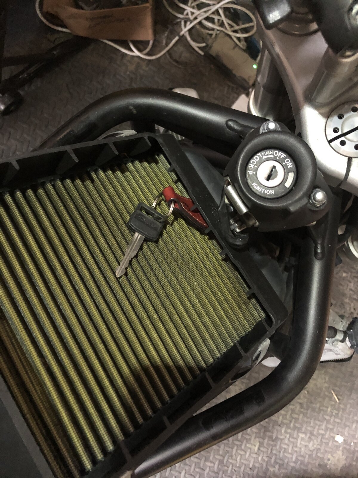

  10. On the subject of finding things.....
    After I sorted the clutch, the b@stard bike wouldn’t start (I eventually traced the problem to the neutral switch wire) but while investigations were ongoing, I lifted the tank and lo and behold, there were the keys to my RS Bandit 12 track bike which had been missing for days :bucktooth:
  11. Crikey the drum and plates look amazingly shit and corroded! Not surprised the assembly was corroded together.
    Time for a non-vented cover?
  12. The outer friction plate looks too near the outer edge of the basket to me chap, that leads me to conclude that your stack height is too high.
    The friction plates in your pic's look like Red Barnett items to me, some Barnett clutches used a plain steel disc with a larger ID, inside this plate were located a pair of smaller discs that are actually dished springs that should be fitted opposing each other.
    If you find yourself stuck I've plenty of steel spring cups going spare, just PM me and they're yours for a drink and the postage.
    Steve R
    • Useful Useful x 2
  13. As @Steve Robins says above, the stack height looks too high.
    The distance between the drum face (green) and the first plate face (red) should be around 5mm.
    • Useful Useful x 2
  14. Looking again at your clutch pack/stack, you have a very thick (Barnett part) steel plate.
    Loose that part 1st to get the pack down to a workable level.
    You should start with a friction plate and then alternate them with the steel/driven plates, ending up with a steel one.
    If the stack ends up too low then you can add an extra steel one.
    In my collection of parts I've a HUGE pile of steel plates in differing thickness', 1mm, 1.5mm, 2mm and convex/dished spring plates to shuffle any clutch pack to get it too a working height.
    I've had a few sets of Barnett plates over the years and some have come with that very thick (3-4mm) plate, I've never found the need to use one yet??
    Steve R
  15. Rusting will thicken your plain plates... Think we need to chip in for a bike cover!
  16. Thanks for the further replies chaps. Once I had the PP lined up correctly it all worked fine again despite the fact that the plates looked like they'd been salvaged from The Titanic before I cleaned them up, and the stack is 43mm rather than 38mm. I think it's definitely time for a tarp and a closed clutch cover though.
