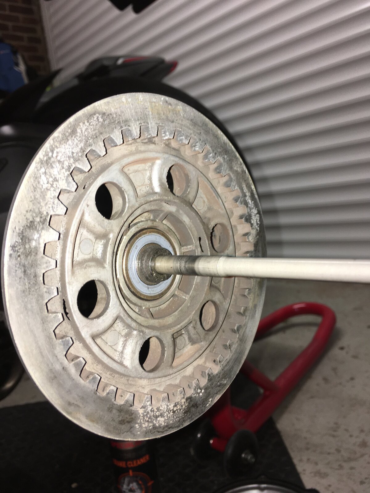

    Seller said it had a clutch problem. Either slightly worn plates or dirty plates. For sure, there is a grabby/dusty/slippy kind fo feel in first pulling away and on downshifts. But, I think that’s because its a slipper :) Which if it is, what a result! I tried a few times, down 3 quick gears into roundabouts and you feel (may be audible too) a ‘slippy/dusty’ sensations from the clutch and engine braking and no hopping or lock ups. Tried quite a few times, got a bit more aggressive, same result. @RickyX said its a two min job to take off the plate and check - being I having had one in probably 15 yrs! What am I looking for?

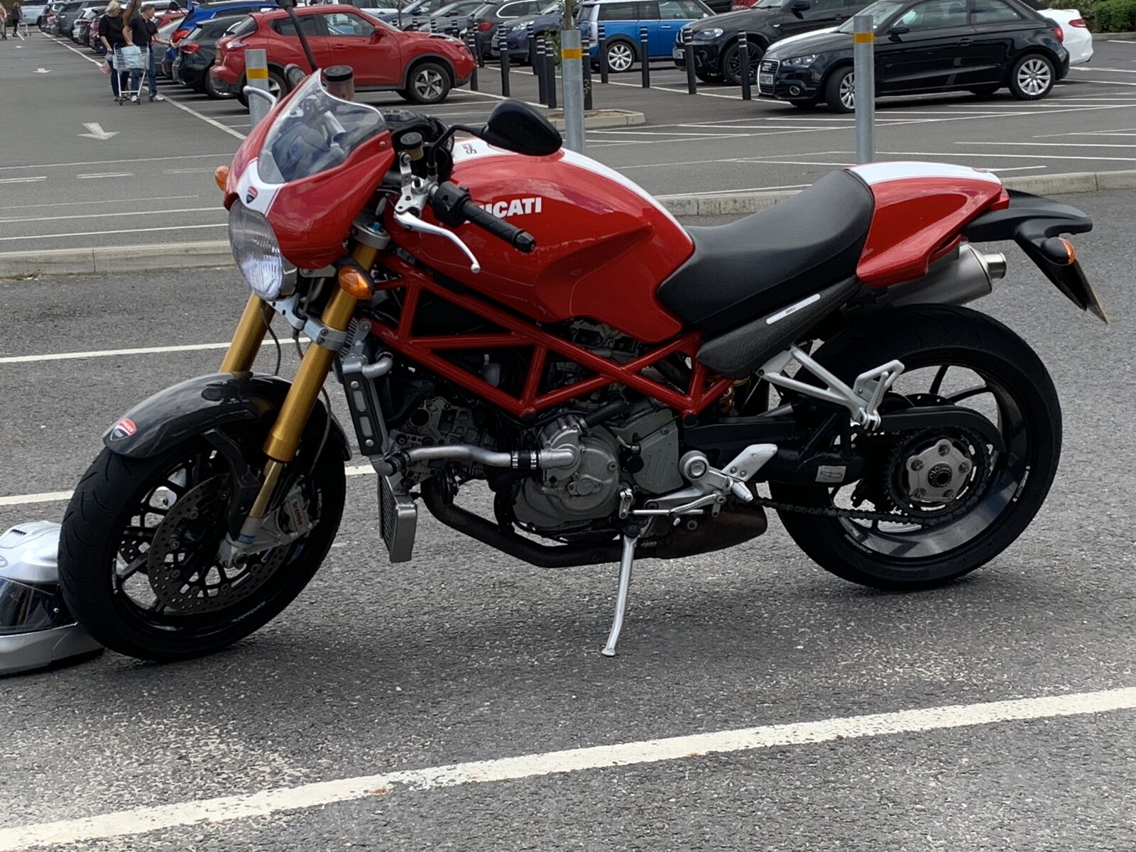

  2. Looks nice chief, sounds like it brought you some old school fun and dare I say a wee bitty smitten?
    Is it my dodgy eyesight of shadows in the pic, corrosion on the case below water pump?
  3. The engine is in fairly poor state for paint flaking. It needs taking out, rubbing down and painting. Probably get it done over the winter when I get out serviced.

  9. To check if it’s a slipper:
    Remove carbon cover (4 bolts)
    Remove clutch springs (6bolts)
    Take pressure plate off
    Turn it around to look at the inner face
    If it has “teeth” on the inside - standard nonslipper
    If it has no teeth - slipper
    Reverse the above process.
    Ride.
  10. Ref slipper. Look on back of pressure plate - just pull it out a few inches. If it has teeth it’s not a slipper. If it has no teeth it is a slipper. The slipper will also have a spider washer thingy.
    Enjoy.
  11. While you’re at it - you may want to pull the pushrod out and clean and regrease it.
    This will add another 5 minutes to the task.

  15. If I’m taking it out, I may as well remove and clean the plates too. Regular old grease needed and disc cleaner for the plates?
  16. Yep, sounds good.
    Make sure you check the order is correct - don’t assume that they were correct initially.
    Rule #1: Trust Nobody!*
    * including me!
  17. This might be of use as a guide only. Andy
