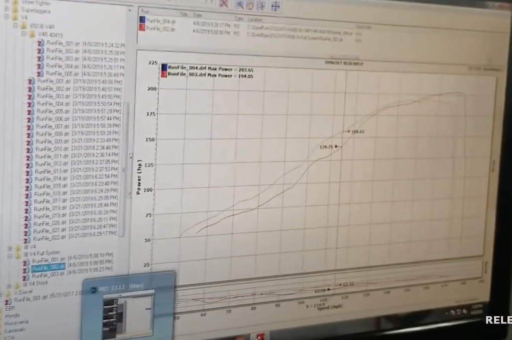

  12. ON your DP maps loaded by a dealer note heres a V4 special ie 1100 motor same as base and S, versus a v4R 998 motor.....from 7000 up to 11000 the special is up to 20 hp up on the R.....its not really until you go on a 1000 revs beyond the special that the R exceeds its power...
    but if you can see the AFR ratio lines at the bottom both are very rich.. the R is running under 12/1 at peak revs when it could go on to 13/1 ... loads more power to be had on both with a proper tune!

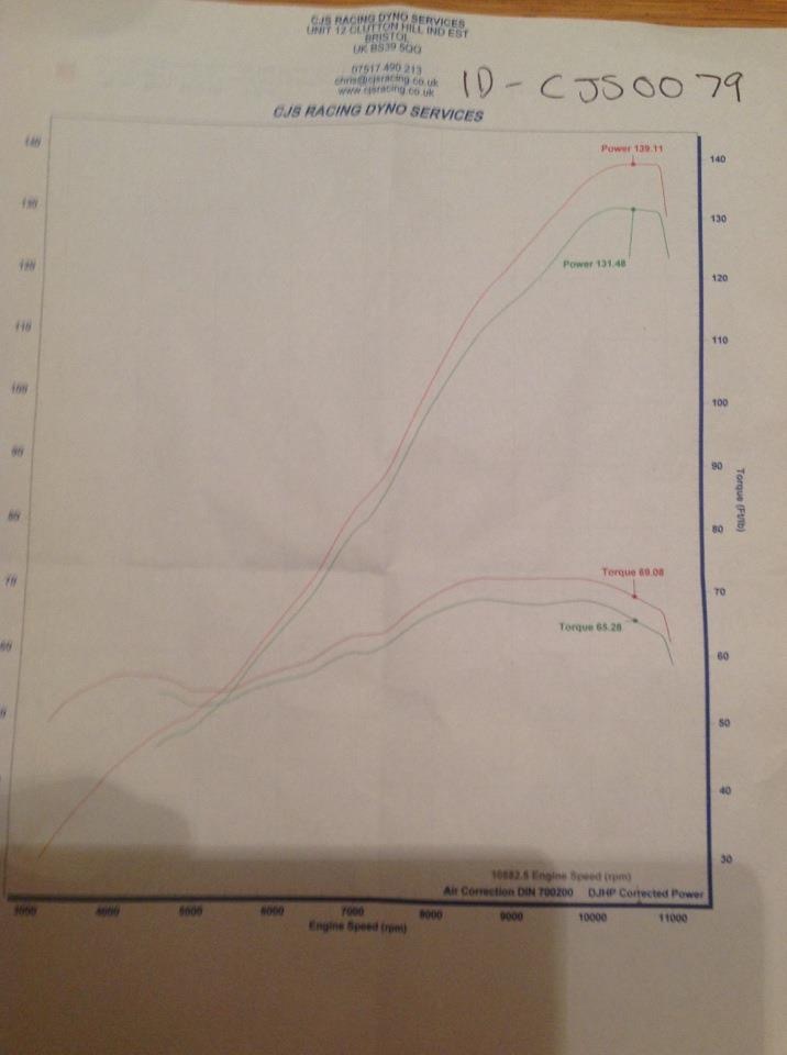

  17. I know, heres my Evo with DP map then custom map.
  18. Ah the jhp red crayon if I’m not mistaken...;).
  19. you're mistaken...poor obs
  20. No I’m not..... I remember you going to Cjs still the jhp red crayon..
