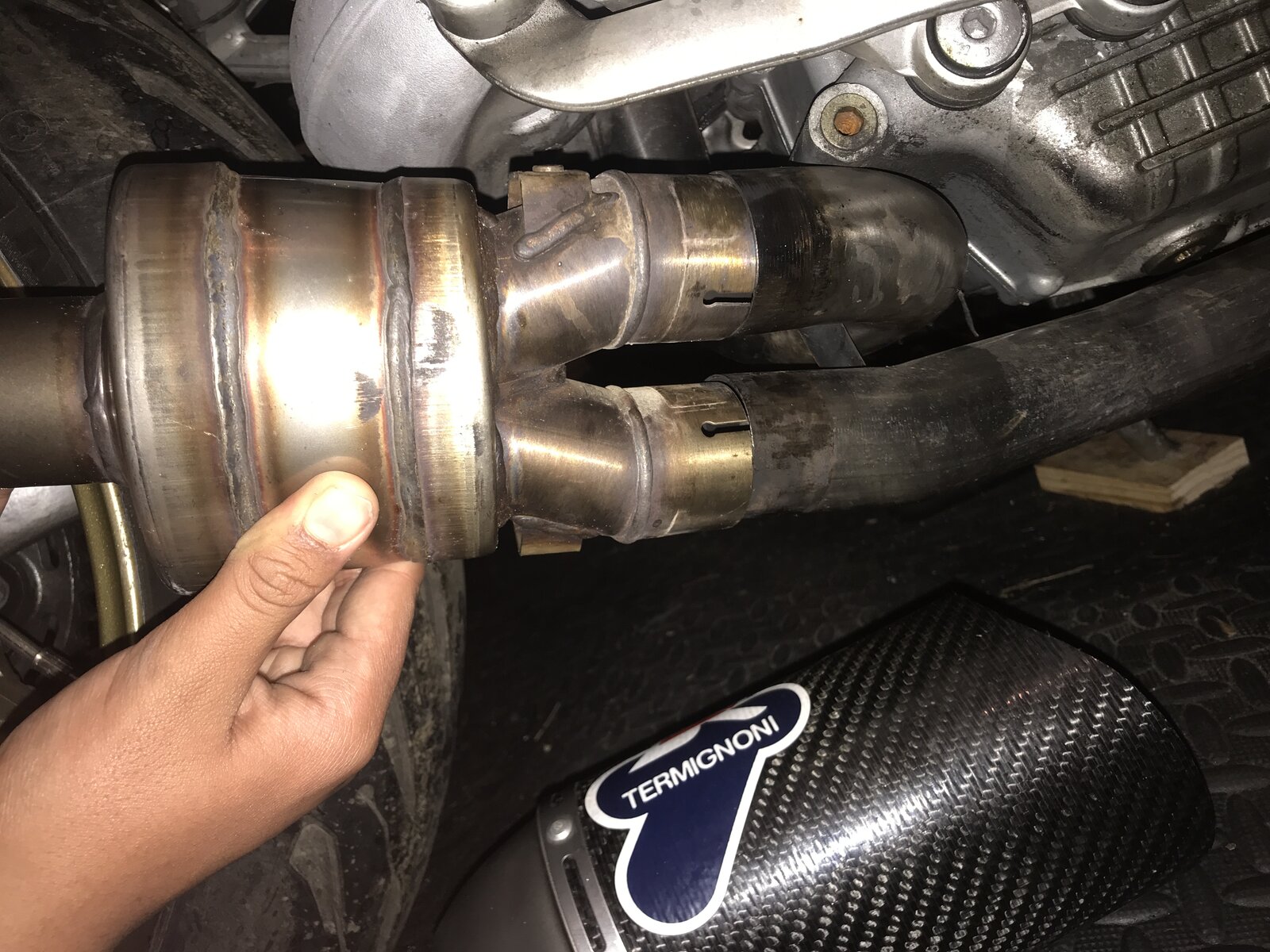

    Is this what you mean?
    If so, it comes with a baffle. As you can see, mine is de-catted (if it ever had a cat) and it is very loud without the baffle in.
    It is designed to slip straight on to the outlets from the cat but if you get aftermarket or de-catted downpipes, then you will probably need an swaged adapter. I bought a couple off eBay but I had trouble getting one with the correct bore differential, so I ended up taking a blow torch to the inlets and then bashing the adapter in with a mallet so when they cooled down it was shrink fitted. I then brazed spring loops onto the Termi inlets because after having once run over my own underslung end can which fell off, I don't trust clamps.
    The end can offered up to the bike, showing that the Term inlets are the same size pipe as the downpipes, and hence the need for an adapter.

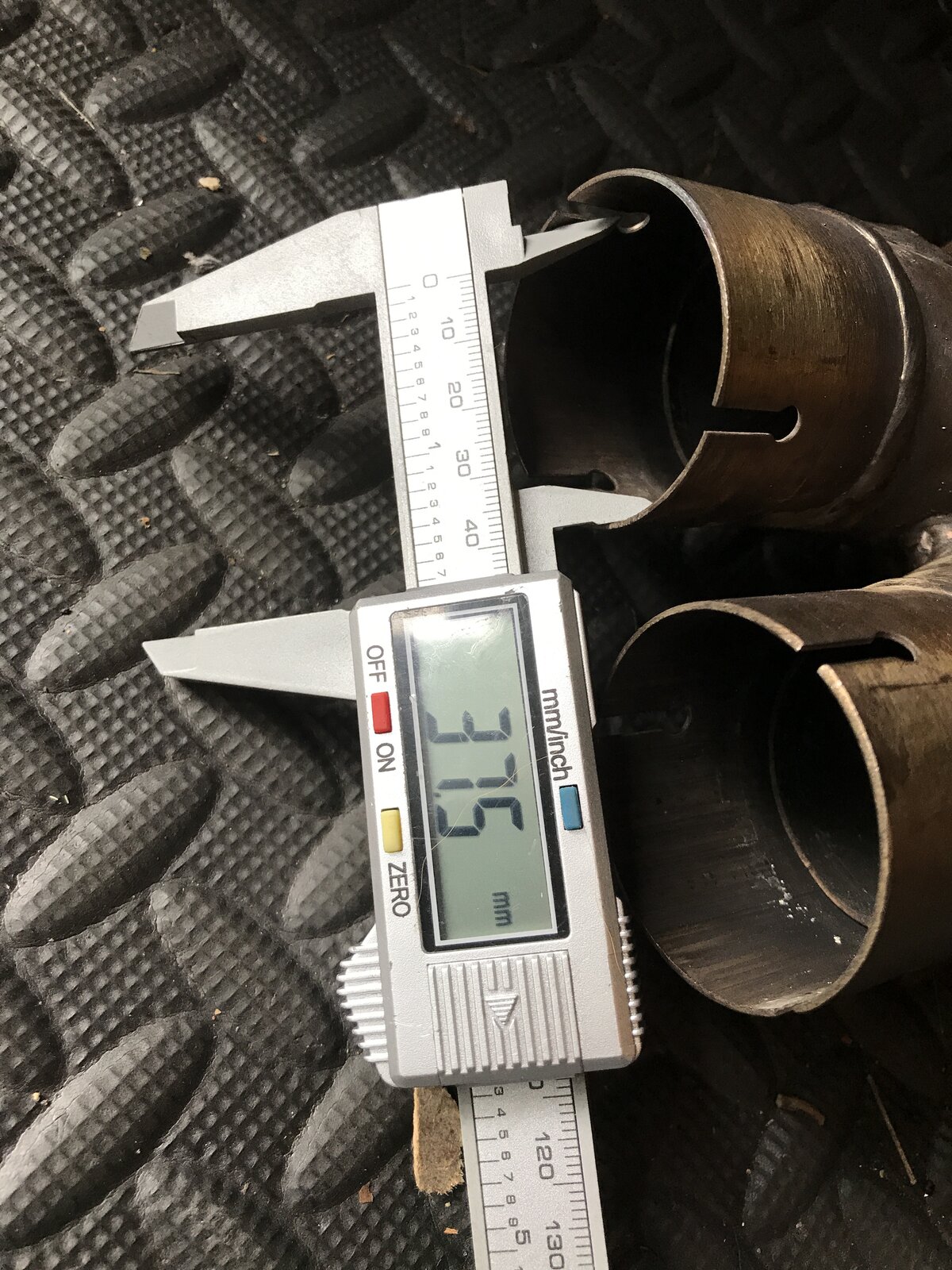

    Inside diameter of the Termi inlets. OD is 45mm.

  8. Pics posted.

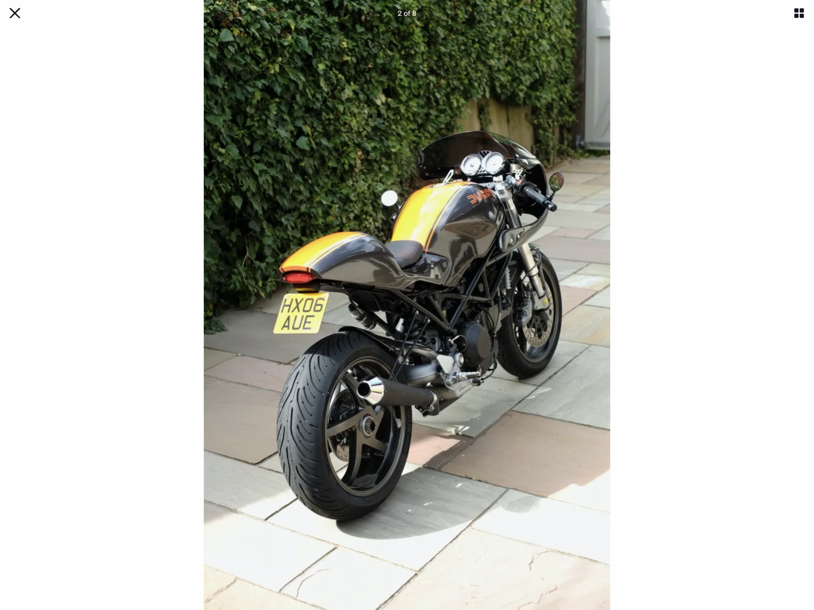

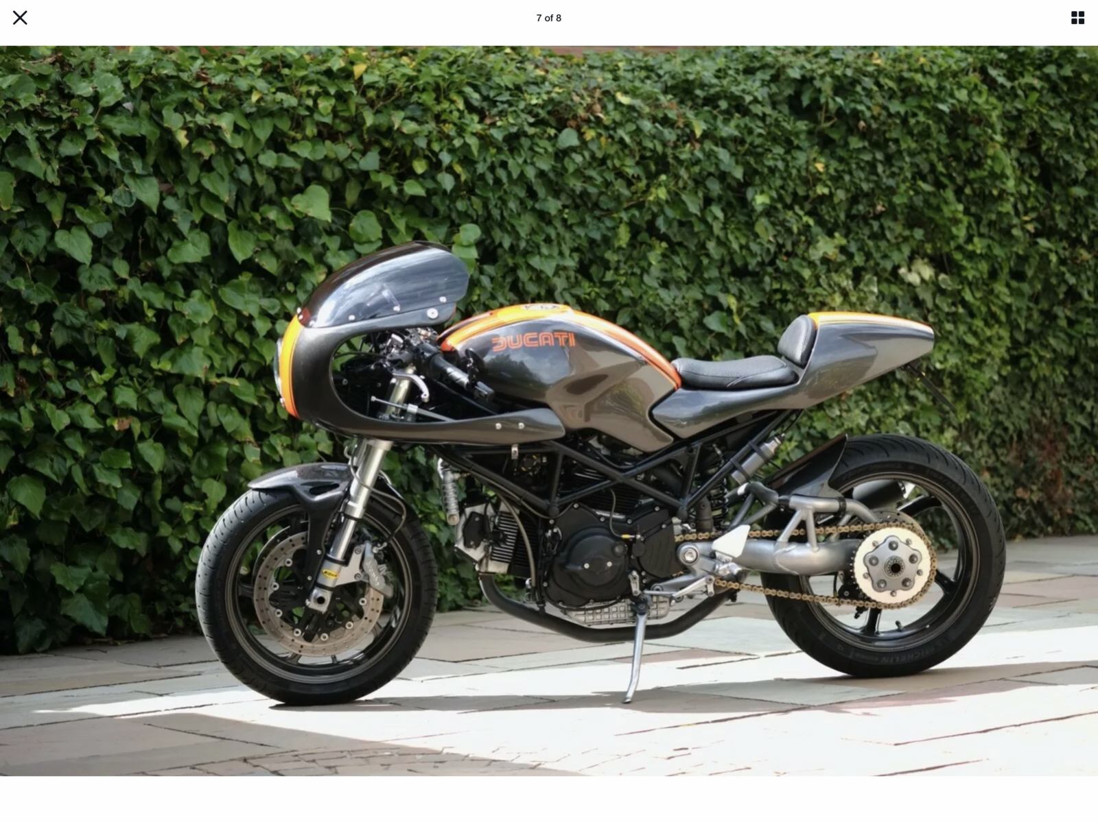

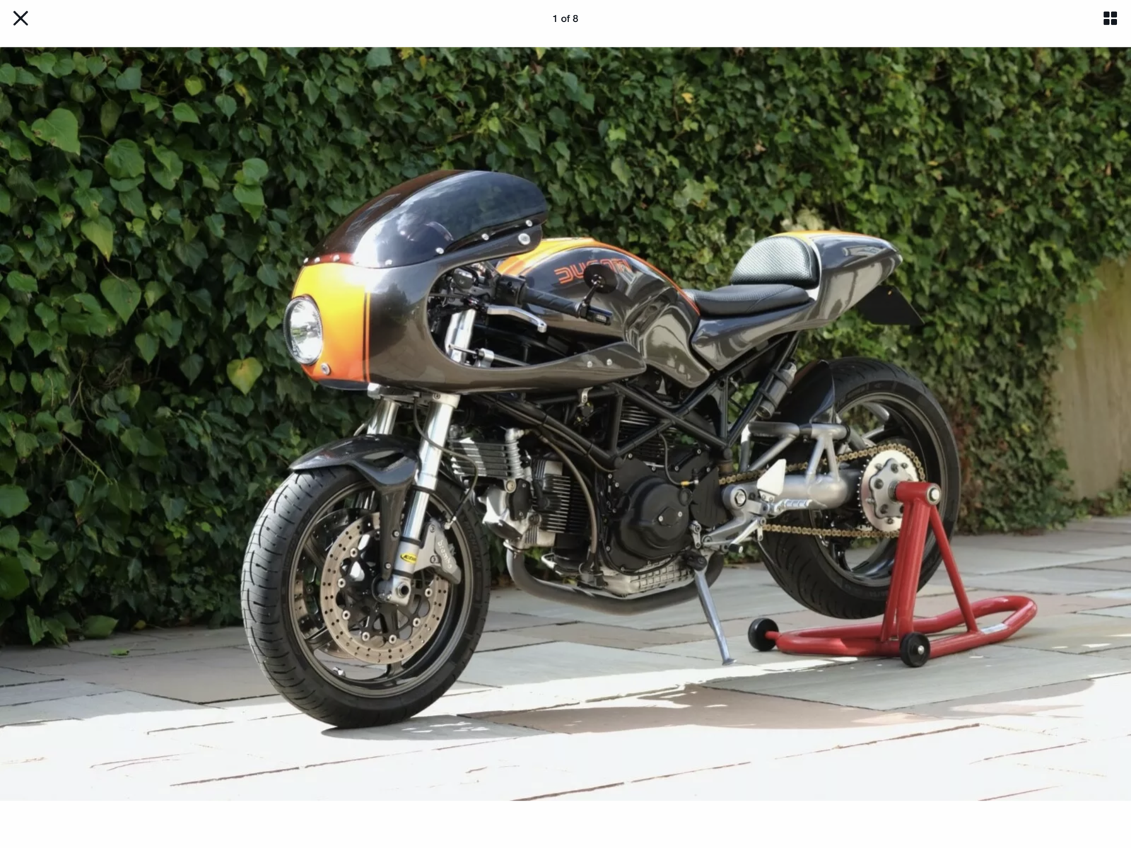

  13. I really liked this, and very nearly bought it, so this is what I’d go with as max changes
