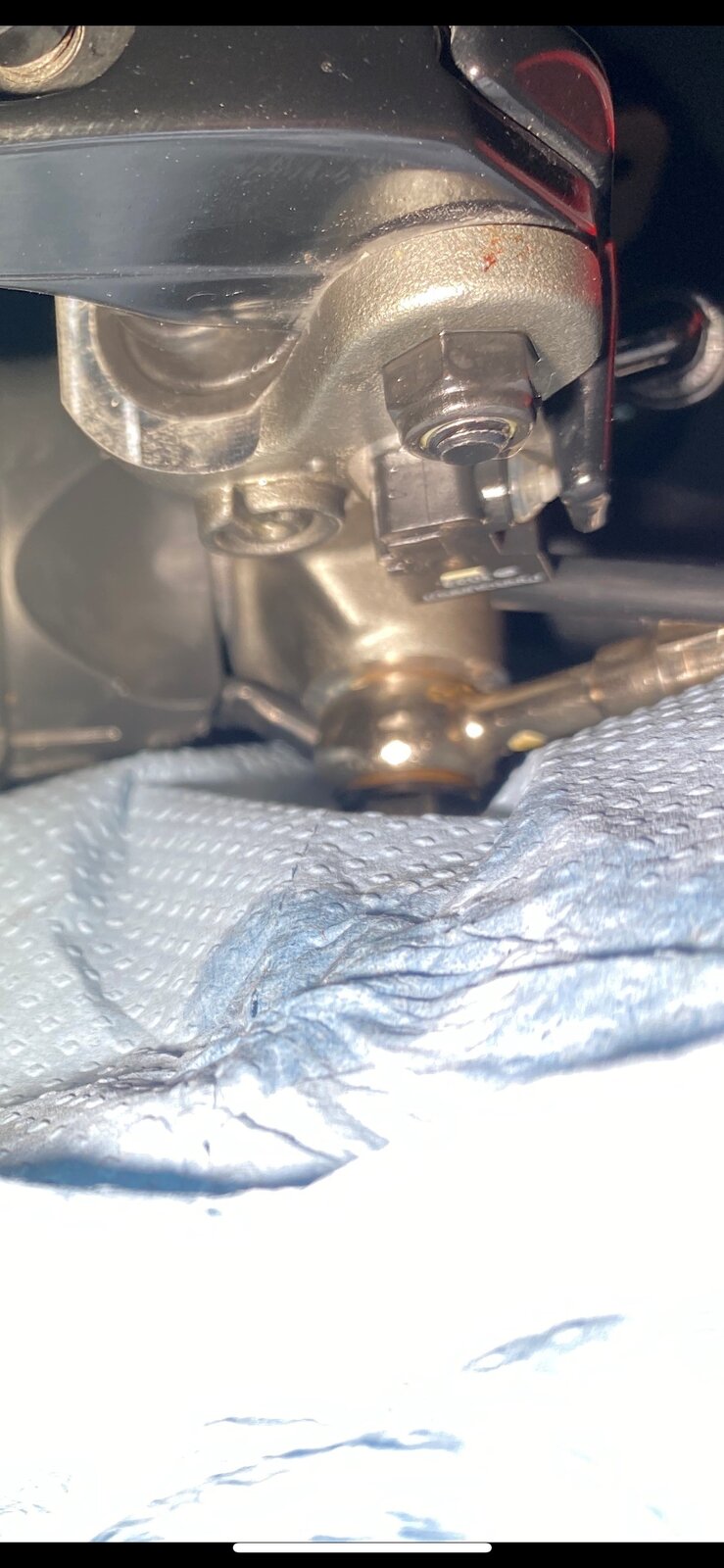

  3. Hi Ian - appreciate im resurrecting an ancient thread here but can you recall any details?
    My 2018 Monster R appears to be weeping brake fluid from the underside of the master cylinder. Seems to be the nut thats wet?
  4. Your local dealer should be able to check if the bike has had the recall work completed I think
