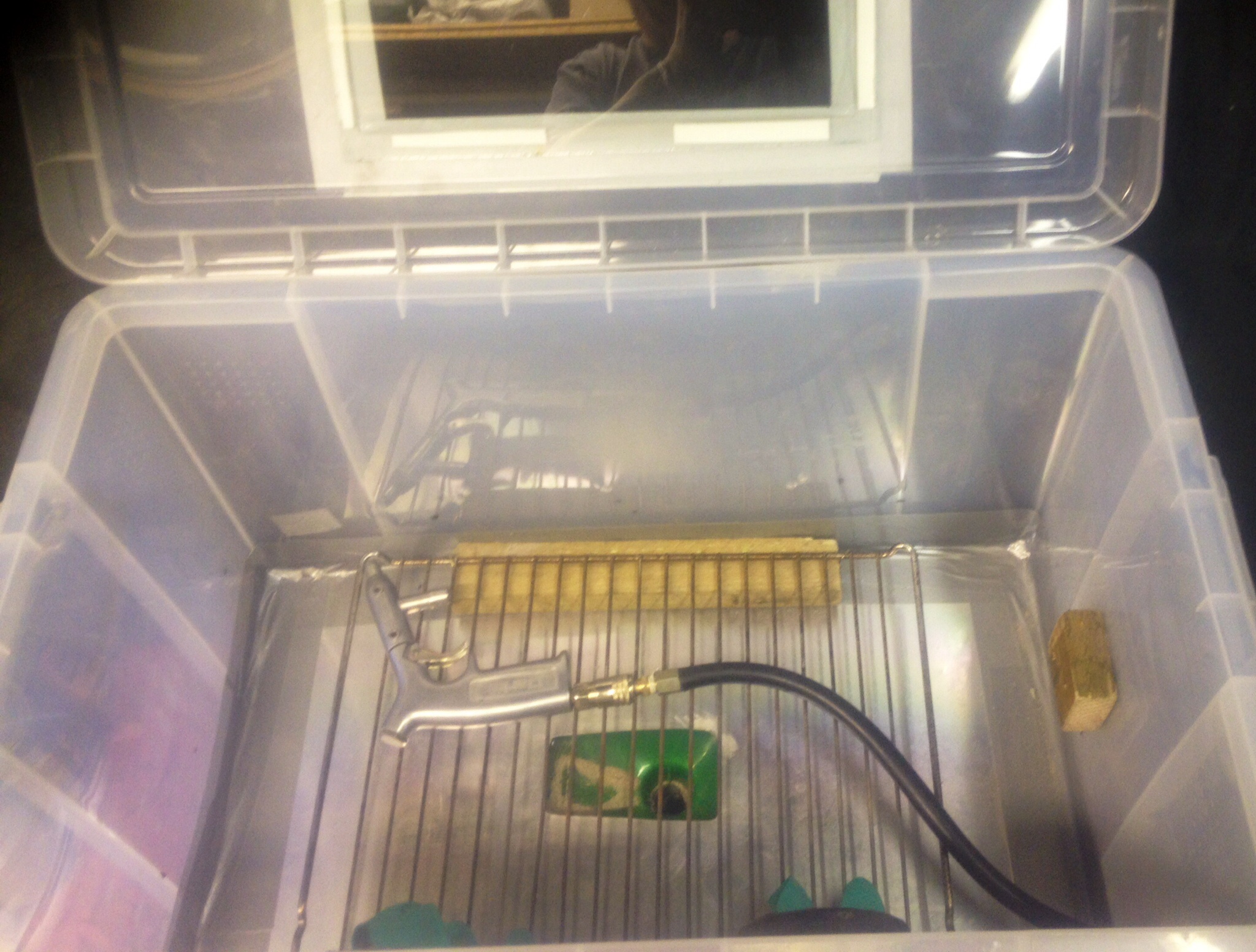

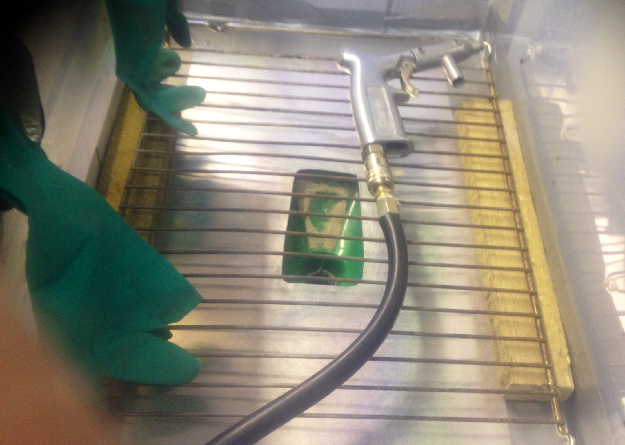

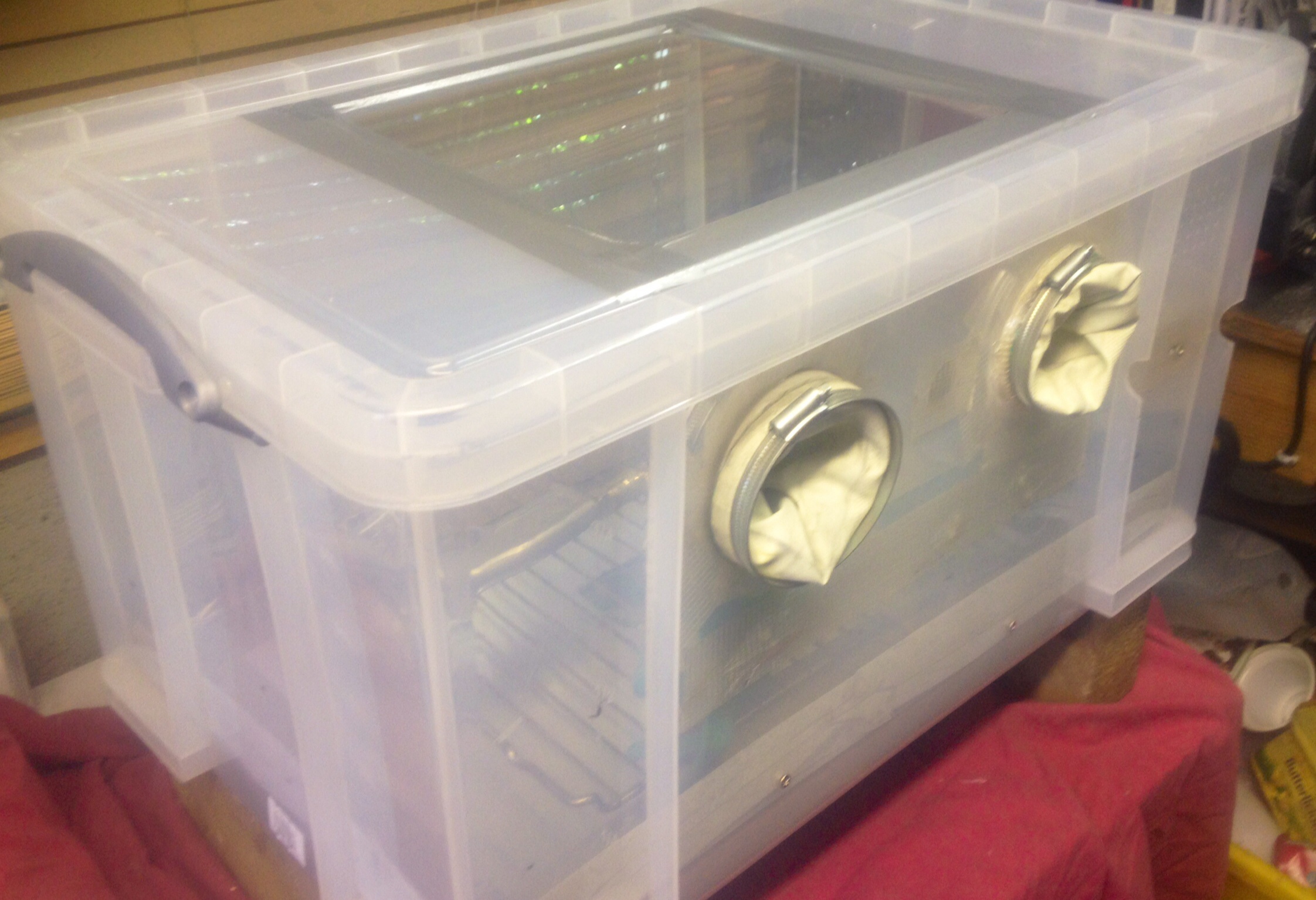

  1. I've just completed the modifications I wanted to do and those that a few of my DF forum friends suggested.. Well worth the extra time.. It's now a one way sealed system, grit comes up from the sealed tub below, through the gun and down onto an aluminimum litho plate with a large funnel below, down the funnel and back to the tub.. I was going to make the alum plate, funnel shaped, but, to be honest most goes down and away on its own and that which dosn't can be quickly brushed into the pipe by lifting the hinged grill and simply brushing it away.. Have cut out and fitted a glass panel in the lid, sticking the glass via some sticky number plate pads.. Fitted a right hand glove now too, and placed the gun in the box...
    " Sandblast 2 "the sequel is available from all good B&Q stores, tickets start at £20....
    Sand box with extra hand and glass panel fitted..
    Lid up, grille down..
    Gun inside now!
    " This is a Clint Clarke, 45 blast gun, capable of blowing your painted wig off, ...feeling lucky punk?"
    Aluminium plate fitted and funnel below..

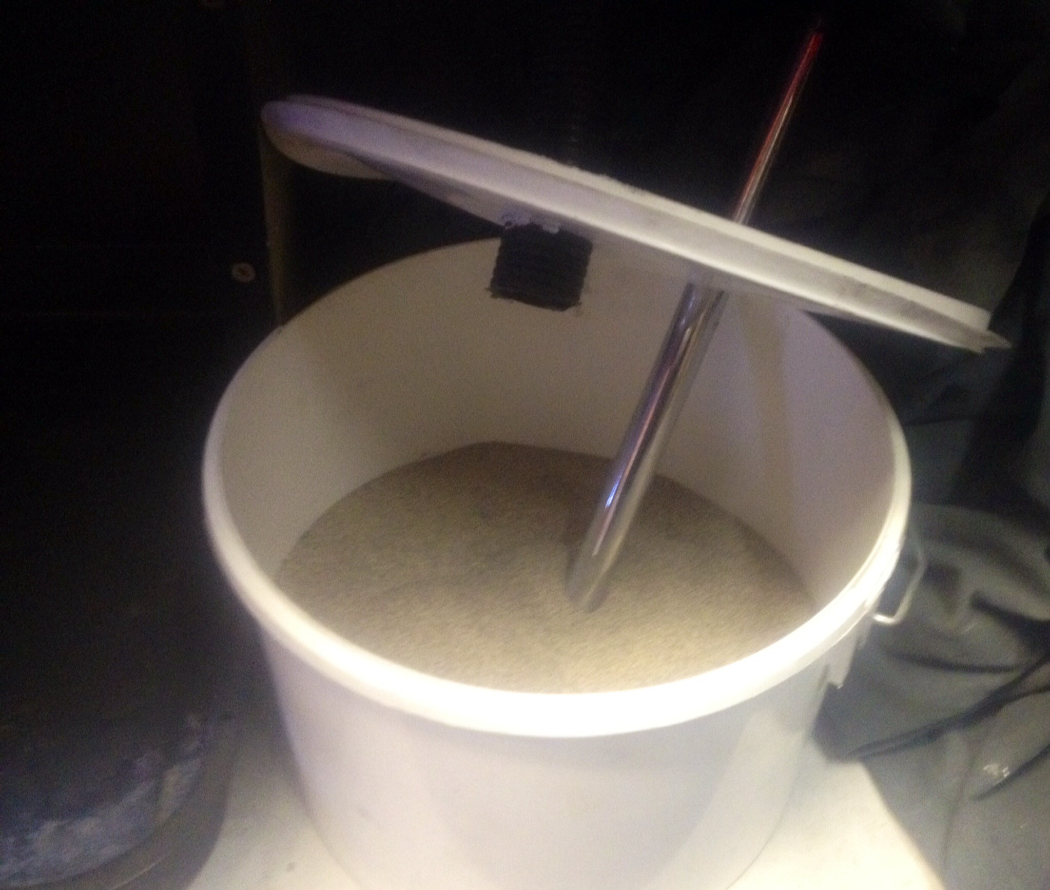

    Sealed tub with grit pick up pipe and exhaust... ( sorry, not a termi)
    Total cost £30.. Any advice just ask..

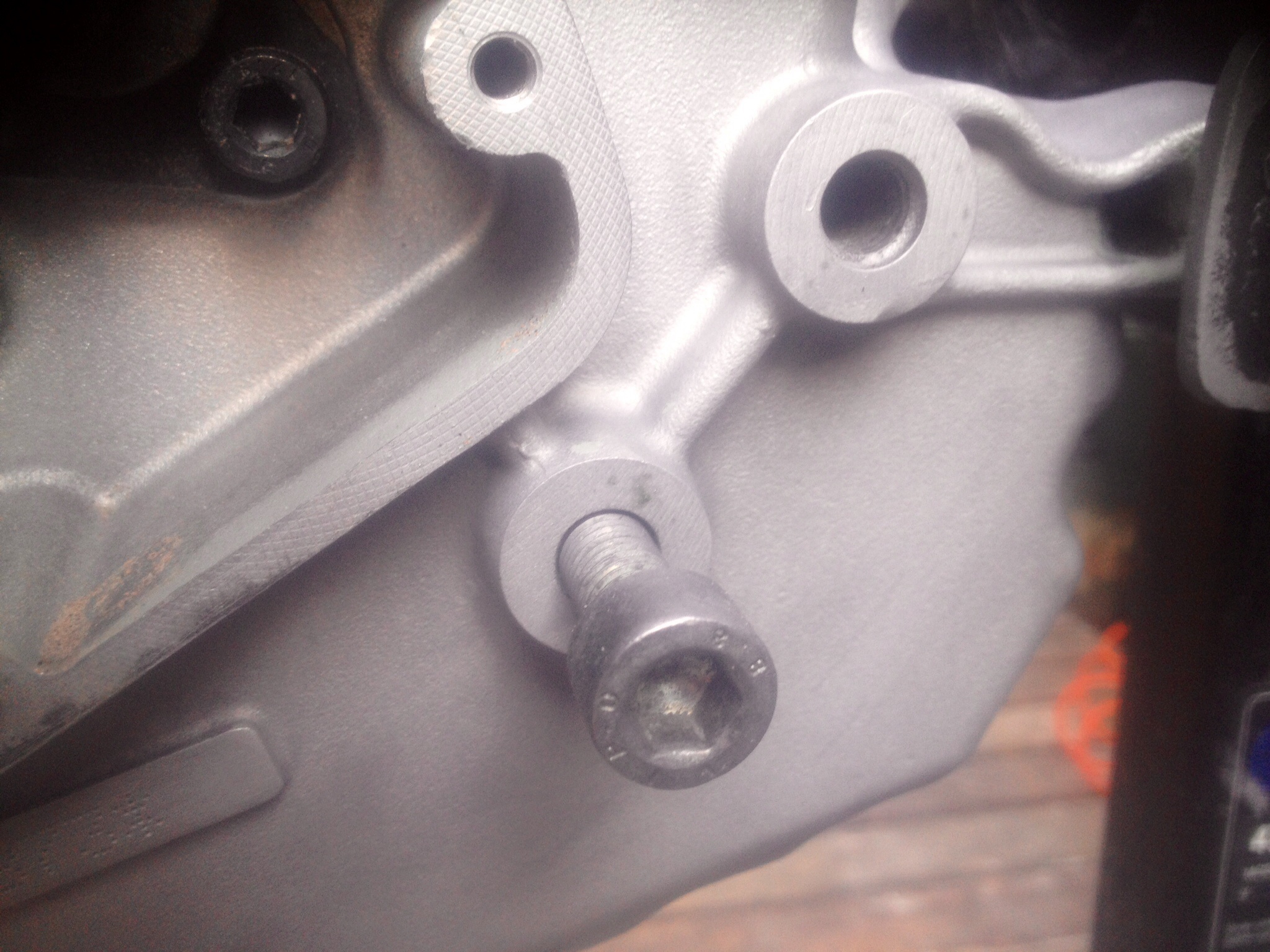

  3. I've now blasted a complete engine, can use glass beads on delicate areas or I use the very fine block paving sand from builders merchants, £10 for big bag.. Just make sure it's dry...
    I've also now found it runs a million times better if you plumb a copper pipe as the sand pick up pipe instead of the rubber one which comes with the gun.. With rubber pipe the sand sticks in the inside of pipe occasionally.. Metal, no sticking..
    I've now replaced mine with a flexible metal water pipe, the type plumbers use under a kitchen sink.. Flexs but does not stick... Recycles sand, light weight box, which when not in use can still store items.. Stack away out of way, cheap, runs superb.. Friend paid £50 a Ellie ago to have a few parts stripped.. I've saved hundreds now!

  5. The photo of that engine casting shows just why it's best not to paint them...........the sand-cast finsh is almost the same as the 80's Guzzi engine castings........clean them with Gunk and a quick scrub over.
    After all, we surely remember what the early Jap castings were like when they lacquered them........more damage done to the ally by water getting under the lacquer than just leaving them bare.

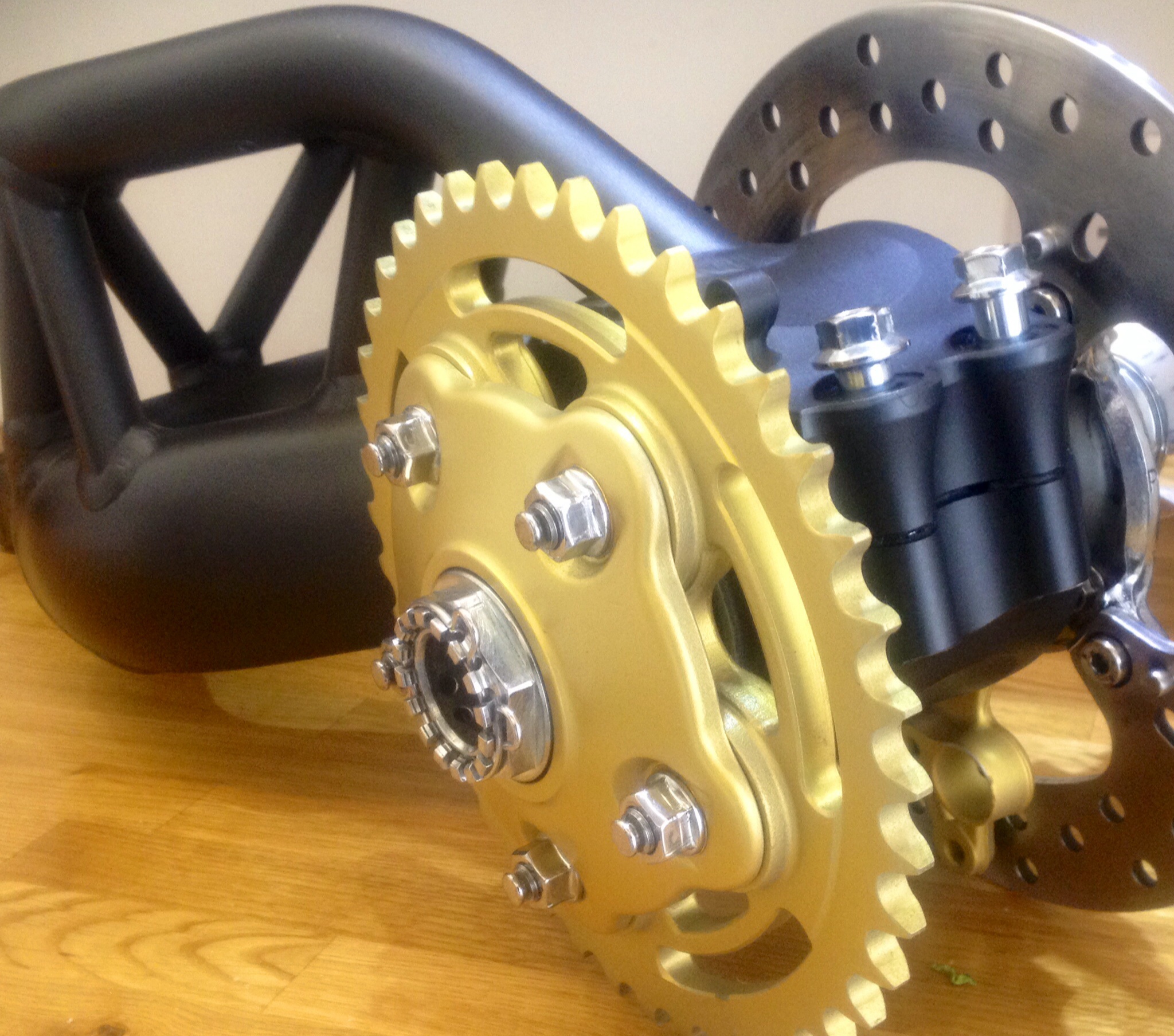

    Below is my swingarm etc..
    image.jpg Everything was stripped bare and then I re painted and lacquered.. All done in my B&Q box.. Ps blast gun, bargain of the year new from machine mart £17...
