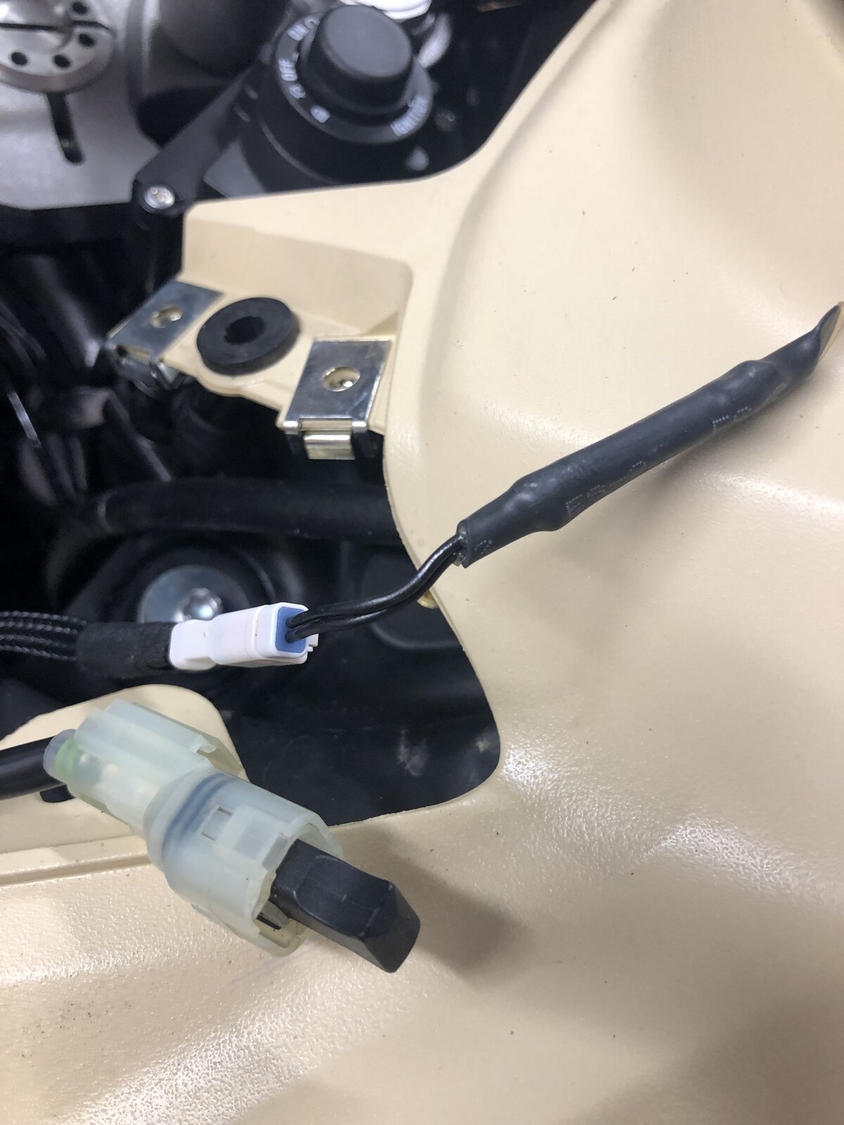

  2. Ducati always give you an accessory power supply on the multi. Hook it up to that. Not sure exactly where on the new one though but others on here will know. Usually LH side, tucked behind a panel and wrapped in tape.

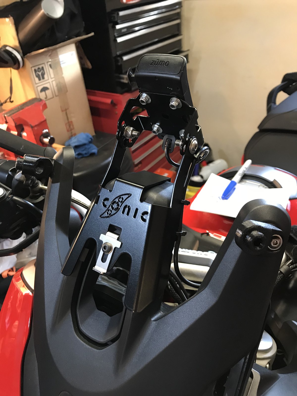

  3. If you need a mount give me a bell. I have one to fit multiple Nav unit types.
  4. agree eleventy billion percent with Jamie and his products ... he and they are great.
  5. They look great Jamie, I’ll be in touch in the new year
  6. 236AE1A1-8DFF-4917-AB9A-8779BA0E6511.jpeg I think I found it on the new 1260! Is this it ?
  7. The smaller, white connector with the wire tails is for the Sat Nav. The larger, transparent connector is for the hands free filler cap.
  8. I have the BMW Nav 4 on my Enduro, which i also sold my GS for :)
    Yeah just wire it into the pig tail, with white plug, it will turn on and off with the ignition.

  9. Looking to buy sat nav mount for a new 1260 enduro from Navihalter but they only list it a compatible for Ducati Multistrada Mod.2015>, MS Enduro Mod.2016> MS 950 Mod.2017> MS 1260 Mod.2018>
  10. I sell them www.iconicparts.uk

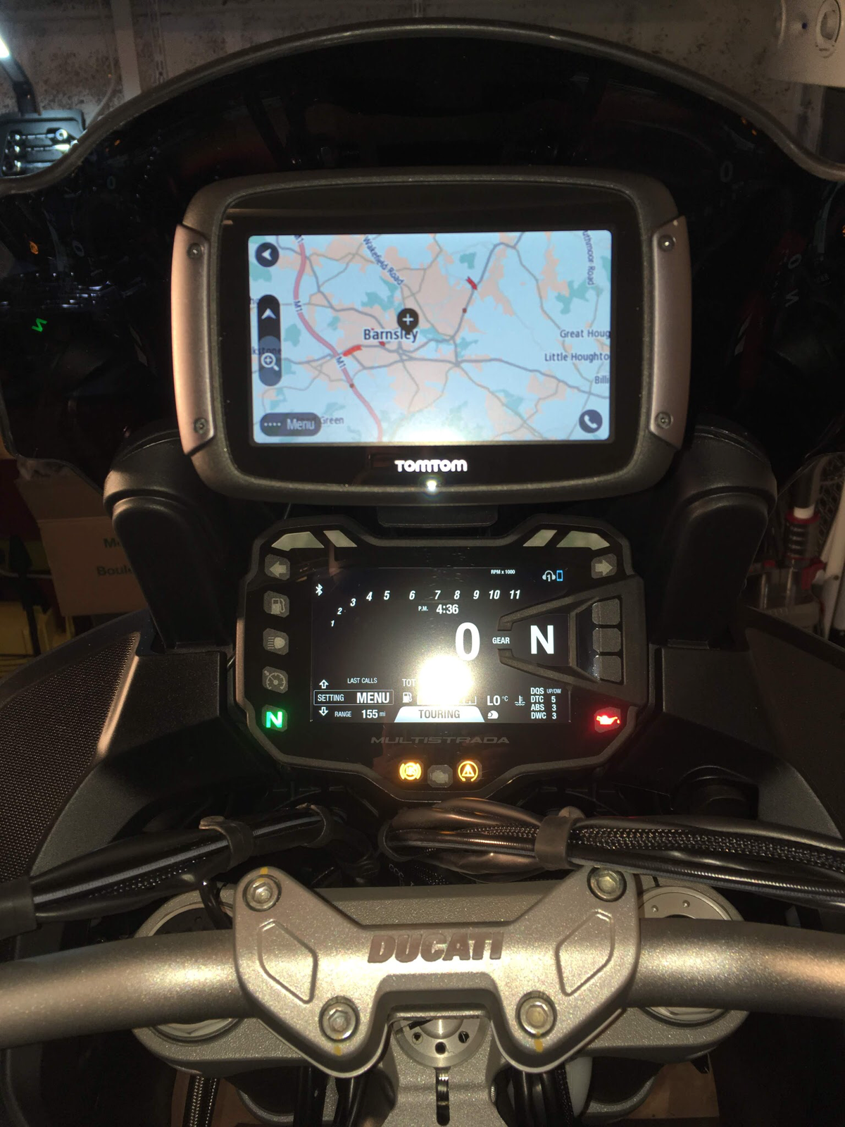

  11. What sat nav are you going to use ?

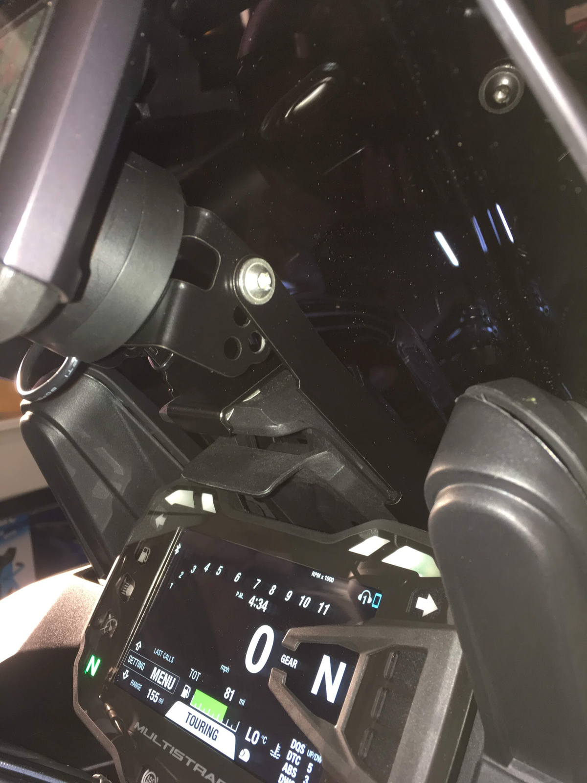

  12. I can personally vouch for the iconic parts sat nav mount, Jamie's stuff is very good quality and fits well. I have fitted a TomTom 550 to mine....
  13. Tom tom rider
  14. Yes there is a bit of vibration but it appears to be in the mounting on the Tom Tom rather than the bracket and mainly at low speed.
  15. The white one. Splice the ends and connect gps wires
