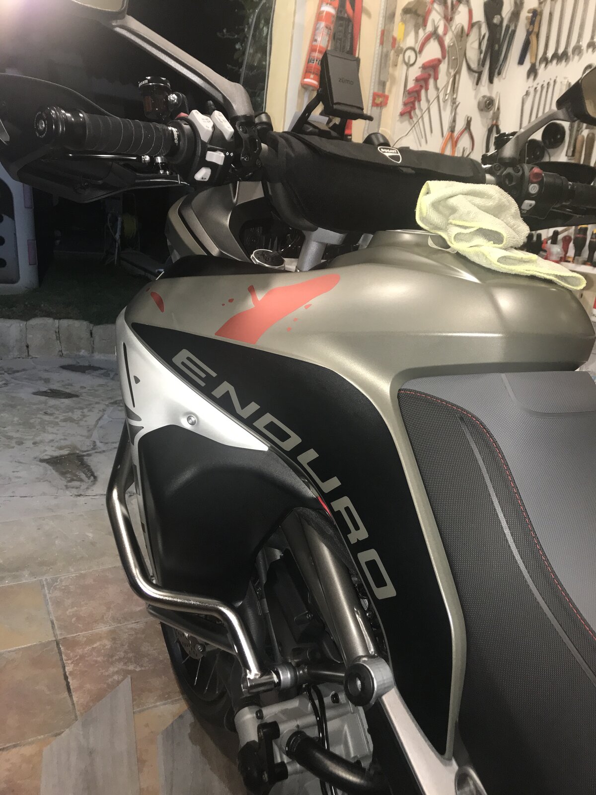

    I bought an original Ducati nav Mount Part no. 96680581A and fitted it to the bike. The Ducati online configurator lists the Garmin Zumo 396 nav unit so instead of paying nearly £800 for the unit, I bought the Zumo 396 LMT-S unit from eBay brand new.
    Now this is where my problem starts, the mount for the nav is the wrong way round, the Zumo 396 I bought clips in on the left and right hand side, where as the Ducati mount wants it to clip in top and bottom. I’ve bought two different mount kits from two different dealers as one dealer told me they changed the mounting but they’re both the same.
    Help!

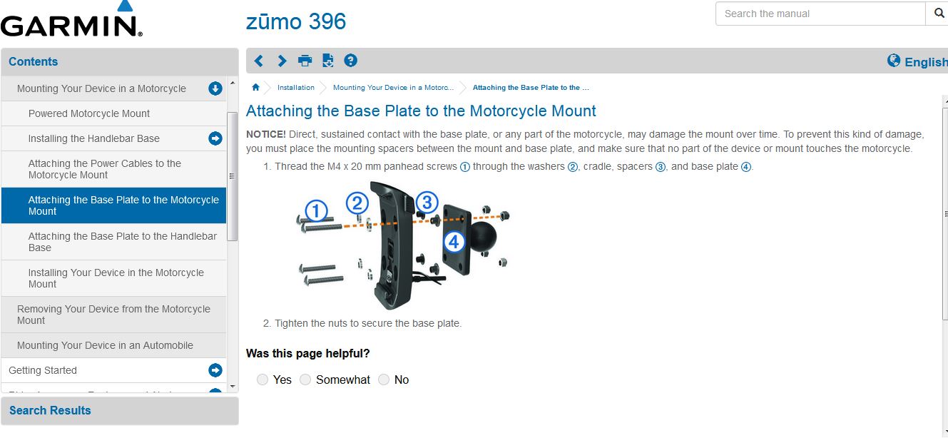

  5. Can you not fit the 396 mount that came with the unit?
  6. i want to mount it above the speedo, the mounts which come with it are the handlebar mounts.

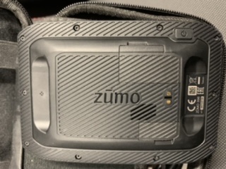

  8. I think you need to take a look at the Ducati nav Mount and then you’ll understand what the issue is...
    I’m keen to find out what the back of the Ducati branded Zumo 396 looks like, has anyone got one?

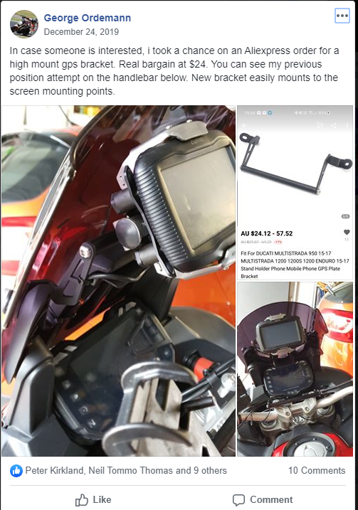

    Maybe look at getting a similiar bracket on AliExpress that uses the windshield mounts to place the Zumo 396 brackets you got with the unit (i have the older 395 in a touratech mount but it uses the same 12mm rod to mount to)
  12. Looks like that works, but I’d still like to make use of the original Ducati nav Mount as I like the look of it and it’s pretty solid.

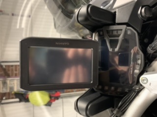

  14. I've got the zumo 346 which is western Europe only version of the 396 so exactly the same. I'm using a navihalter and it sits correctly. You have to use spacers to give room for the power lead. I'll get some pics up later if you want.
