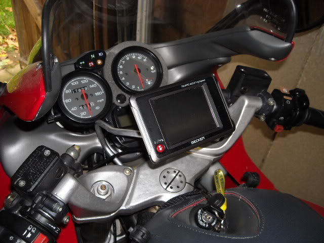

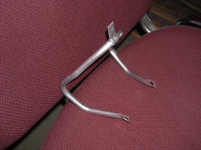

  4. Sure. First one was for my cheap shit Becker satnav (£90 when satnavs were £500+, it only lasted a decade...). Just some bent tube bolted through the fairing bracket mountings.

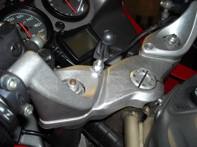

    The second bracket, this time for a Garmin, cost about 50p and took 5 mins to make...
  5. I fitted an alloy plate across the 2 inner handlebar securing screws.
    The picture shows it fitted with a mount form an Akron waterproof case that I later changed to a standard Ram mount.
