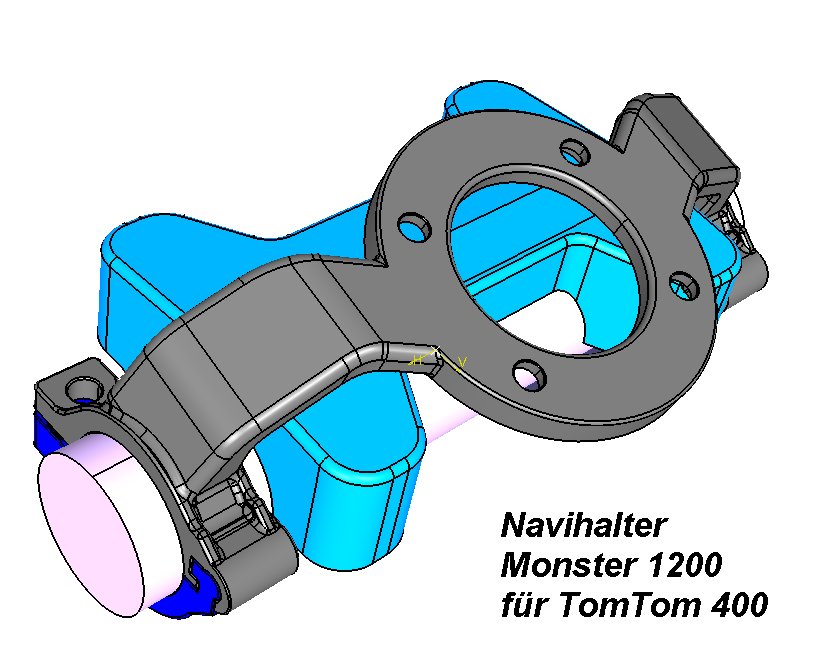

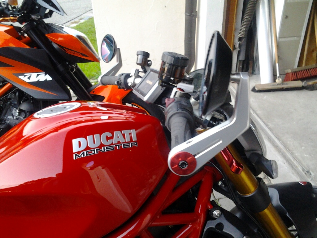

    Hello,
    if you need an idea how you could mount a Sat Nav on your
    Monster 1200, maybe this could be helpfull for you:
    Zumo 590:
    Ducatic Monster 1200 NAVIHALTER ZUMO 590 by Varadero on Shapeways
    TomTom Rider 4:
    Ducati Monster 1200 NAVIHALTER TOMTOM by Varadero on Shapeways
    Zumo660:
    Ducati Monster 1200 NAVIHALTER ZUMO 660 by Varadero on Shapeways
    Zumo 550:
    Ducati Monster 1200 NAVIHALTER ZUMO 550 by Varadero on Shapeways
    Zumo 3XX:
    Ducati Monster NAVIHALTER ZUMO 3er Serie by Varadero on Shapeways
    Tom Tom 400:
    Monster 1200 NAVIHALTER TOMTOM 400 by Varadero on Shapeways
    All solutions are from the German Monster Forum.
    Here is a Link to the Thread:
    Navi an Monster 1200S - Seite 15
    The Material of this parts is lasersintered Polyamid ( Nylon ).
    We just upload the CAD Models to this company.
    They produce it just if you buy one.
    We have tested the Concept on the Multistrada and on the KTM SDR 1290.
    After over 150 Parts we can say: It works and we have no Problems with the solidity.

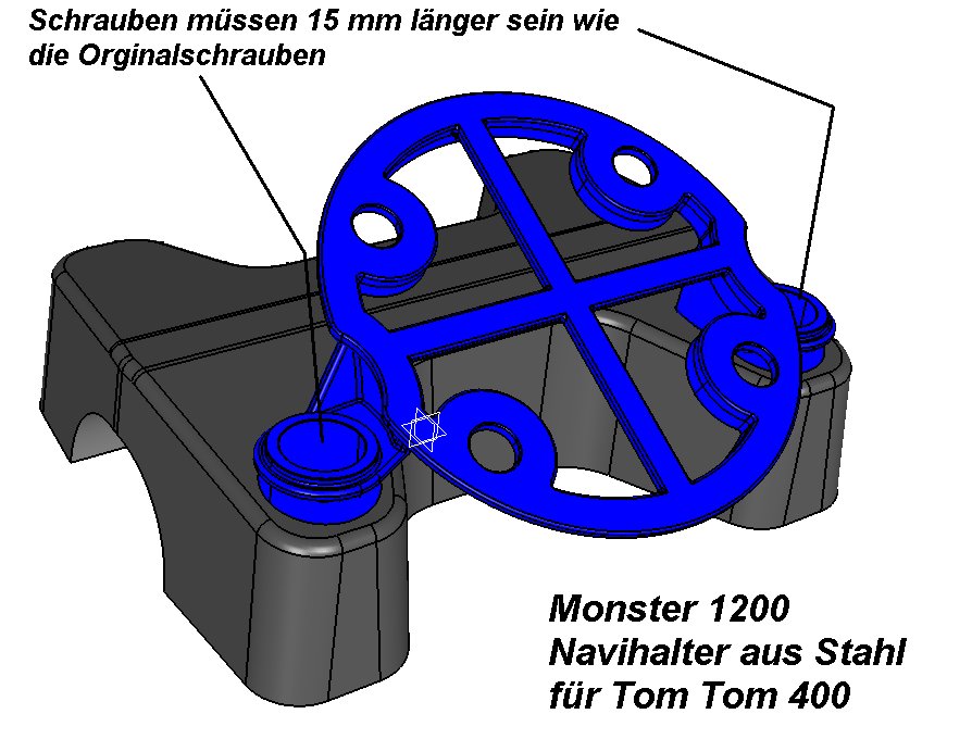

    Here are 3 Versions in Steel, you can mount it directly on
    your handlebar bridge ( right word? ):
    Zumo 3xx:
    Ducati Monster NAVIHALTER Stahl Zumo 3XX by Varadero on Shapeways
    Zumo 5XX, 660, Tom Tom Rider:
    Ducati Monster NAVIHALTER Stahl by Varadero on Shapeways
    TOM TOM 400:
    Ducati Monster 1200 - TOM TOM 400 - STAHL by Varadero on Shapeways
    You just need longer screws ( + 15mm ).
