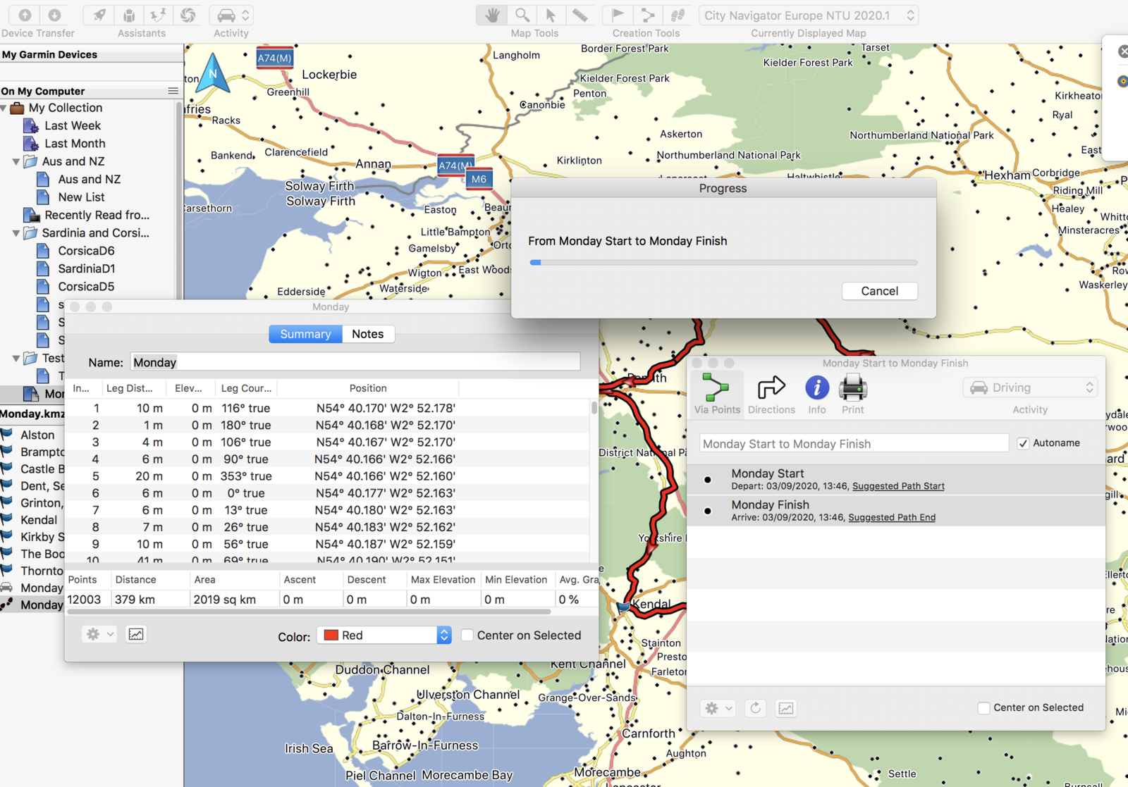

    Imported this into Basecamp and converting track to route

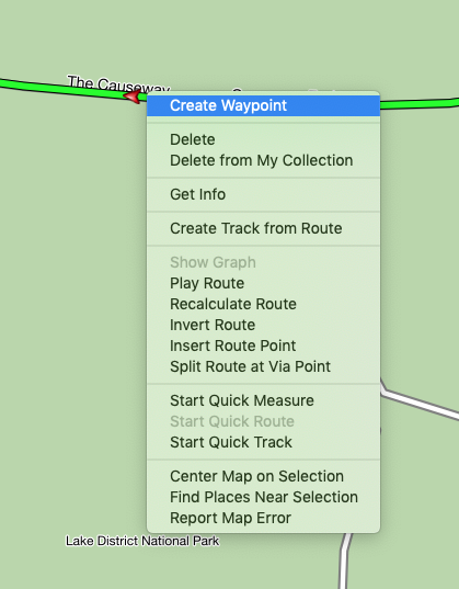

  7. Here is a another simple way in Basecamp if you already have a rough route, which is a bit 'cleaner':
    1. Create a new folder and new list (it's really important to do this to keep track of things)
    2. Initially place your major waypoints (right click) where you want them, name them something like WP01, WP02 etc. You can also add some text, e.g. road name, lunch stop.... Zoom right in to make sure you put them right on the road, not off to one side, or the correct lane of a divided motorway.
    3. Once you have these go to the Create Route button, drag your first waypoint (WP01) on this, then drag WP02, let it create a route, double click this and then drag each extra way point underneath WP03, WP04 etc.
    4. Once you have the basic route, zoom in and check it hasn't sent you down any odd goat tracks or a different road. Sometimes you need to create an additional waypoint (WP06a), then slot this between WP5 and WP6. If it starts drawing straight lines just click the little cog and Recalculate Route.

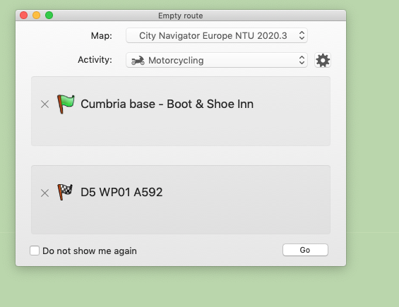

    Start creating a route
    Drag the start and WP01 onto the route

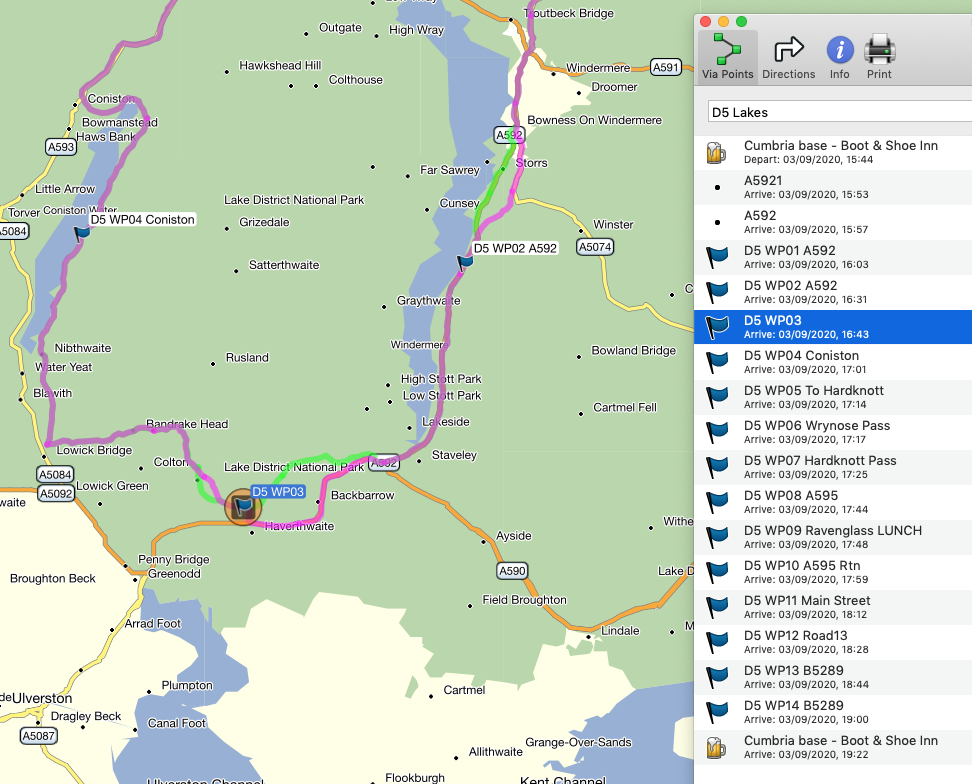

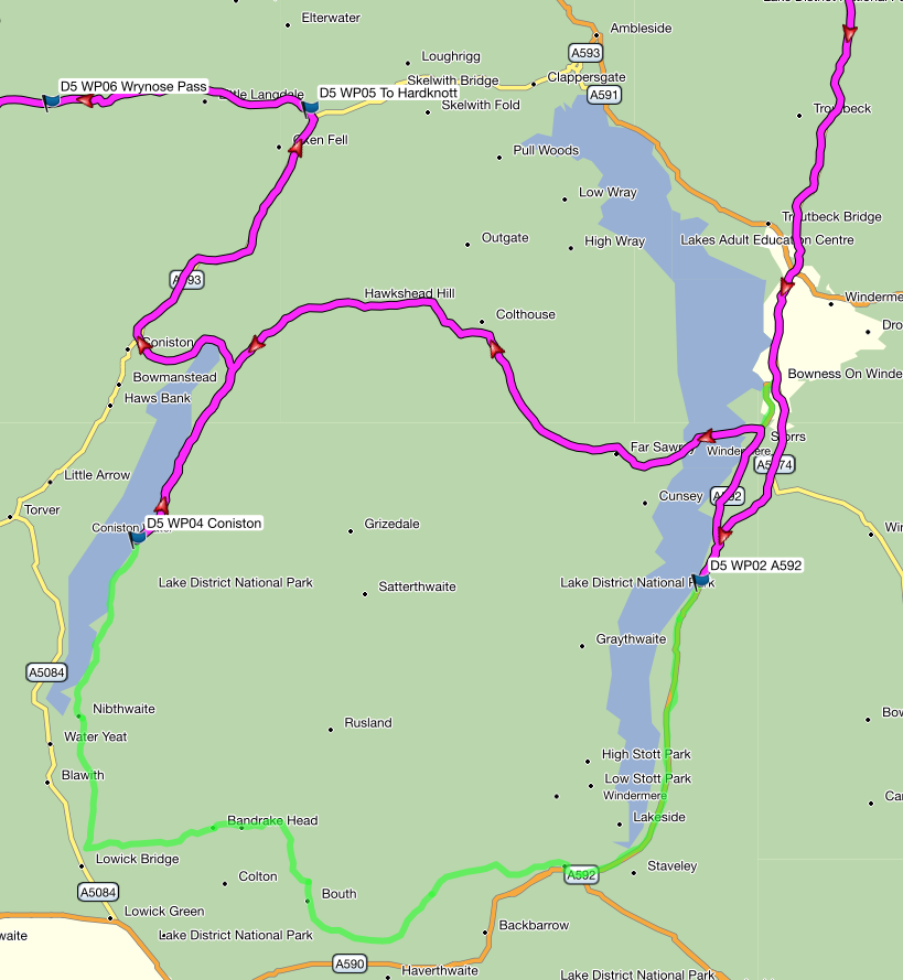

    This is the first section in Brown, the green line is the Google maps version
    Changed the line colour to Magenta, added all the Waypoints in number order. You can see some sections are different from the green Google map

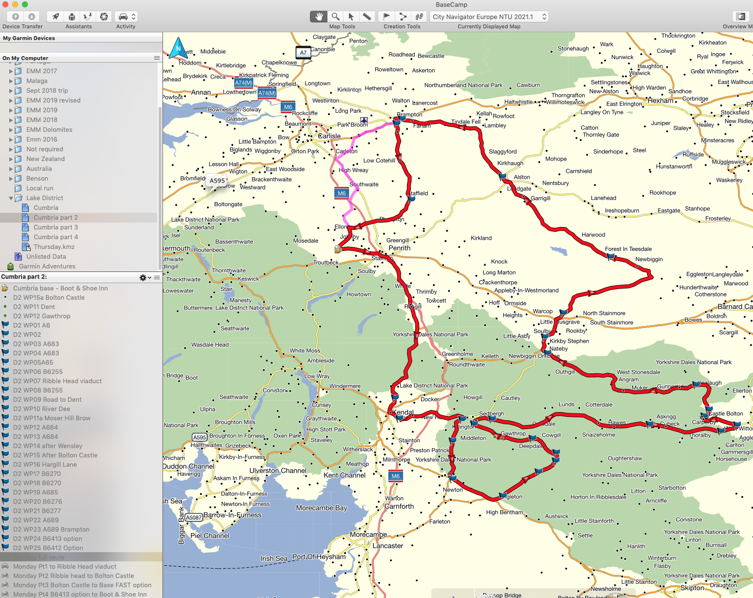

  16. What purpose is the track in Basecamp used for ? When I transfer a route into it, I delete the track. Should I not be doing that ? Andy
  17. In Basecamp I check that that the route follows the track (default colour for track is grey, so change to something more visible). You can fix any divergence by adding shaping points to the route. You can also step through the shaping points at the highest level of zoom to check they are on the desired road. Once the route is shorted then I delete the orginal track as transferred from MyRoute and create a track from the route. I transfer both the modified route and new track to my Garmin Zumo sat nav and double check that the route still follows the track. If is doesn't then it usually means that the maps are different between Basecamp and the Zumo.
