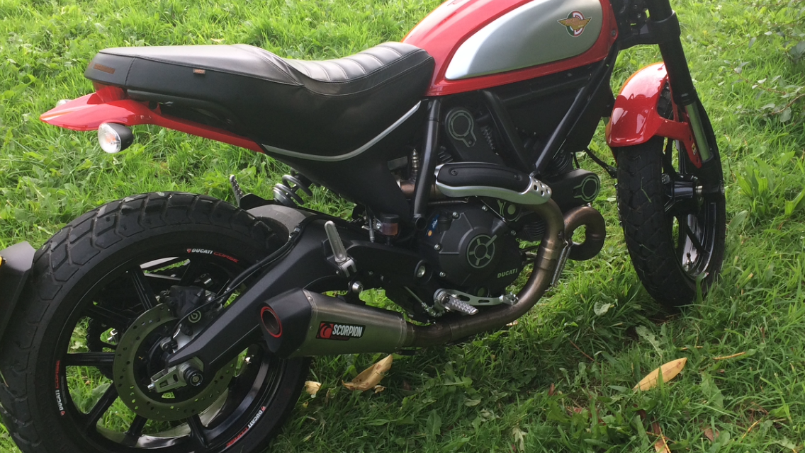

  6. fitted the exhaust earlier, took about 15 minutes, IMO it sounds much better, deeper and louder but not offensively loud, more like a motorcycle, less like a sewing machine :), and it's got that Ducati "boom" on the over run which is great , no difference in performance, maybe slightly less snatchy at low revs, hard to tell, overall I'm very pleased with it.
    PS I was surprised how heavy the stock exhaust with cat was, Scorpion say their unit is 4.6kg lighter.

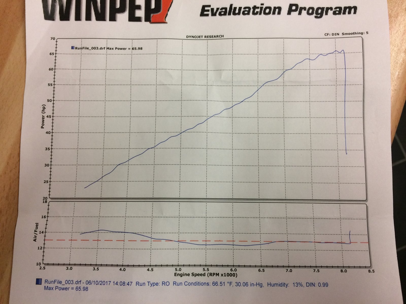

  14. 0495A0B5-40E2-4F13-8541-84111911E5F8.jpeg Had the bike dynoed at CMC, they said it was fine re mixture, tending towards lean but nothing to be concerned about, they said all the new Yams they had dynoed (they are a Yamaha dealer) were similarly lean.
    Note, the max bhp is measured at the rear wheel, Ducati measure it at the crank for advertising purposes, add 10% to the rear wheel bhp and it’s approx 73bhp which matches Ducati’s claimed power, although I’m sure they initially claimed 75bhp?, must’ve gotten a bit more honest since the VW debacle!.
