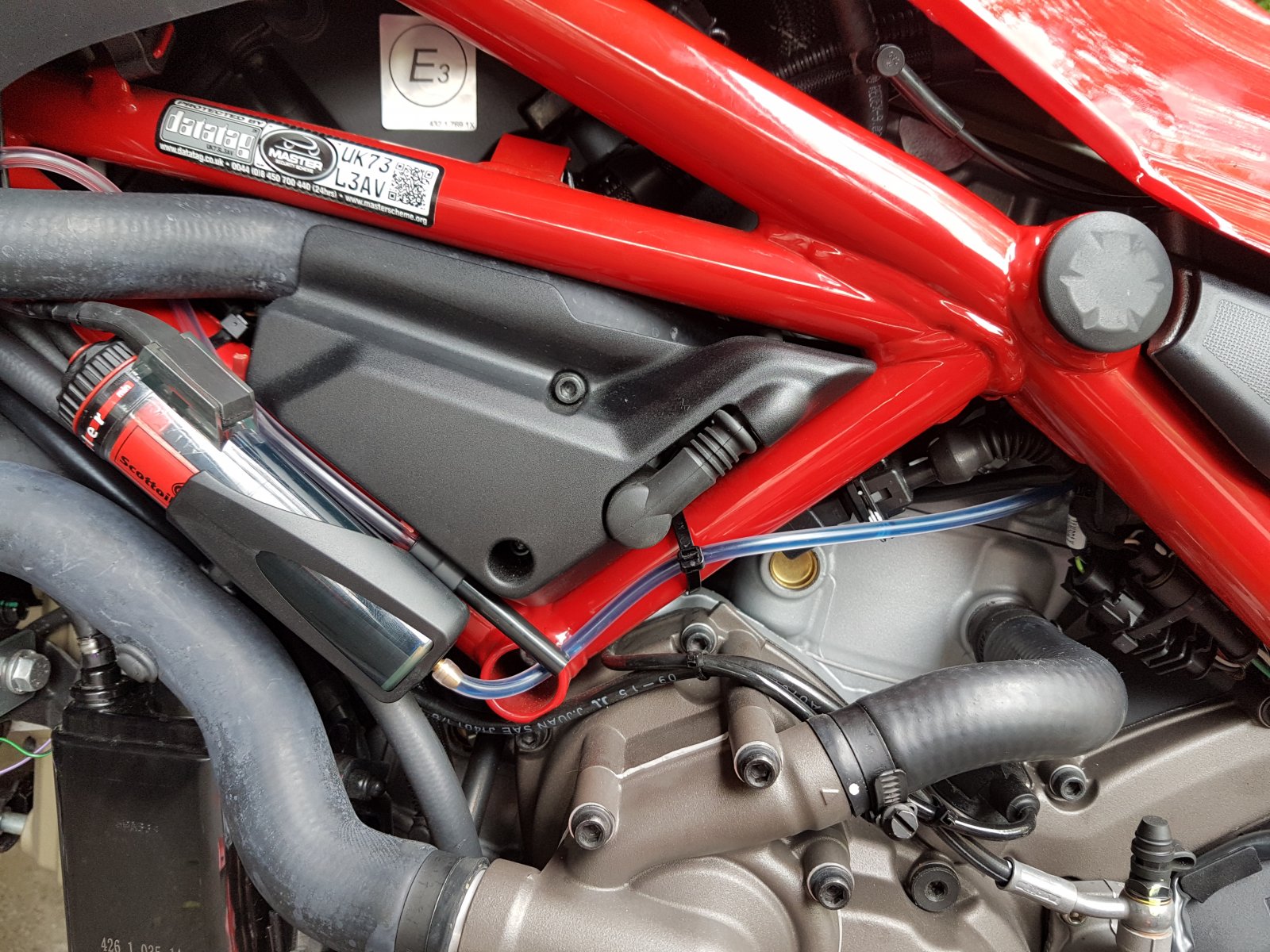

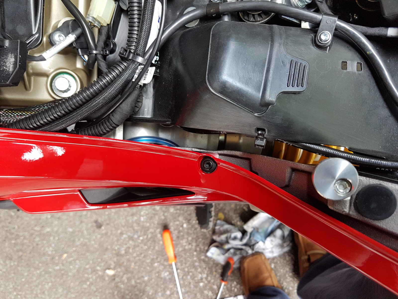

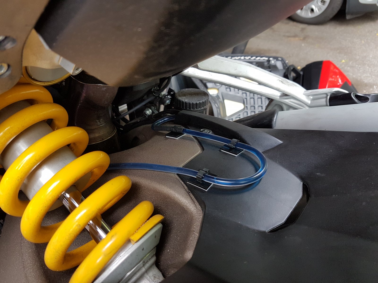

  2. Oops I did it ;)
    Will little disaster in the mean time but I did it.
    Works well- so far.
    I'm worried about high temperatures and delivery tube but we will see.
    Please see attached pictures.

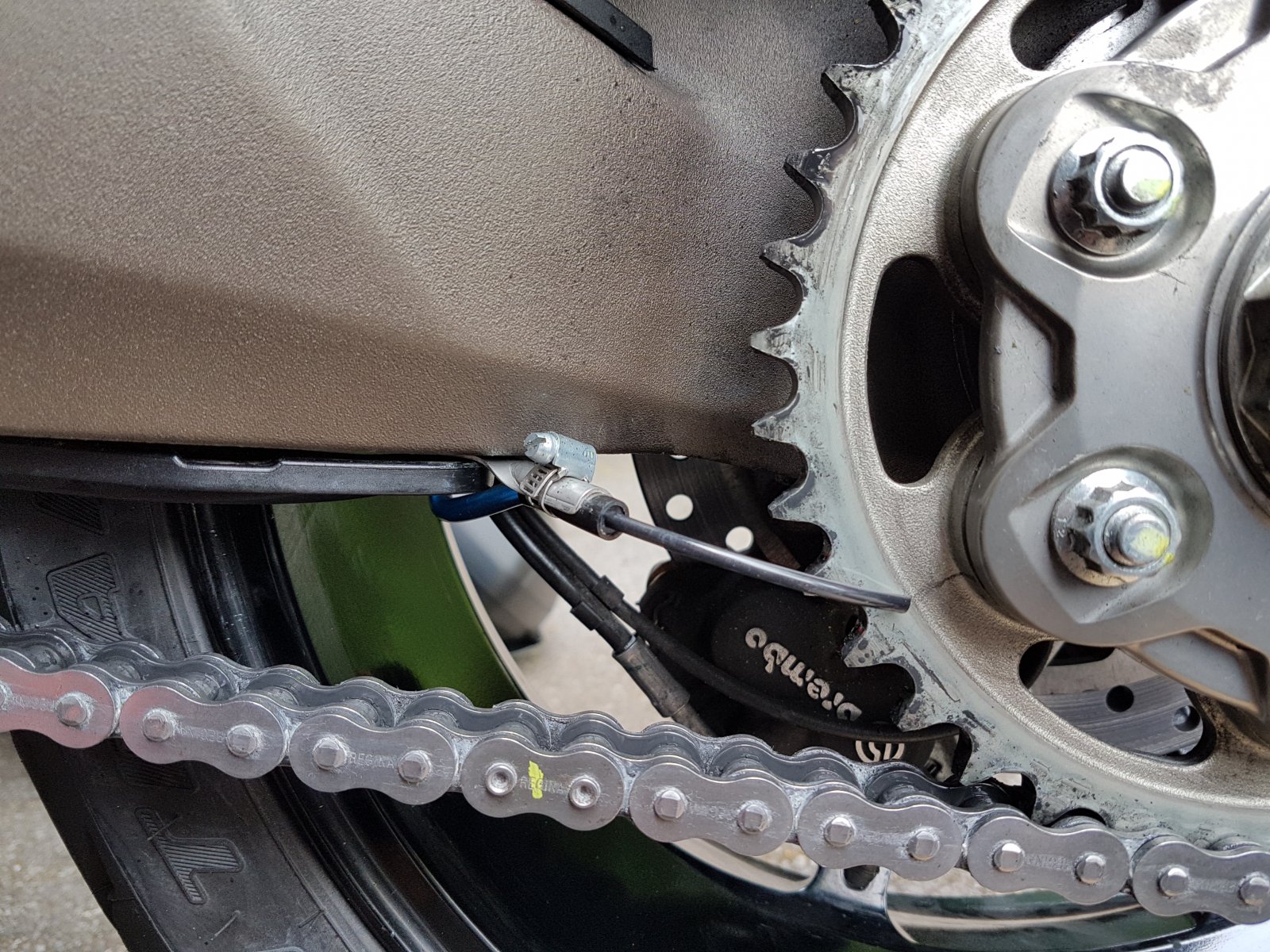

  3. @MacShot is that a dual or single feed in the picture ?
  4. Single:)
  5. If that's the case @MacShot shouldnt the feed go onto the centre of the chain rather than one side of the sprocket (just wondering that's all). I know nothing about Scott oilers.
  6. That's the Scottoiler recommendation.
    Oil is spread on the sprocket and centrifugal forces redistributing oil on the chain.
    As teeth of the sprocket have conical shape oil will dropped around the center of the chain.
    I hope this sounds about right.

  10. How strange, I've spent most of the day fitting my Scott Oiler!
    I went for the X system one.
    I've mounted it on the carbon canister and threaded the tube and cable up behind the relay cover, under the seat, down on the RHS coming out on the top of the swinging arm. I joined it to the thin pipe her and routed that with the other pipes and came out under the swinging arm. The nozzle holder bolts under the chain rubbing guard. Once the hugger is back on it hides all the fixing.
    The only thing I'm not happy with is the position of the lower oil feed so I might look at relocating it onto the frame.
    Pictures were taken whilst I was working out the routing, before I put everything back on and tidied up.

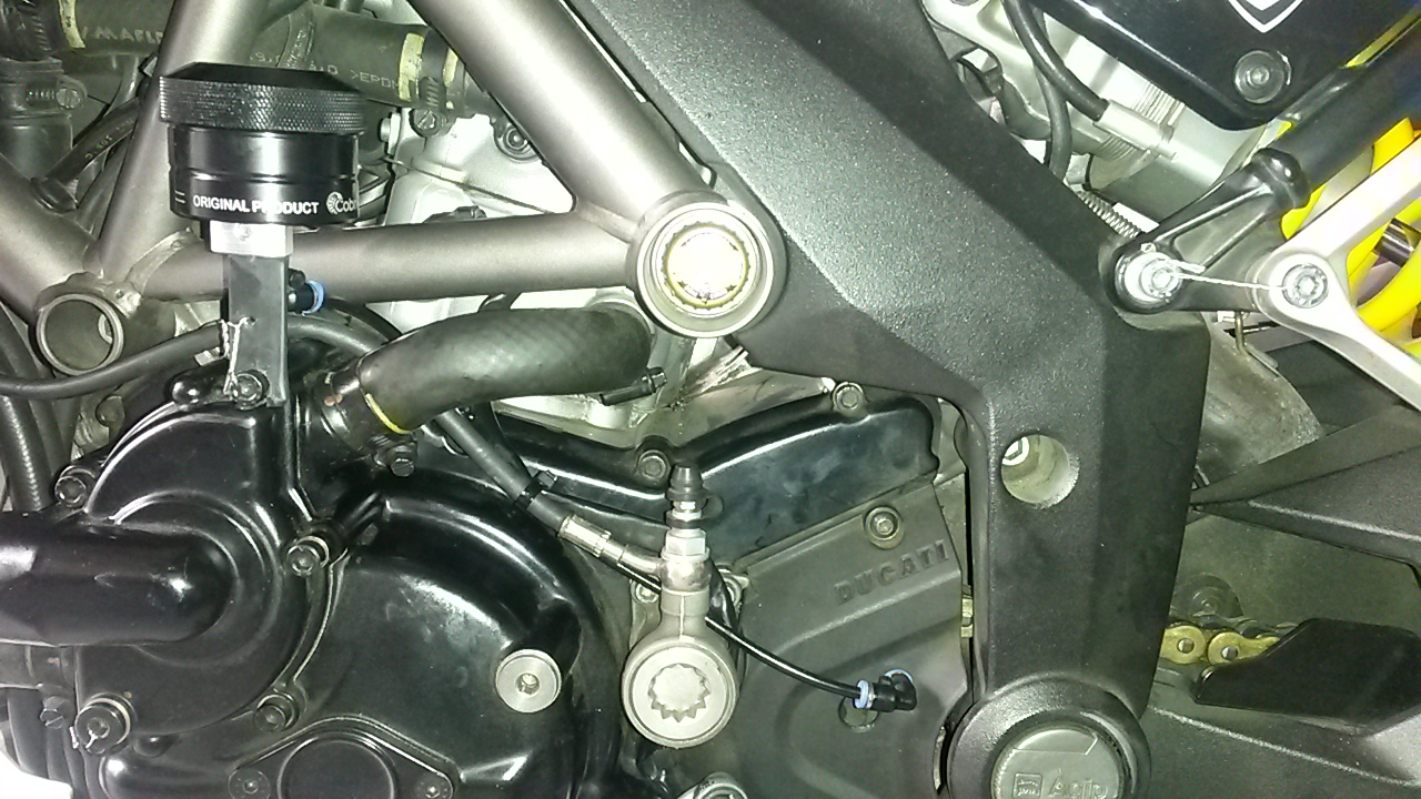

  12. I installed the Cobrra Nemo. It's a hydraulic system and I fitted the reservoir to the barbuster fixing.
