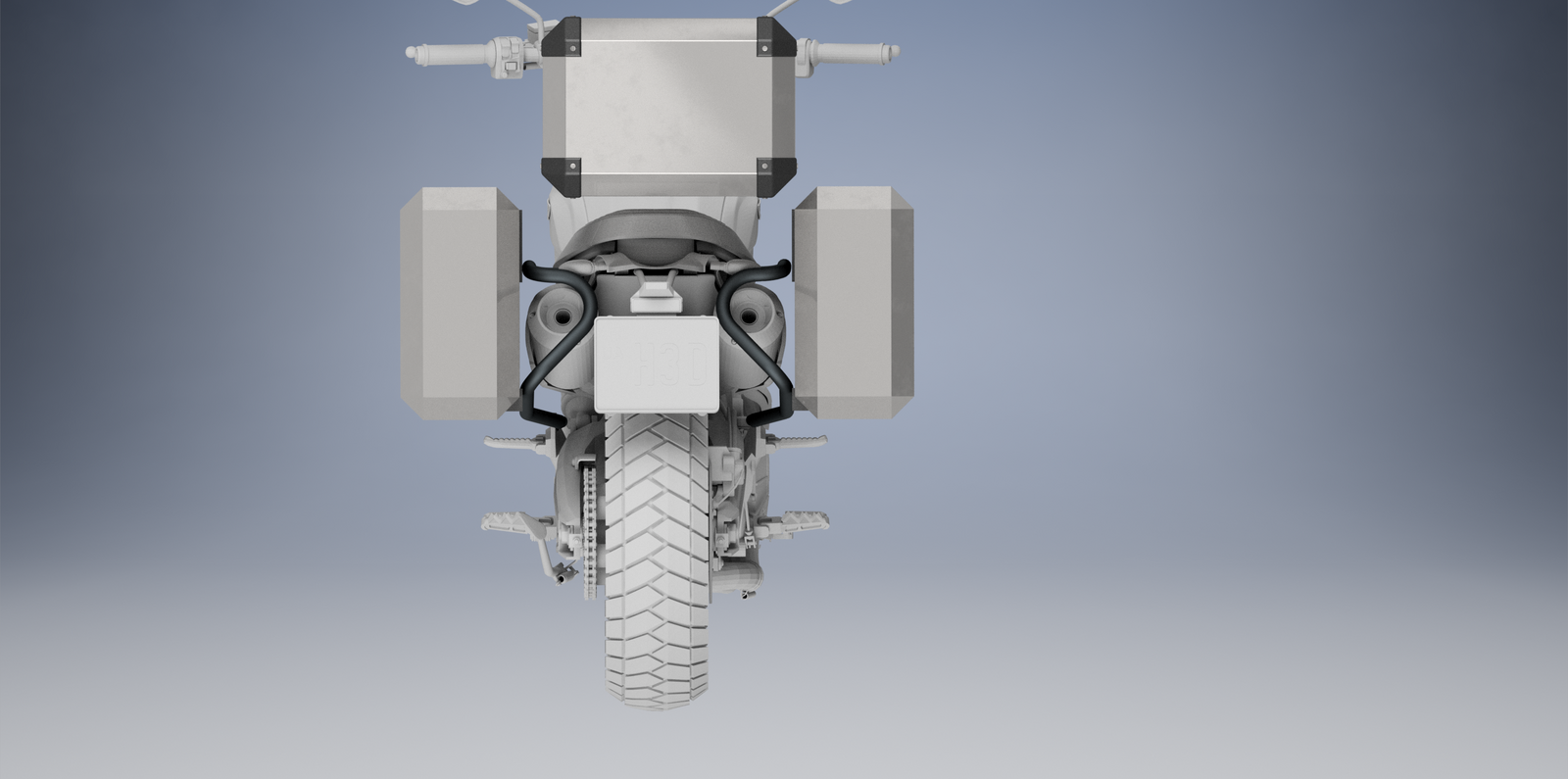

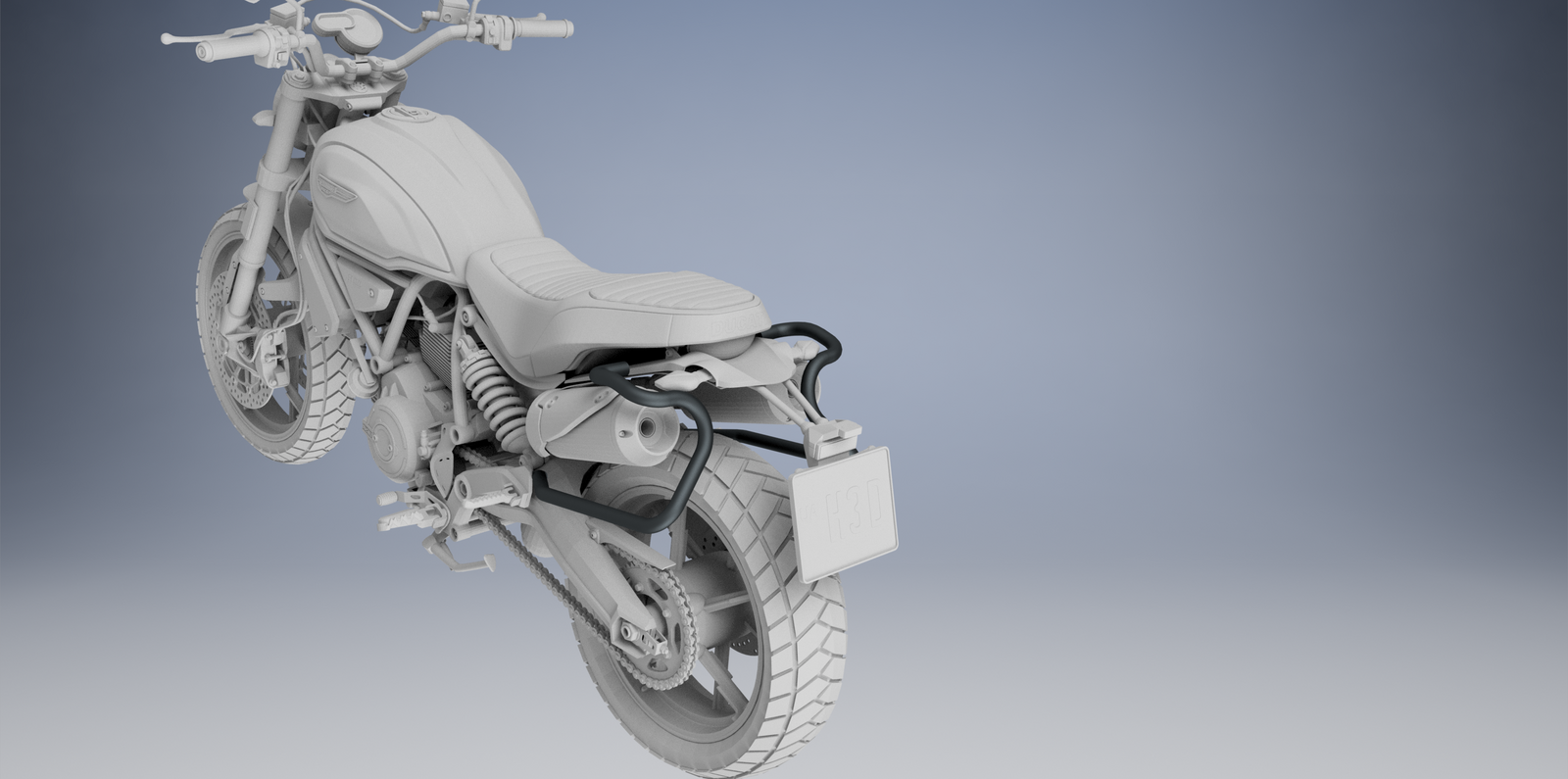

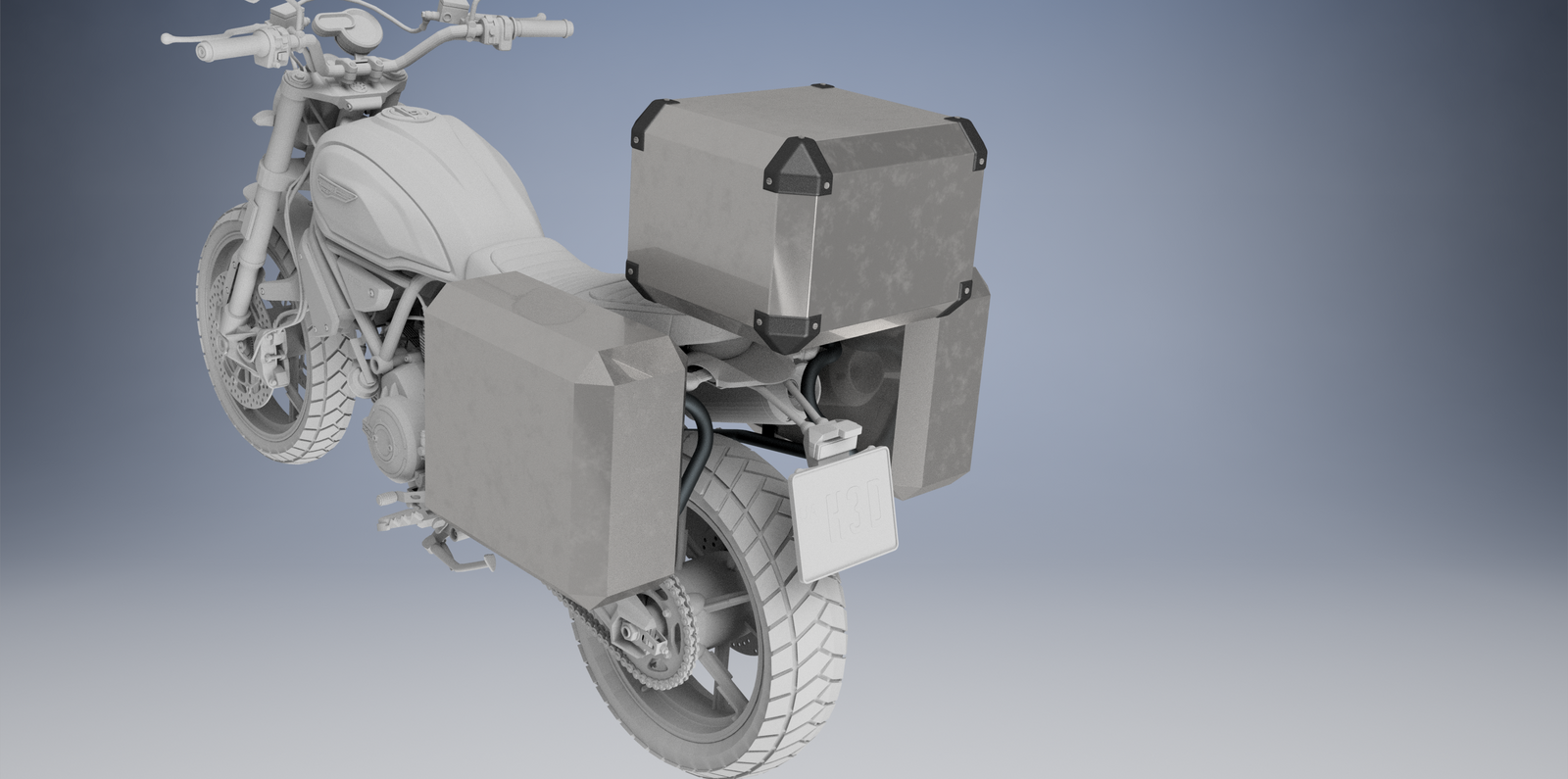

  2. Here are a few renders, pannier placement, frames and handlebar clearance (the final solution will also have a cross brace)

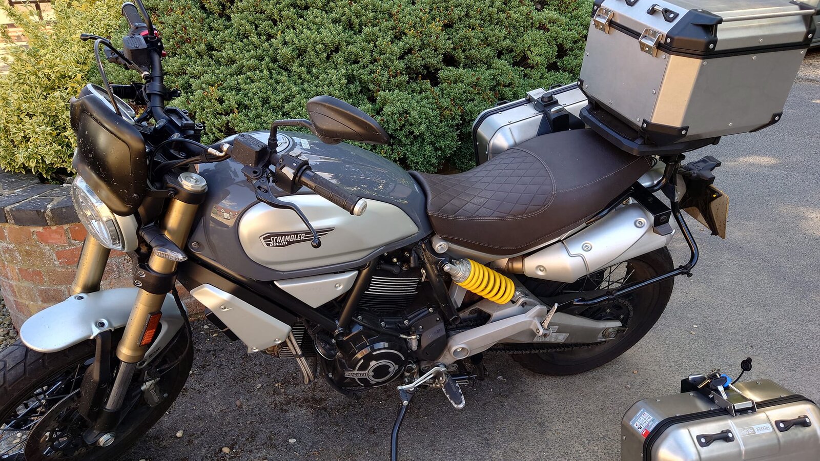

  6. Well here it is guys, final result of my custom pannier frames. They use the Ventura top box frames as a mounting point, and are very solid.
    300783948_10159009201800976_4464181533423236819_n.jpg 300519901_10159009201735976_3801973822436298619_n.jpg
