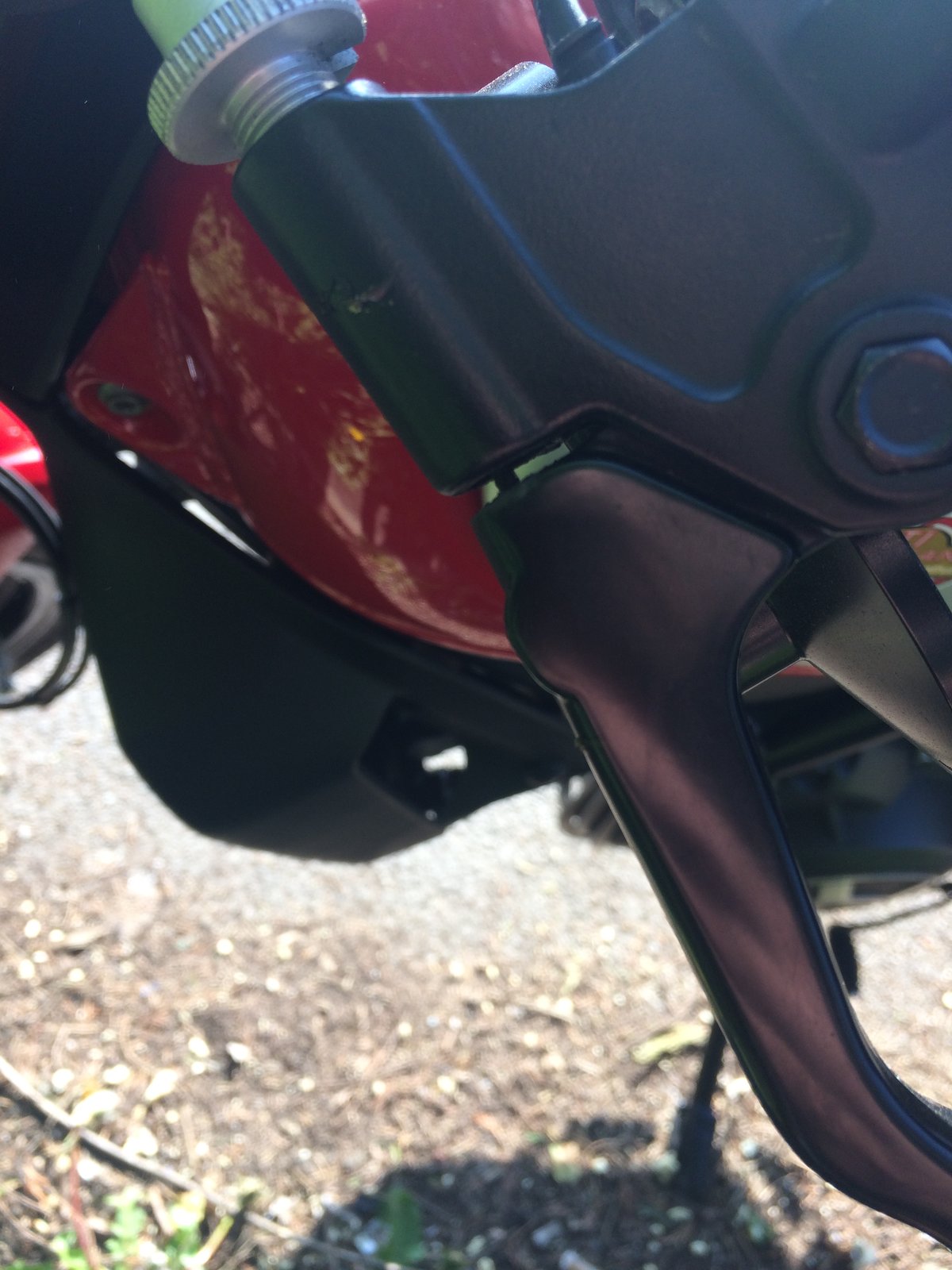

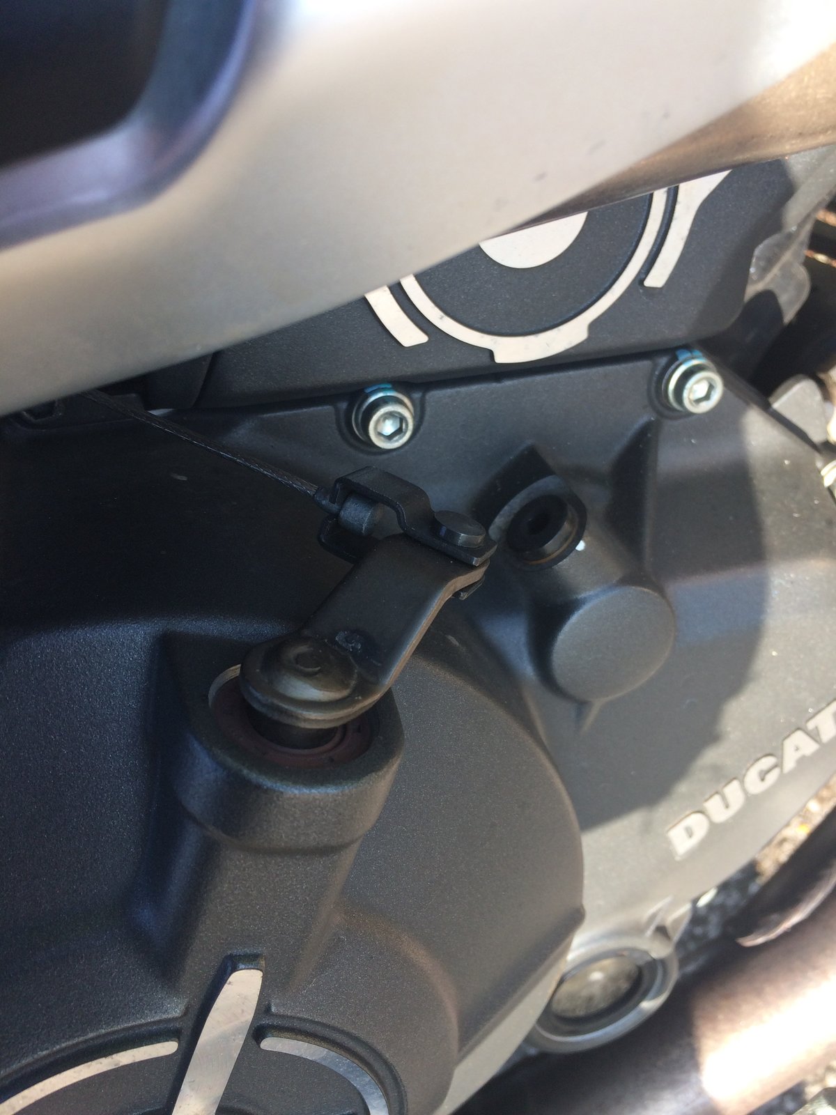

The clutch lever on the Scrambler does seem to be a bit of a stretch tbh, not a problem with my “spade” hands but I can see it being annoying for people with smaller hands, have you tried turning the adjuster on the lever, check that you have 2 to 3mm of free movement on the lever before it starts to disengage the clutch, you can see the gap between the lever and the boss in my photo, I’m gently pulling the lever and at the point you see in the photo I can feel the cable beginning to pull on the clutch mechanism, at the engine end check that the cable isn’t pulling tight on the actuator lever, you should be able to feel free play where the cable nipple holder is riveted to the actuator lever, not flapping about loose but definitely not tight, if you haven’t made any previous adjustments though I think you might find it’s correct/normal the way it is.
