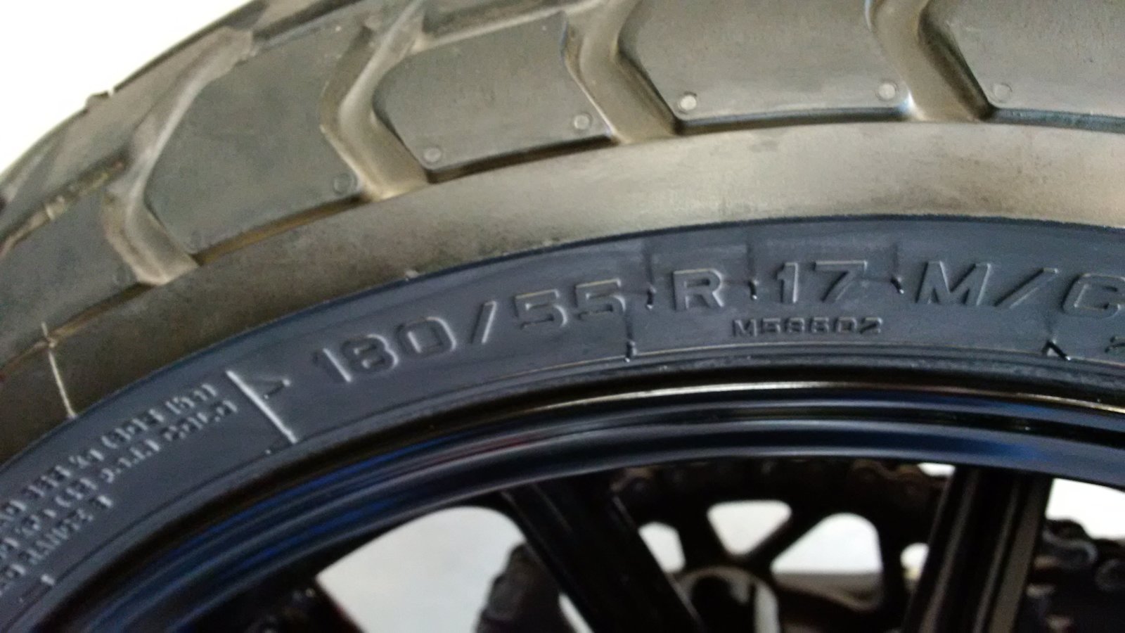

  9. Mine is 180 / 55 / 17
  10. Maybe it is a 180........I cba to check:)
  11. Just popped in the garage and checked they are 180 tyre on the FT & Cafe Racer still think the Multistrada would wreck the Scrambler tyre in no time if you could get one to fit

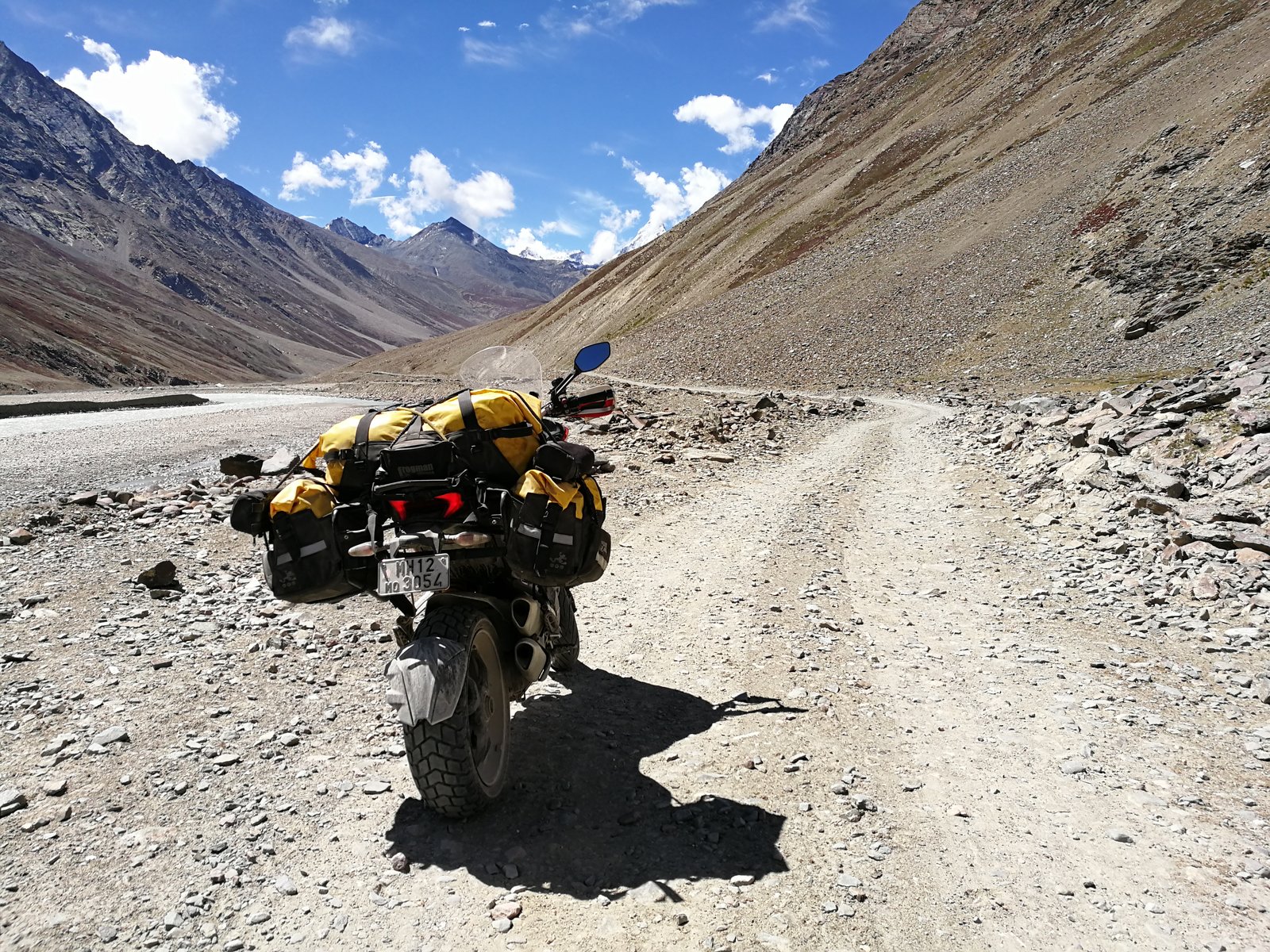

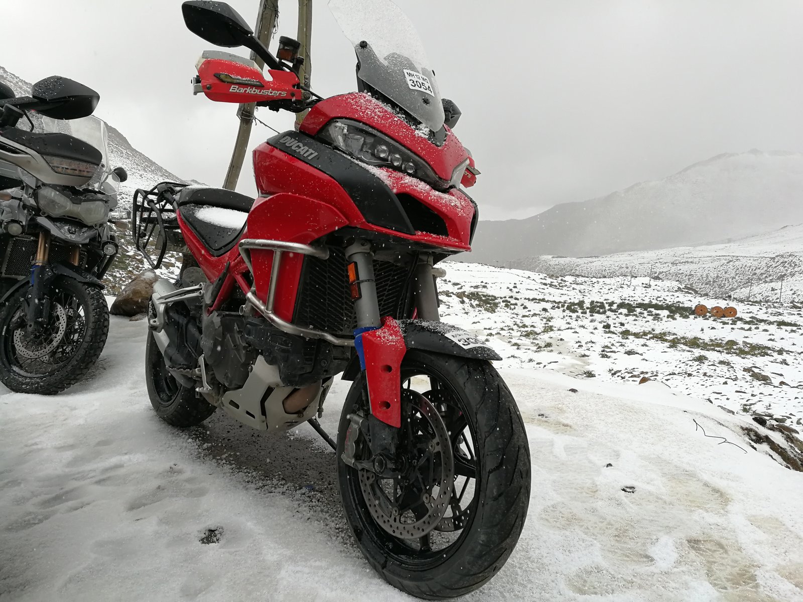

  14. Hi Folks,
    happy to report that the Ladhak and spite trip was completed successfully on the multi, a total of 6300Km in 15 days. the highway stretches of pune to
    simla and the return from IMG_20170903_102619.jpg IMG_20170903_102619.jpg manali to pune were about 4000Km. rest was mostly offroad gravel, stones, mud, sand, snow and river crossings ( actually 118 crossings, yes we counted)
    I used the M7rr I had on to get to delhi, as I wasn't sure that the scrambler rear tyre would survive the fast highway journey. and swapped to the scrambler rear before moving on.
    The tyre did really well on and off road, had zero punctures or tears and the bike was planted at the back. the front was another matter especially on the ice and snow that we got on the 5000m passes.
    eventually I returned to Pune on the scrambler rear tyre on, and so after about 4300 Km the tyre is still in good shape with a 3mm tread left on it.
    The other multi that we had along was on the stock Scorpion trails, which were shredded halfway through the trip, with 5 punctures in it. we had to pump it up 3 time a day, we finally fitted my old M7rr on it at Leh for the return journey.
    thanks every one for all the help.
    Some pics are attached
    cheers!
