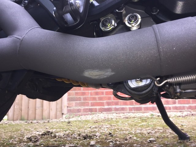

  8. First run out of the year last weekend and felt the bike fighting me when cranked over. Anyhow had a look when I got home and lo and behold this little bu**er was looking at me!
    Any ideas if it will affect the rest of the coating or should I look to get it covered?
  9. Screw a hero blob into it

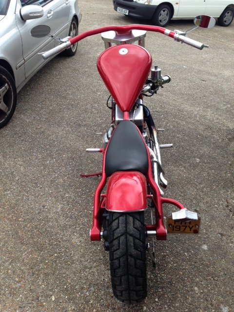

  18. My non Ducati "other ride" has an exhaust that runs straight out of open headers so no problem with grounding but I worry about catching the handlebars sometimes on really tight bends? image.jpg
