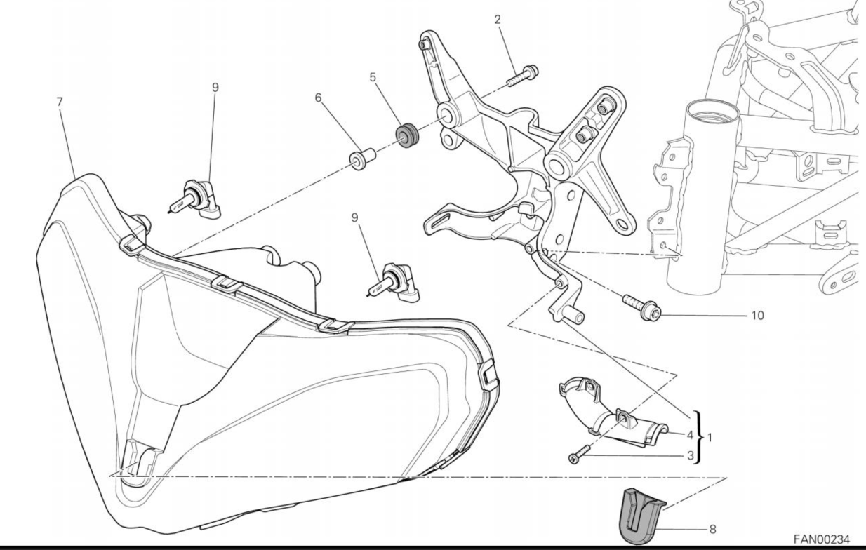

    I’m new to Ducati and have a lovely 1200S 13my. Does anybody know how to stop the nose fairing (screen and headlights) from wobbling. It’s fine on smooth roads but moves a lot on anything not smooth (most UK roads!). Everything looks tight but it’s obviously rubber mounted. Any help greatly appreciated.

  5. Update. Taken the plastic off both sides to see the fixings for the nose fairing and found that the bottom bolt that attaches to the headstock was quite loose. Fiddly to get to but tightened it up and it seems a lot better. The screen still moves a bit but not as bad as before.

  12. I saw you found a loose screw, I can confirm that I can't move my headlight fairing by hand and wobble the dash. I'd check that the gold frame between the headstock and the front dash looks okay and isn't missing anything. That supports the headlight.
    Also you have the 2013 model where they changed the screen mounts so the guide for older and later bikes might not apply exactly the same.
