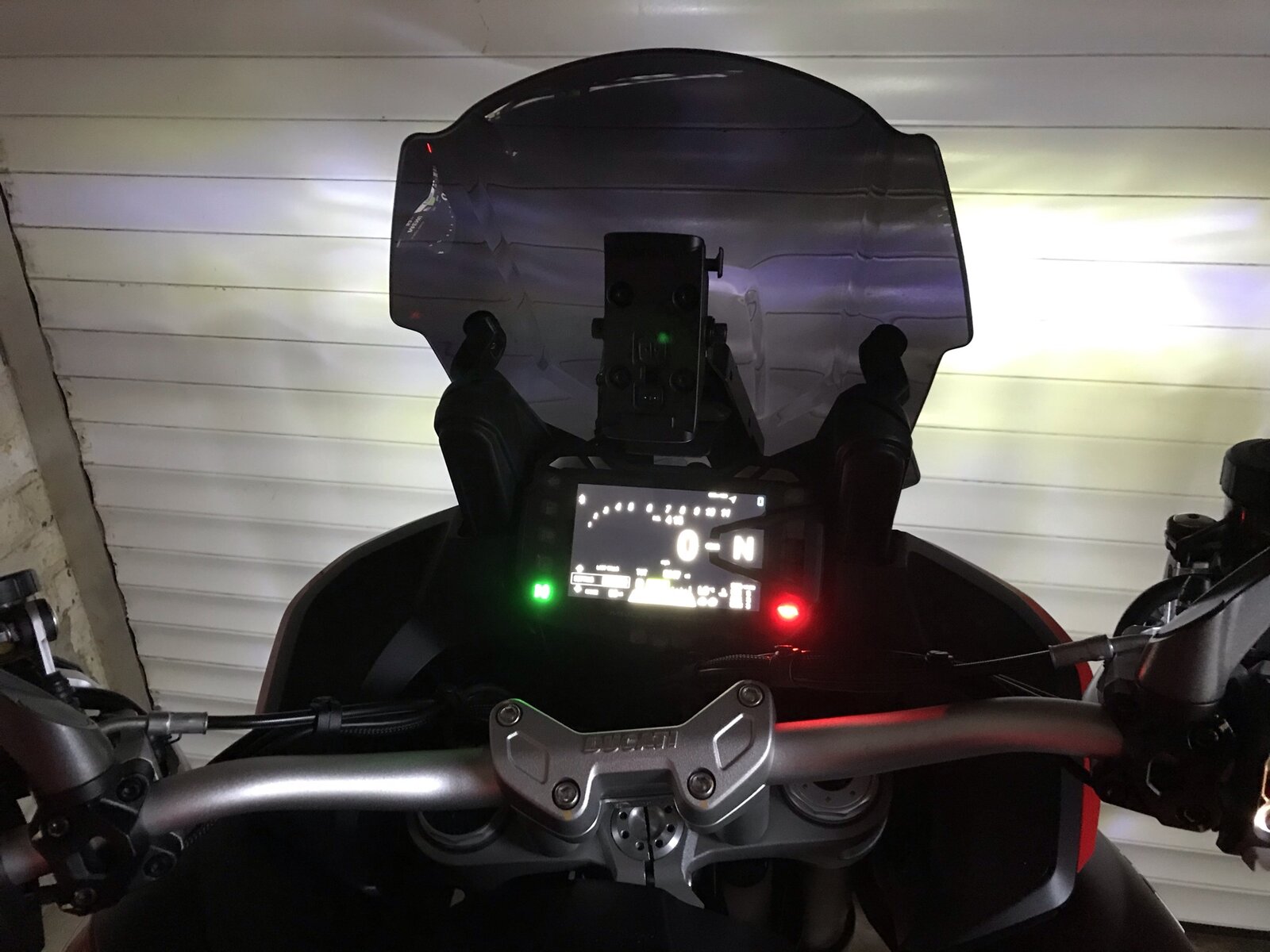

  9. This is the 7622f dark screen hope that helps

  12. I’m 6’ and found the smoked Puig sports screen is perfect to look through. Also using the Palmers adapter on full tilt forward as this provides the best option for wind deflection of all the positions available for me
