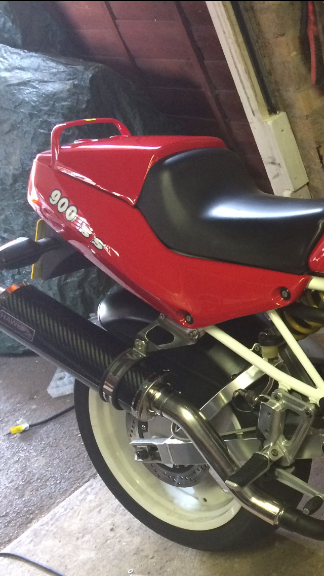

  5. Mine fits as below, just touches the grab rail but only lightly
