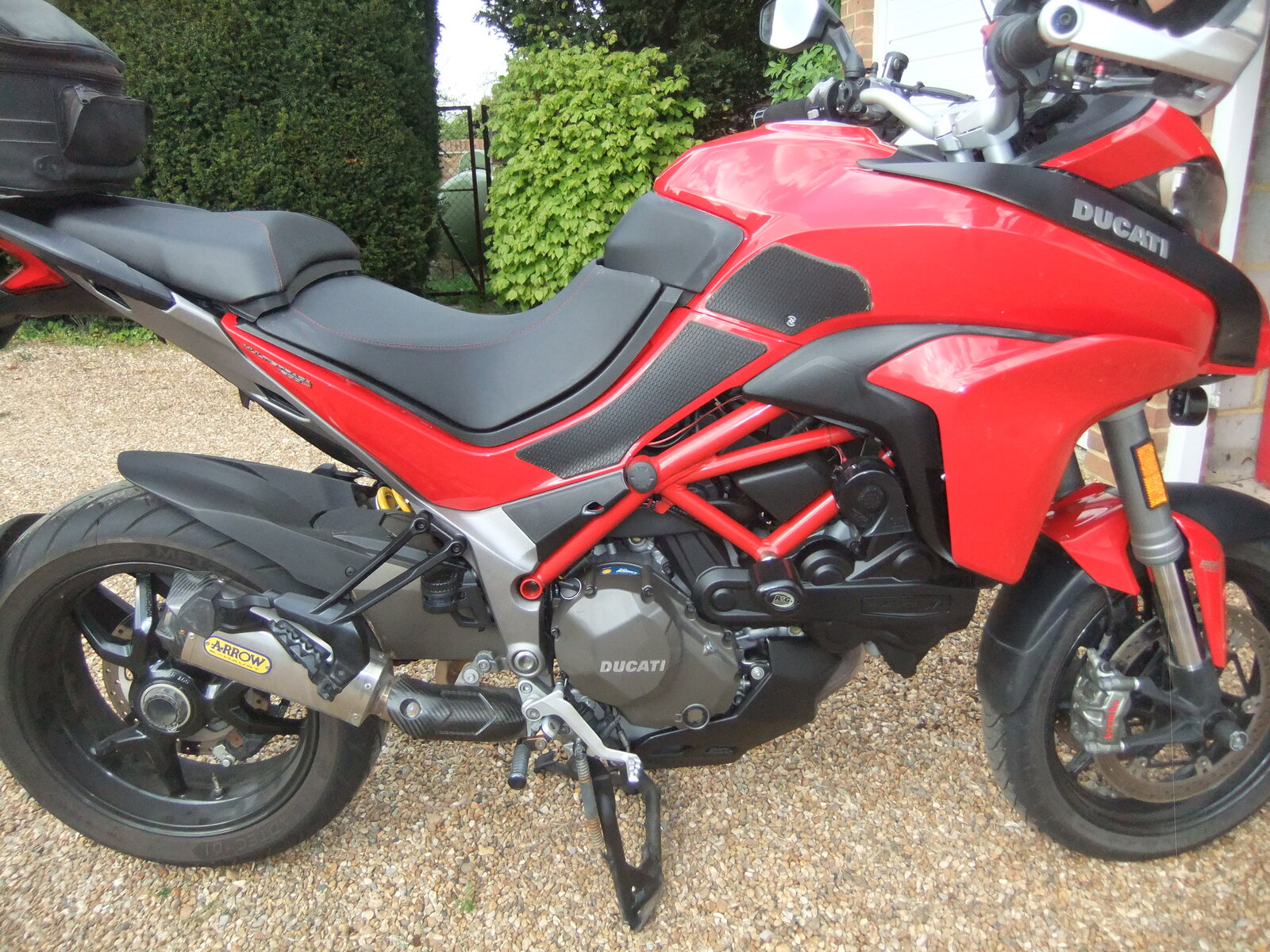

  2. go comfort seat
  3. Cheers, I take it that it flattens the seating position out?
  4. MrACD. I know what you mean, you get pushed into the tank by the sloping seat.

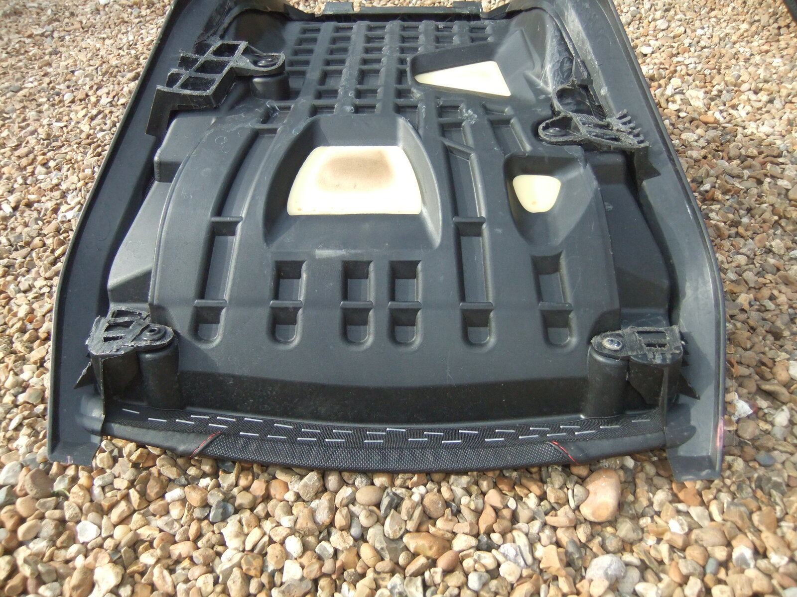

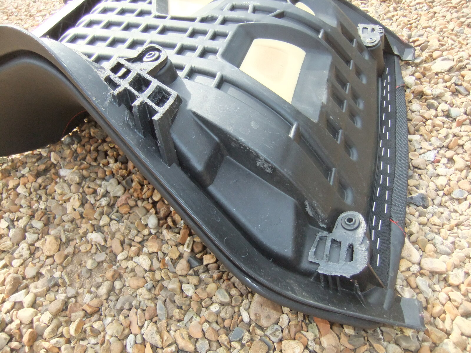

    The raised seat doesn't solve the problem of the sloping seat. If you are brave you can do what I did and you end up with a flatter, more comfortable, seat, and very much less expensive than a replacement seat.
    I fit the raised seat spacer kit, but first cut the rear spacer blocks flush, as low as you can get. I cut mine off with a hacksaw. Not pretty but nothing is visible when fitted. That had the effect of the seat being higher at the front and lower at the rear.
    You will end up with a small gap between the front of the seat and the tank. To fill that gap I bought a strip of generic car door seal with a sticky tape backing. But more importantly, you end up with a seat that isn't constantly trying to crush your nuts. I have ridden thousands of miles, and sometimes hundreds of miles a day (750 miles being the most) with no butt or nut problems.
