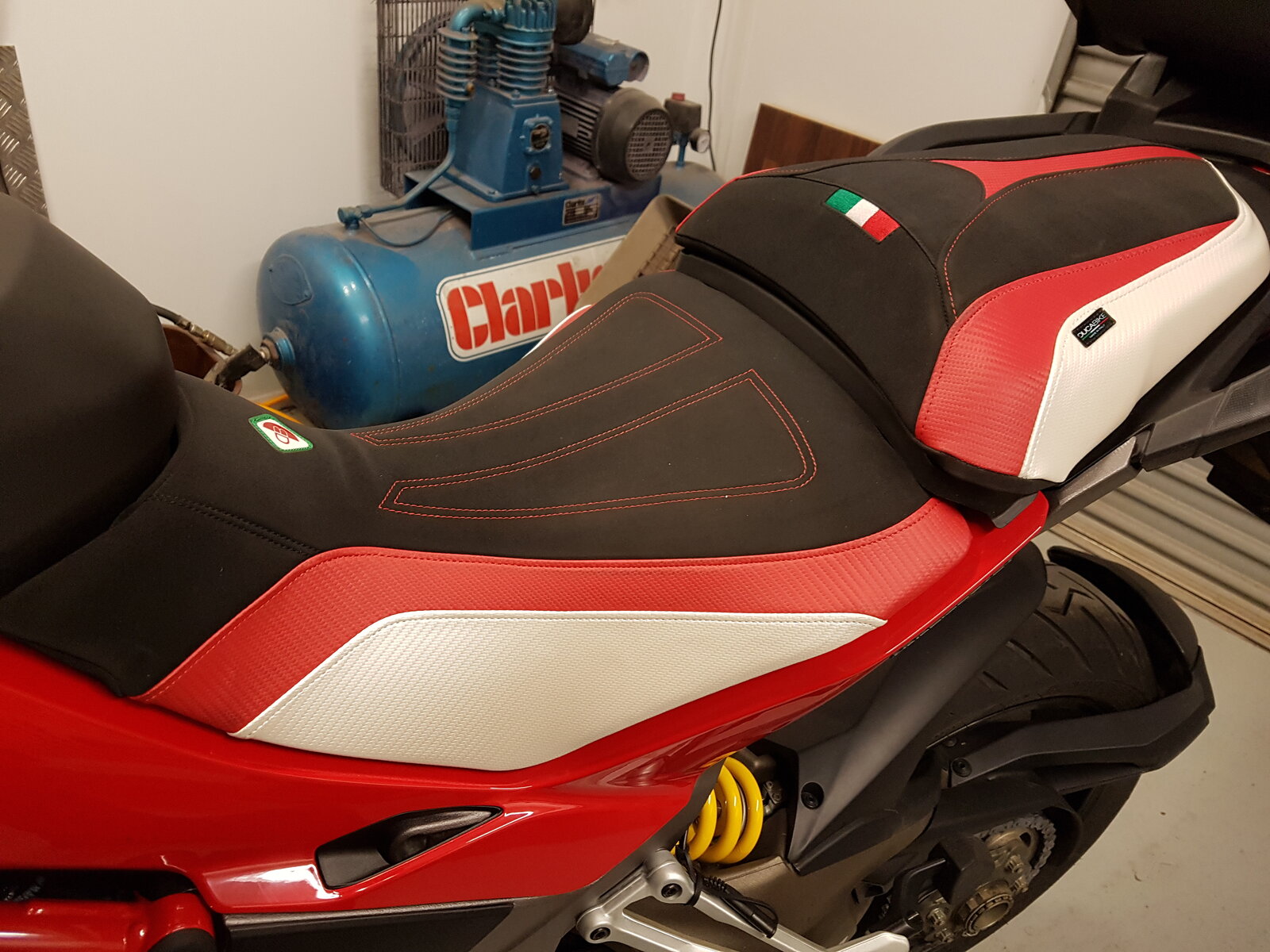

  3. Saxon seat covers are really nicely made bits of kit. I have one specially made to my design on my Pani.
    You might like to call the guy that runs it to confirm it but this is what he recommended to me. He’s a very helpful guy and I visited him so there’s no misunderstanding here.
    1. You can put one of their covers over the original cover but it will make the seat harder. Better to rip off the old cover and replace it with the new cover. You can do it yourself or I’d recommend finding a local friendly upholsterer who can also put in an extra layer of foam for you. Because....
    2. He said to me ‘You can put a Gel pad in but you will fry your arse!’
    The underseat exhaust pipes will heat the Gel pad more than foam. It will also retain that heat more than foam. I was disappointed as I’m sure you are, I had also promised myself a Gel pad. I took his advice so I cannot give you first hand experience but now I come to remember he said it would turn it into a frying pan.
    Maybe others on here can comment if they’ve used a Gel pad. On a Scrambler it’ll be fine but with underseat pipes he said it was a no-no.
