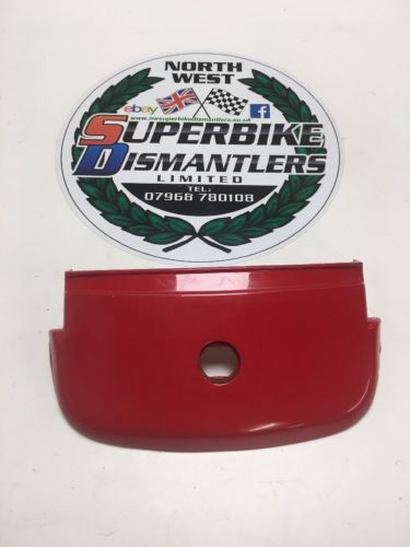

    Beware that all 600-900ss carby seats are not interchangeable. The seats with the 'pin' mechanism to attach them to the lock are longer than the ones with the 'bar' mechanism. I have been caught out with this one. The 'pin' lock plastic is shorter to accommodate the longer seat and therefore does not fit both sides of the handrail. I have uploaded a picture of the later type
    Also, the very early 1991 seats are too 'plump' to allow the plastic pillion seat cover to fit (well mine is)
