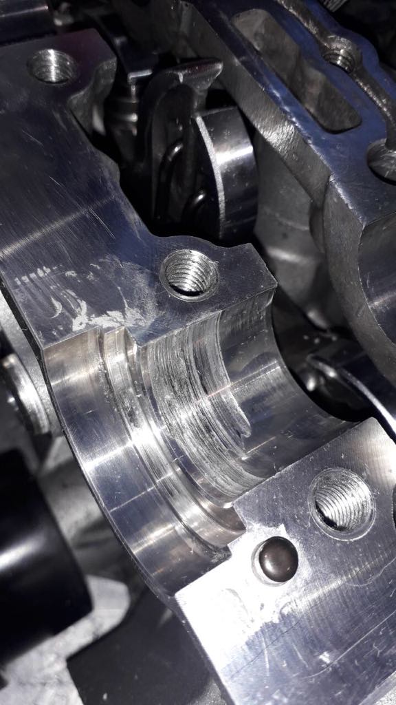

    Recently I've bought my first Duc and it is 1098s tricolore with almost 12k km on a clock. After just about 70-80km brought my bike to the Ducati workshop - changing belts, checking valve clearance, changing tires, oil, oil filter and checking if everything is ok with it. After that they said that it truly is in a very good condition and when I was riding back home after 15km belt on a horizontal cylinder broke up. So they took it back. Bent valves, scratched head (see picture). Piston was intact, no marks from valves. They had spare complete head, put it on, new belts and a head gasket. I took it back and made another 10-15km with the same ending - broken belt (yet don't know which one but I suppose that it is the same).
    I need an advice. Has anyone had similar problems? Is it lubrication? (oil light was ok when I was riding) Maybe you've got some ideas what to check next? I think that service at some point was done wrong and that they should pay for it.

  2. By the looks of that bearing journal the camshaft seized. So it looks like a lubrication issue - but on 2 heads!

  5. I don't think it's a belt fitment issue. Tensioning the belt incorrectly could cause it to break but I wouldn't cause that damage to the bearing journal.
  6. Low oil pressure possibly, maybe due to a worn pump, or a blocked oil feed to the affected head.
