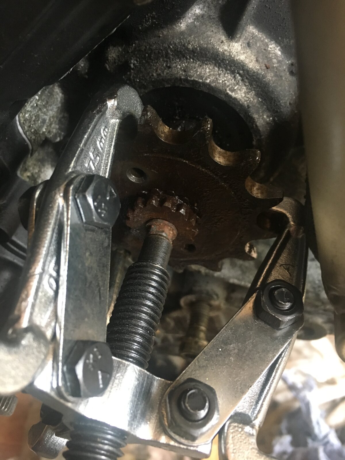

  1. No way can I get the fecking thing offo_O, it’s seized solid. Corroded to the shaft I guess:(. All suggestions as to how to unseize and remove it are very welcome please.
    The bolt head you can see between the sprocket puller central screw and the gearbox output shaft is there to prevent the sprocket puller pushing down into the central hole in the output shaft, which it was doing:(.
    TIA
    ps. Judicious amounts of penetrating fluid have already been applied over days to the sprocket/shaft join.
  2. Heat, then douse in ice-cold water?
  3. Heat is your friend, but be aware of possible seal damage behind the sprocket

  5. You may get a better (more square) pull by using 2 bolts in the sprocket holes and jacking more directly off the shaft? The 3 legged pullers can easily go off square and you end up stripping the puller thread - ask me how I know....

  7. Don't use the tapped holes, they will strip out
    A hydraulic puller and a bit of heat will do it.

  8. If the splines are worn, they could be holding it on too. Put it in gear and tap the sprocket left to right

  9. as above, heat the sprocket only and let it creep to the shaft and check or douse shaft behind sprocket occasionally with WD etc bearing seal in mind. I'm guessing you are not worried about saving sprocket? after or as well as careful heating, a light to medium hammer tap on sprocket extreme towards engine alternating 12 oclock/6 oclock etc will definitely do it eventually.
  10. Cut a section out with a dremel. Had to do that a couple of times. Molypaste when you fit it back.

  13. With the puller pulling tension on the sprocket - tap the puller with a hammer to shock the shaft.
    If that does not work - and you can gain access - carefully using a cutting disc on an angle grinder cut from outside in - may be worth fitting something behind sprocket to act as a stop if you get pulled in.
    Then cut as near as you can -
    Then try puller again
    If that does not work - then use a chisel to split the sprocket... but the issue is the load is taken by the shaft for every impact... so important to cut as close as you can..

  15. I’m going to apply some heat to the sprocket tomorrow (although I can’t help thinking that’ll cause the sprocket to expand and tighten on the gearbox shaft) then start tapping the sprocket with a hammer to see if I can break the rust seal between sprocket & shaft.
    I’m also going to apply some Frost’s Rust Remover to the sprocket/shaft join and see if that’ll dissolve the rust.
    Failing which, Ill see if I can, with the Dremel, carefully cut through the sprocket so I can split it and get it off.
    I will report back.
  16. Got a puller on it at present but the more I tighten the puller the more the central bolt just pushes into the hole in the gearbox shaft:(. Nature’s welding has truly taken holdo_O
