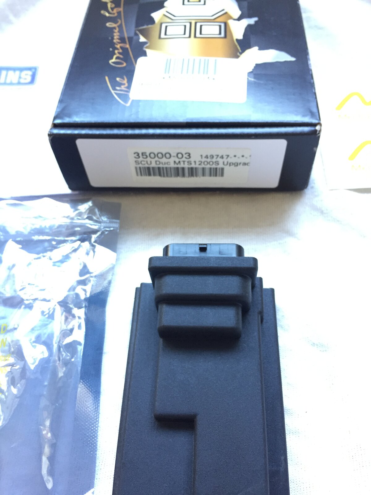

  8. Does it look exactly like my one has to have square plastic back and not radiased edges
  10. That one above is standard
  11. I will pop the side panel off when I can later and have a look.
