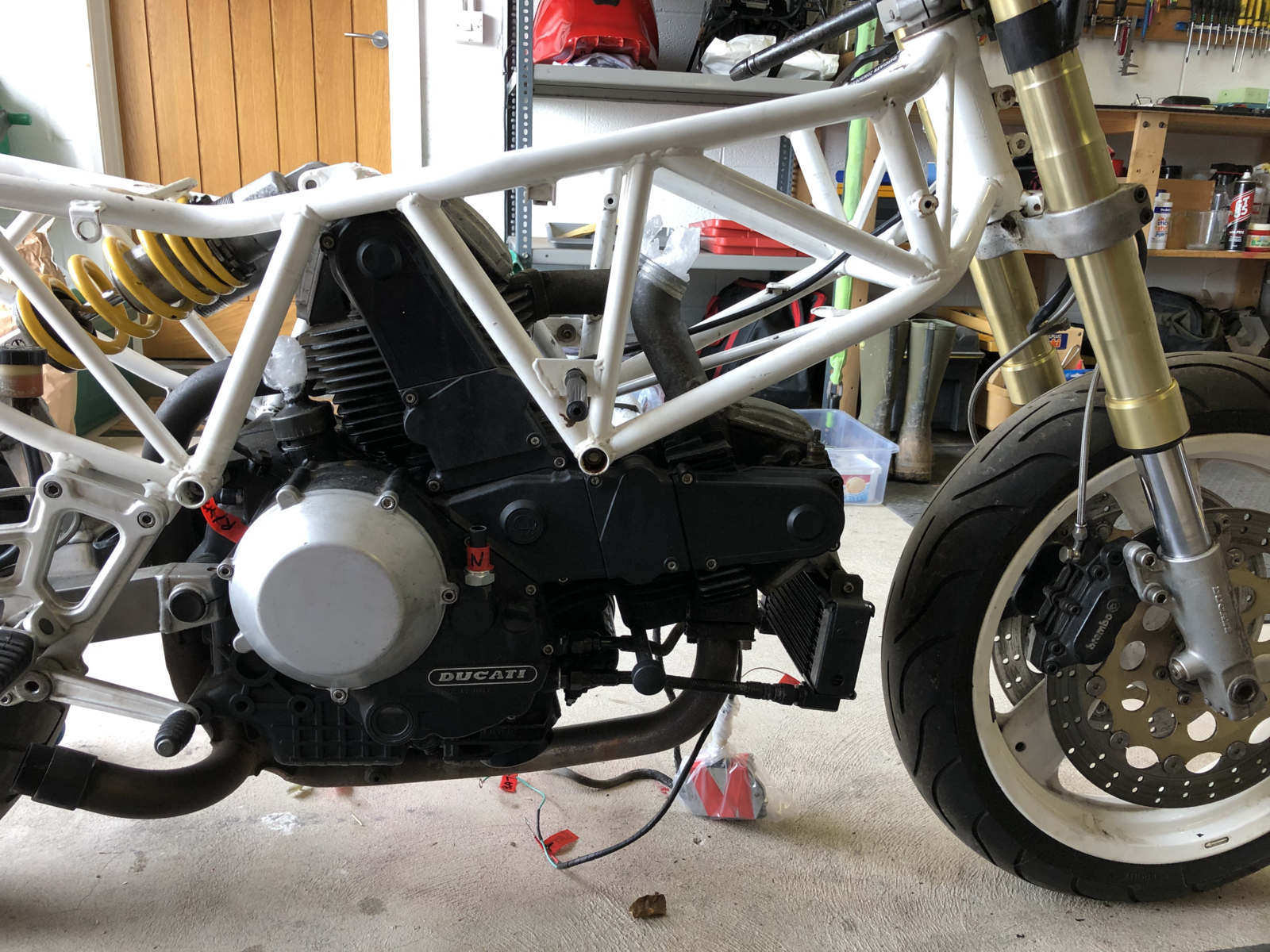

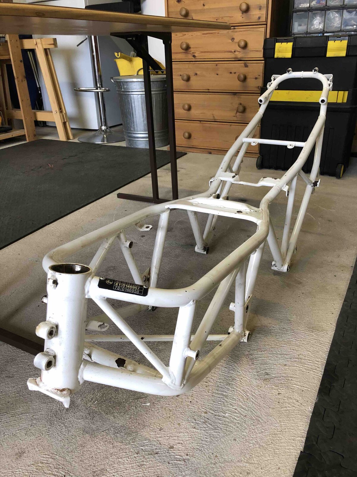

  3. IMG_3351.jpg IMG_3352.jpg Progress has been made. The engine has been removed from the frame without drama . Discs have been removed and wheel bearings removed . Bearings weren't so easy to remove ended up using expanding rawlbolts to grip the spacers to drift them out on the advise of a fella on the 900ss facebook group, worked a treat. So next week frame and wheels are off to be powder coated Traffic White. In the meantime I going to degrease the engine and the strip the top end, see what it's like. It may be 944, it may have high compression pistons , we shall see when i take it to bits.

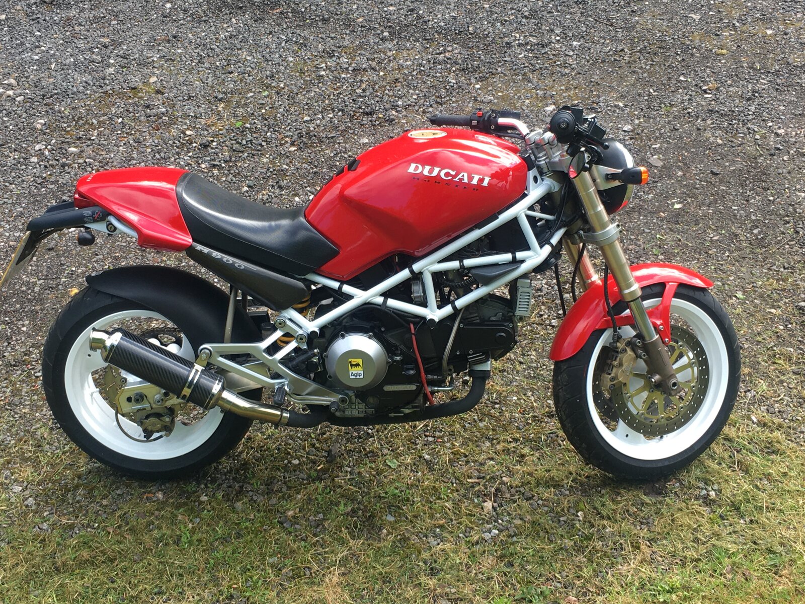

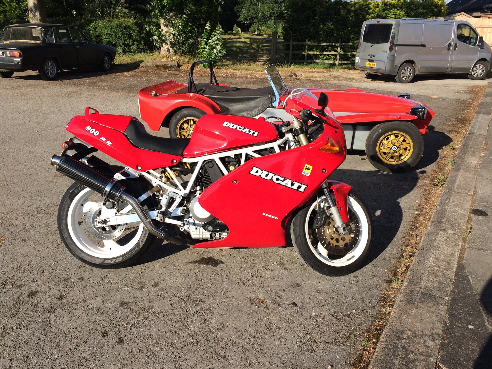

  6. You can’t beat a white frame, I’m not biased btw 4553F6C3-3FBF-405C-95F0-F919829D528E.jpeg CD7B02DB-9649-4347-BE06-93CC34D49B78.jpeg

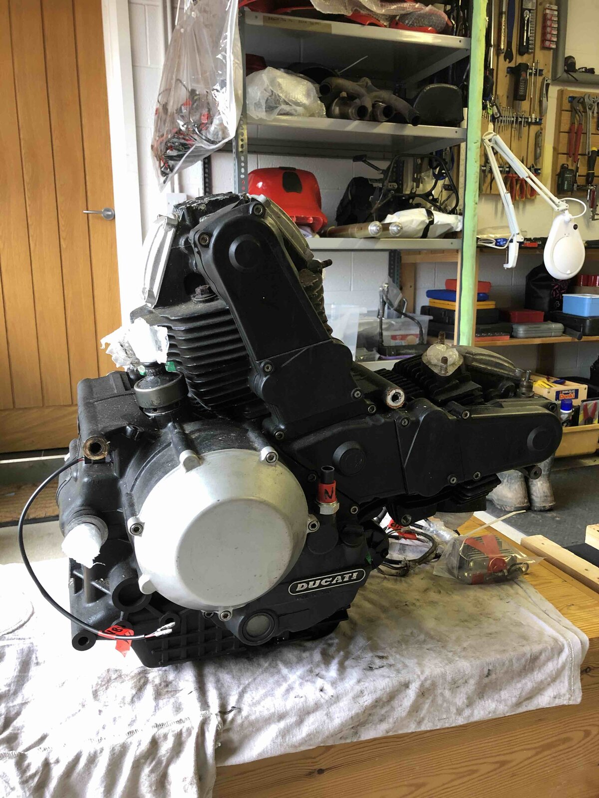

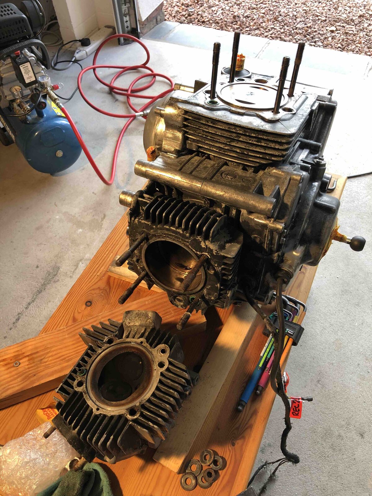

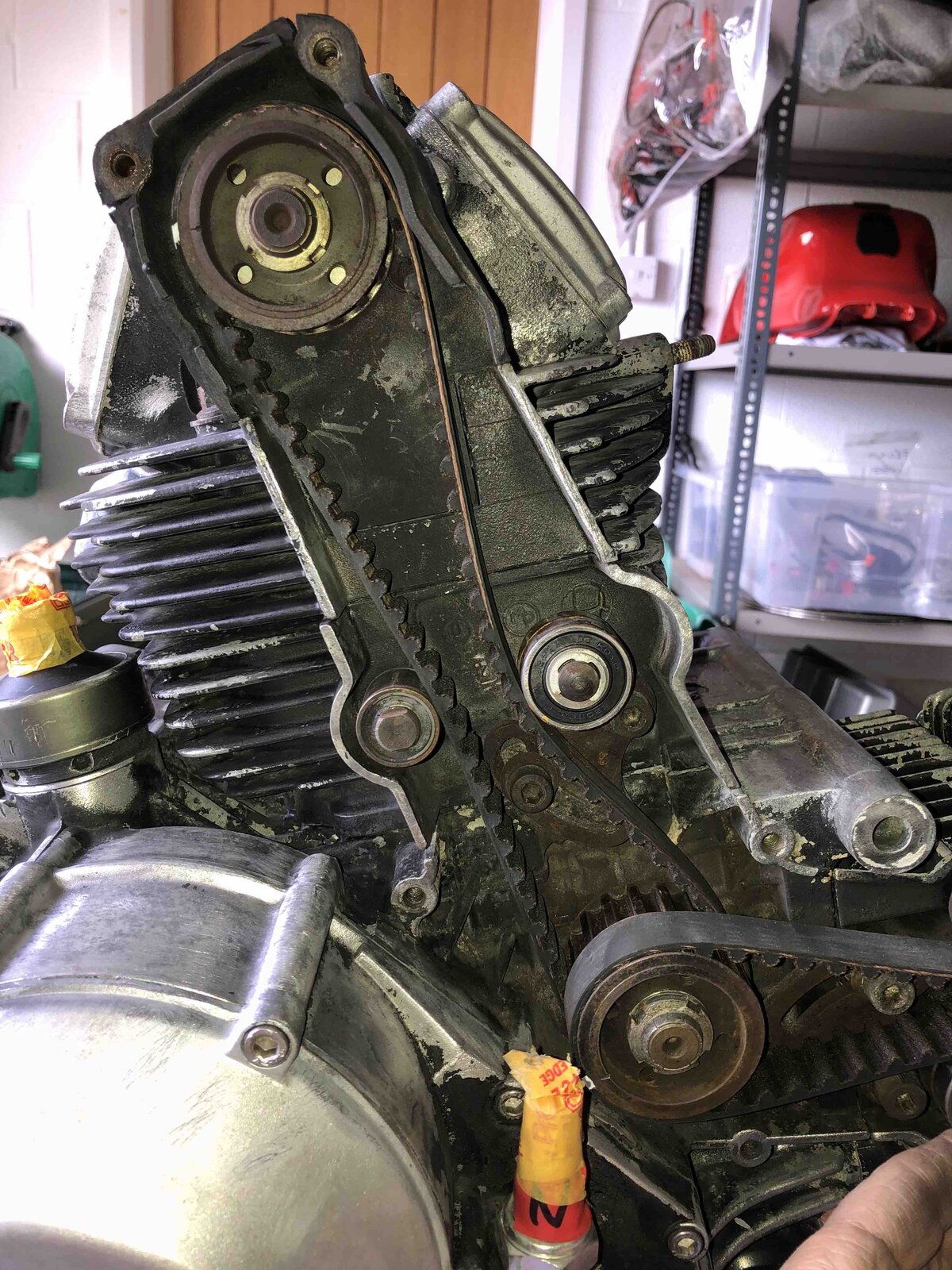

  13. Busy weekend....... got the grotty looking old engine cleaned up , degreased, washed, wire brushed and dried. All the flaky paint has gone so time to take it apart . Cambelts are off and the cylinder heads too. The bores look good , I think the studs are original so probably best to replace them. Next job barrels off and check the rings. I think I might send the heads to someone to do the shims, check the valve guides , valves etc ...... anyone have any recommendations ? IMG_3390.jpg IMG_3371.jpg
  14. Paul,
    Head work - Chris at
    http://www.cjsracing.co.uk
    Think most would agree. Had mine done a while ago presume still going. Bristol area.
    Cheers Gaz

  17. Thanks, good to know. Now I've got the barrels off I'm pretty sure the studs are ok. There not the shiny stainless variety so I think they will be ok. I'm sure there will be a whole load of other bits I will need so thanks for the heads up on the discount and I'll be in touch
  18. Its the later engine but registered 1991. Its painted black currently and I think i will paint it black like the mag cover
  19. Thanks Gaz, gonna send the to John Cellier in Leeds. Spoke to him today. top fella
