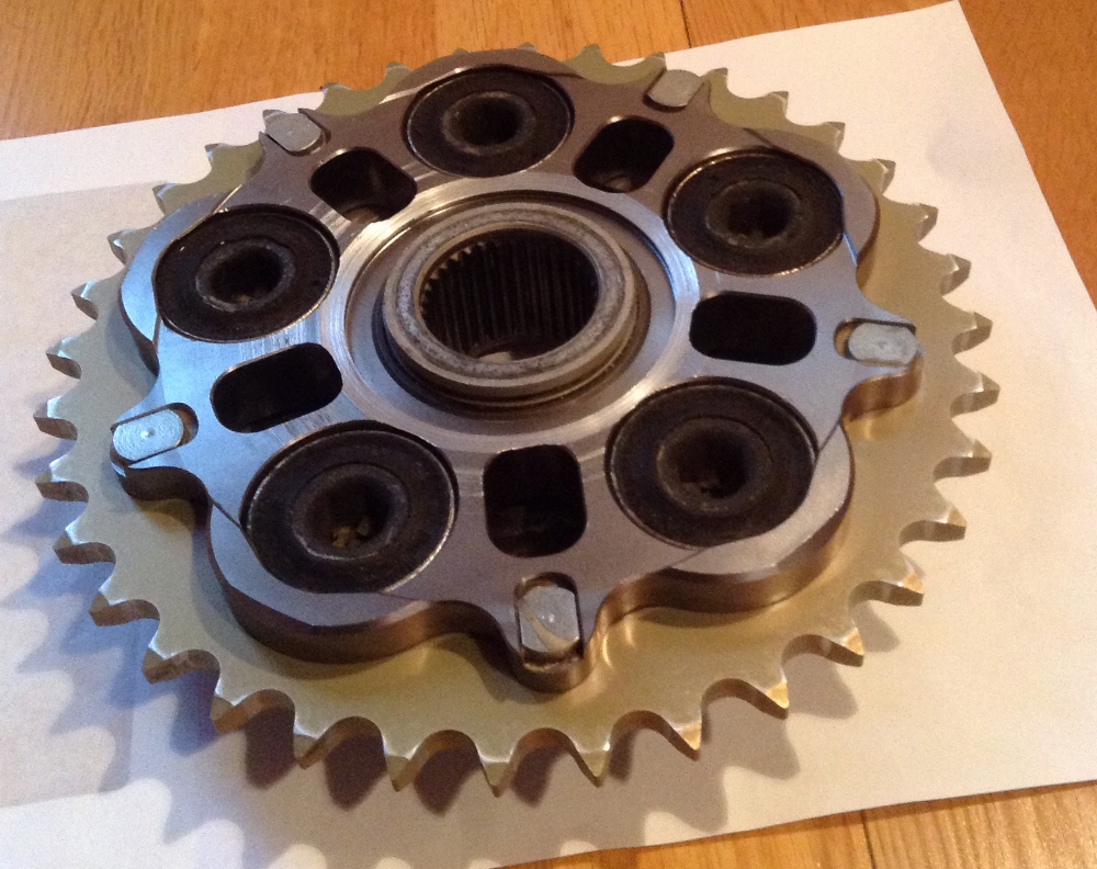

  8. OEM is 14/38, the carriers have a lip cast/machined onto the face which prevents the cush from moving out, you can see it if you look on here http://www.avantiraceparts.co.uk/shop.php?cat=22 click on the picture and you can see it at 12 o'clock

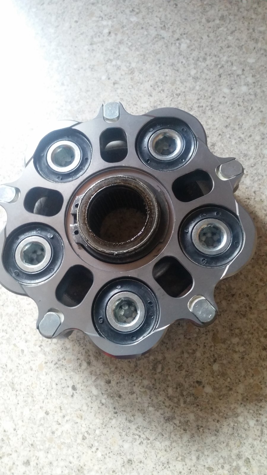

    Just done mine, as the cush drives came out and ate my hub. Below is the m&p one with the lip, and a renthal sprocket fitted.Well worth doing.

  14. That looks identical to the Renthal carrier, in which case there should be a big washer under the circlip, otherwise there will/might be enough lateral play for the carrier to just touch the eccentic adjuster and rub. It's not as bad as the cush drive problem but it can happen. The issue is eliminated by fitting the later style hub, which has a conical spacer and no circlip.

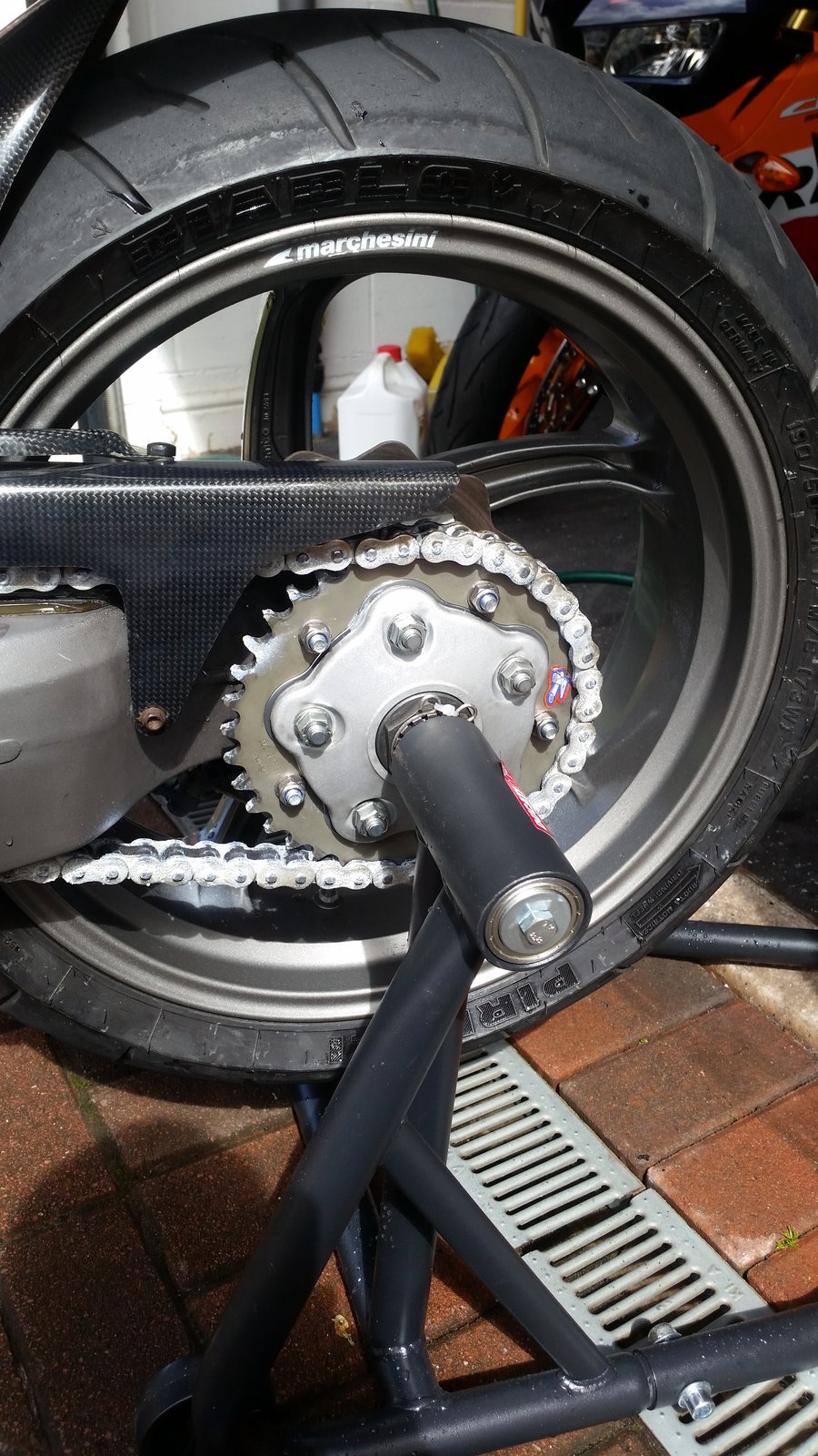

  15. Like this
  16. The circlip on mine ate away the groove until it did machine the eccentric a little.
    I fitted the later 998 style with conical spacer then a few years later a cush drive went and finished the job off...
