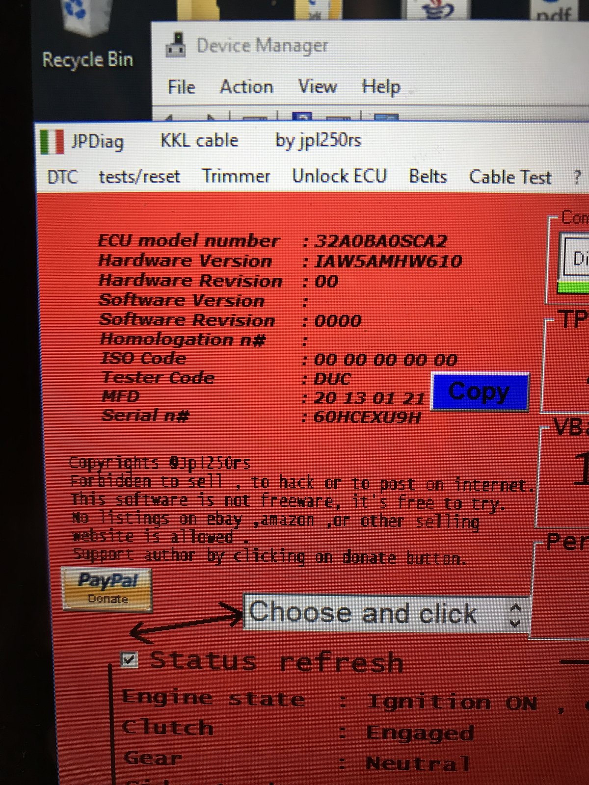

  11. 1DD24124-E3E8-4F53-ACDF-3F6CFFDC8E02.jpeg Sorry for late reply. I’ve only just got around to connecting the laptop to the bike - here’s what I found:
  12. For any of you researching because of similar problems - I've now solved it!
    The issue was with the clutch switch. It was stuck permanently engaged (for probably 2 years at minimum!) Thankfully I never attempted to start it in gear. I freed it off, et voila, problem solved!
