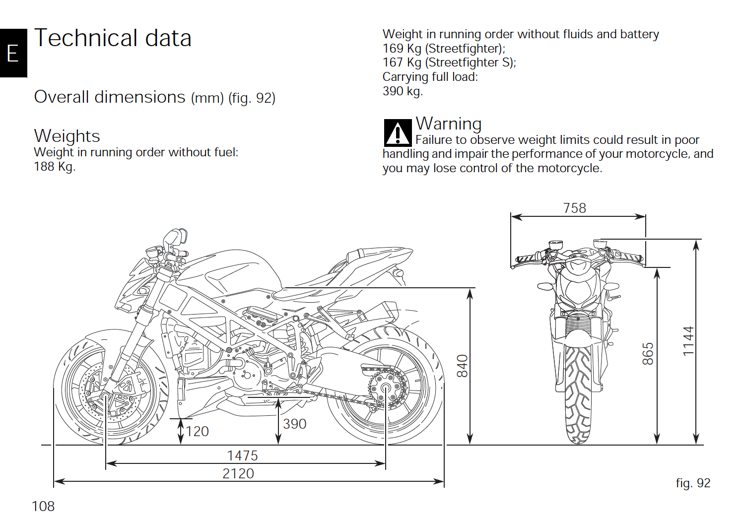

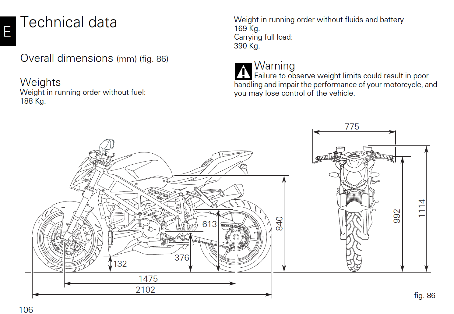

  4. The user manuals for the 1098SF(S), 1098SF and 848SF all state a wheelbase of 1,475mm, so it would make sense that they are all the same.
  5. I think that clears it up then :upyeah:many thanks, now all I need to do is locate a good used one :worried:.

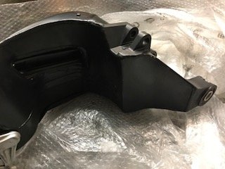

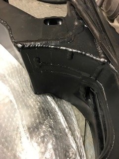

    It is possible to modify a SF arm to
    1 run with a 200 rear tyre with clearance for tyre warmers.
    2 and running the eccentric at the front of its movement get it to the above length of 515 =525mm (In fact if you are using the Kyle linear rocker then he recommends it at 525.) well within the similar range of the RS.
    the size of the hub is irrelevant as the arms are the same diameter both fit each other.
    This is the modification underneath and inside the arm to make clearance for the tyre, for some reason the radius of the inside of the arm doesn't match the radius of the tyre.
    This is the side cleaned up to give a bit more clearance for the exhaust. When you remove the original aly cover the the casting is back this far anyway.
    another good mod to do is to make it fit like a 999 swing arm using their bushes on the left side. This eliminates having to remove the engine or lift the frame off the engine to get the arm in and out.
