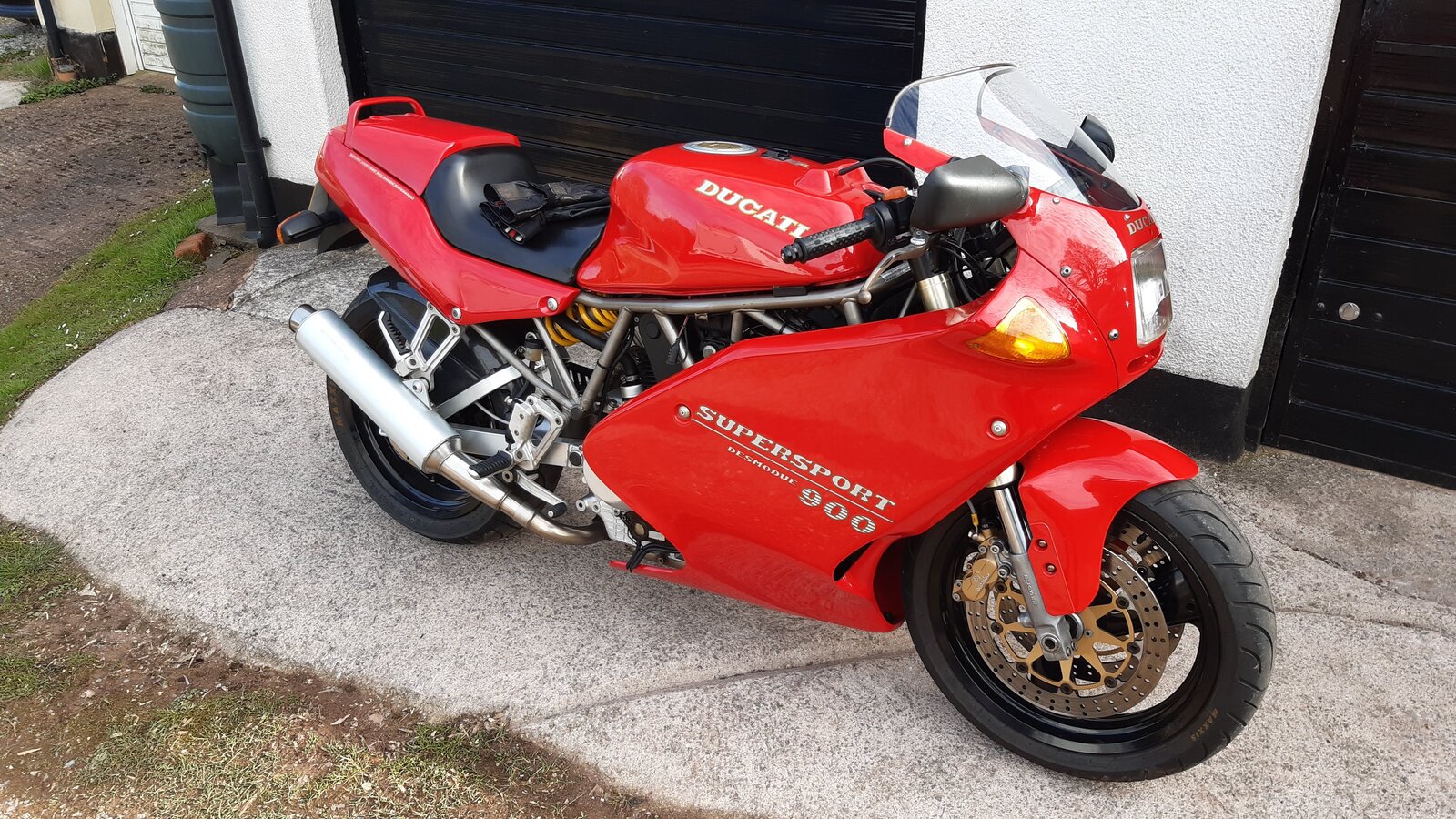

  1. Had to go and buy some milk, so essential journey to shakedown / test my 900 carbie after its winter refurb!
    Long list of work carried out -
    • powder coated front fairing support frame, handlebars, rear sus spring & top yoke
    • new steering head bearings - made a big difference
    • front discs stripped, carriers painted, bobbins cleaned - perfect braking feel now
    • calipers F & R stripped & painted
    • new HEL brake & clutch hoses
    • new chain & sprockets - rear changed to 39T. Much better at low speeds
    • forks stripped & cleaned out, new seals, 5W oil, bottoms satin polished
    • wiring tidied up - perished rubber boots replaced on some ends, all connectors cleaned
    • exhaust downpipes cleaned off with Harpic x10 - amazing results
    • flaky engine paint removed & painted
    • all bolt heads cleaned , a few replaced
    • screen scratches polished out - came up really nice
    • few scratches touched in & polished out
    • stainless steel oil cooler guard made & fitted
    • removed all the crumbling foam from under tank - no more bits in airbox!
    • removed every bit of grime form the hidden corners - complete bike now very, very clean :)
    Lovely little thing to work on and even better to ride! Fork refresh has worked wonders for the front end feel - definitely on rails and more supple with the 5W oil. Maxxis tyres it came with are pretty good , 170 rear so no problems with rubbing on new to me carbon hugger - old one had been scored and nearly worn through ( 180 tyre?)
    Can't wait for the 29th March and hopefully better weather. :)

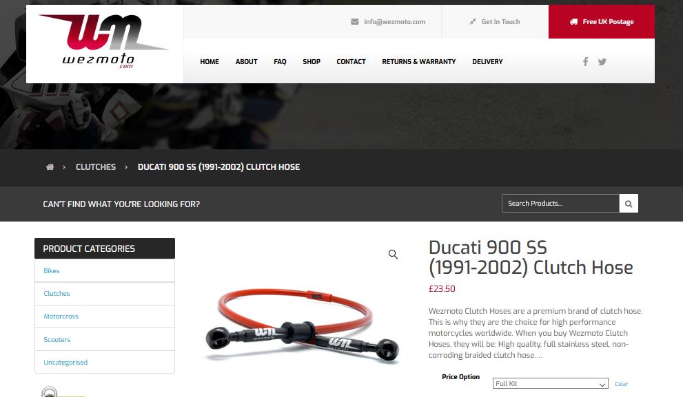

    I'm currently fettling mine after a long time off the road (a 1994 900SS) - can you tell me what difference did the Hel braided clutch line make? I was considering changing mine but not sure how the clutch would feel afterwards - harder, better or just 'different'? I'm using a standard Ducati clutch slave cylinder at the moment which I rebuilt with a 'X Ring' to replace the original O ring, (also I have the original 1994 rubber clutch hose!).
    Cheers Pete
    Has anyone tried this clutch line, made by "Wezmoto", £23.50 plus delivery, (various colours) Clutch hose.JPG

  12. I fitted a Wezmoto clutch line to my SS not so long ago. I think it’s absolutely fine. Nicely finished with stainless steel fittings, looks fine in clear, can’t vouch for the coloured versions. Noticeable how much clearer the clutch fluid is now that the original clutch line has been binned, been on there for 27 years.
    Also used Wezmoto brake line on the 600 Monster more recently.

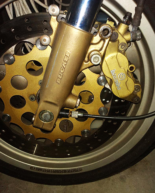

    I'm always surprised by how many variations of frame, forks, wheel colours, fairing decals there are, this is my 1994 front, as you can see I have 'bronze' fork bottoms unlike your silver ones, my frame is bronze too and as you
    can see the wheels are a sort of silver/bronze colour, (which look good as long as they're clean!)
