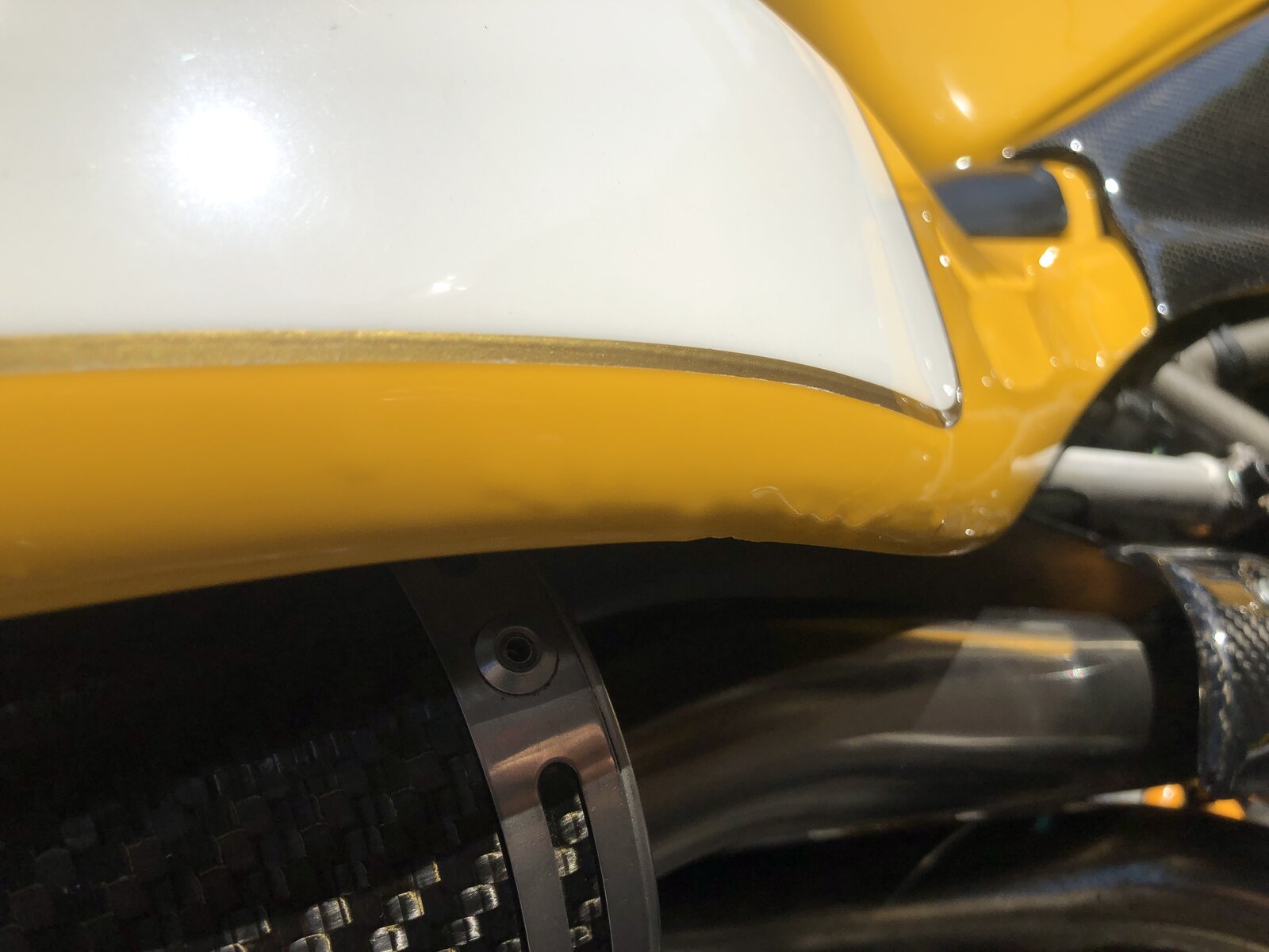

    Really bad paint runs in the paint/clear coat on the seat fairing
    Moisture under the lacquer on the seat fairing

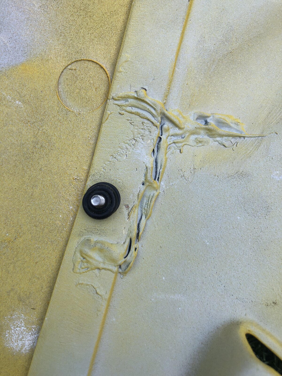

    Top fairing repair has started to crack along the original damage and has broken the paint in 4 places

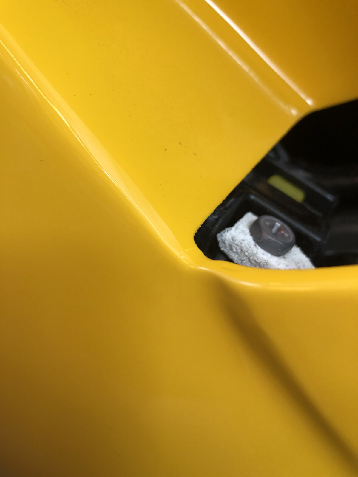

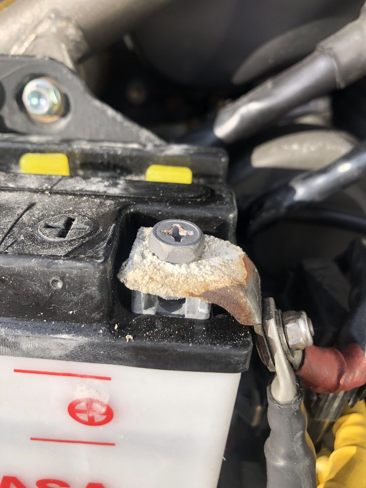

    Battery terminal has corroded and discoloured on the positive terminal of the new battery and has started to get hot (now disconnected)
    O/S fairing has cracked along the lines of the repair in 2 places
    The paint around these cracks is soft and like gel. More than likely hasn’t been left to cure properly
    Repair to the chips on the O/S frame stands out like a sore thumb and can see the sanding lines
    New scratch on the frame next to the battery

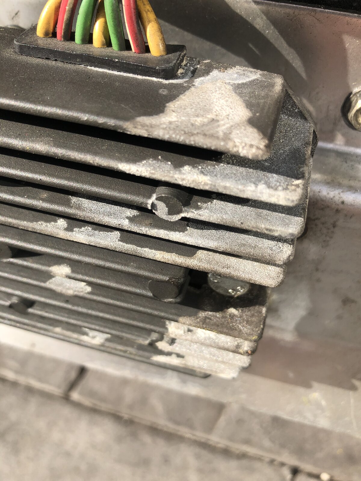

    Battery acid damage to reg/rectifier

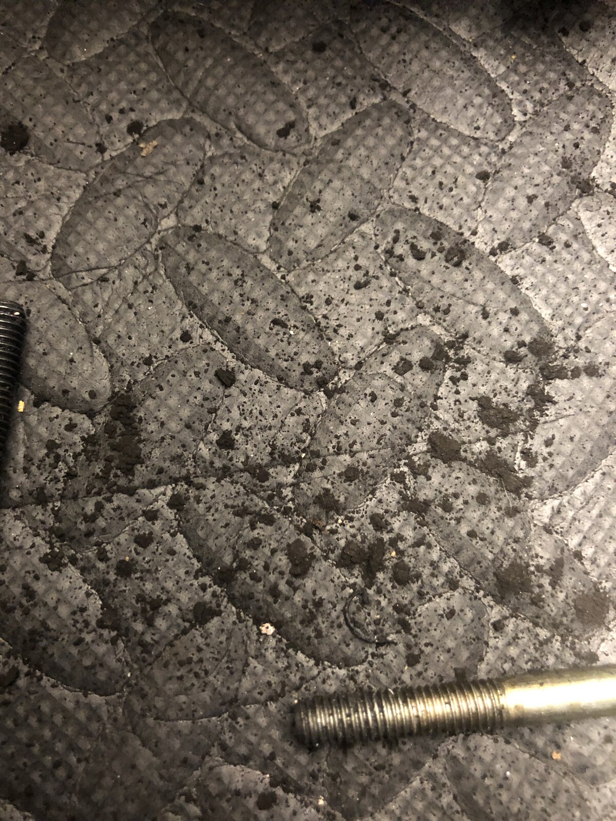

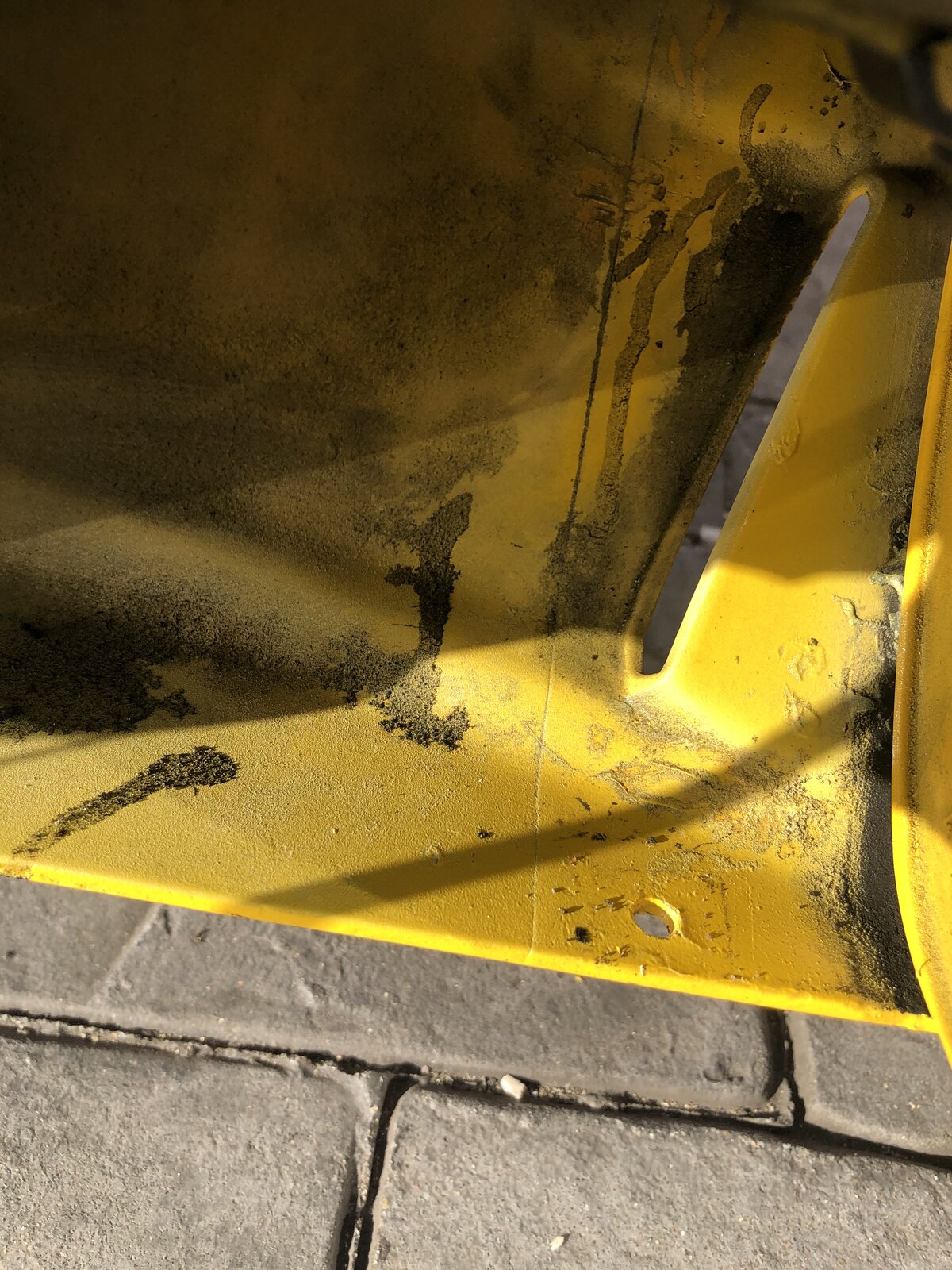

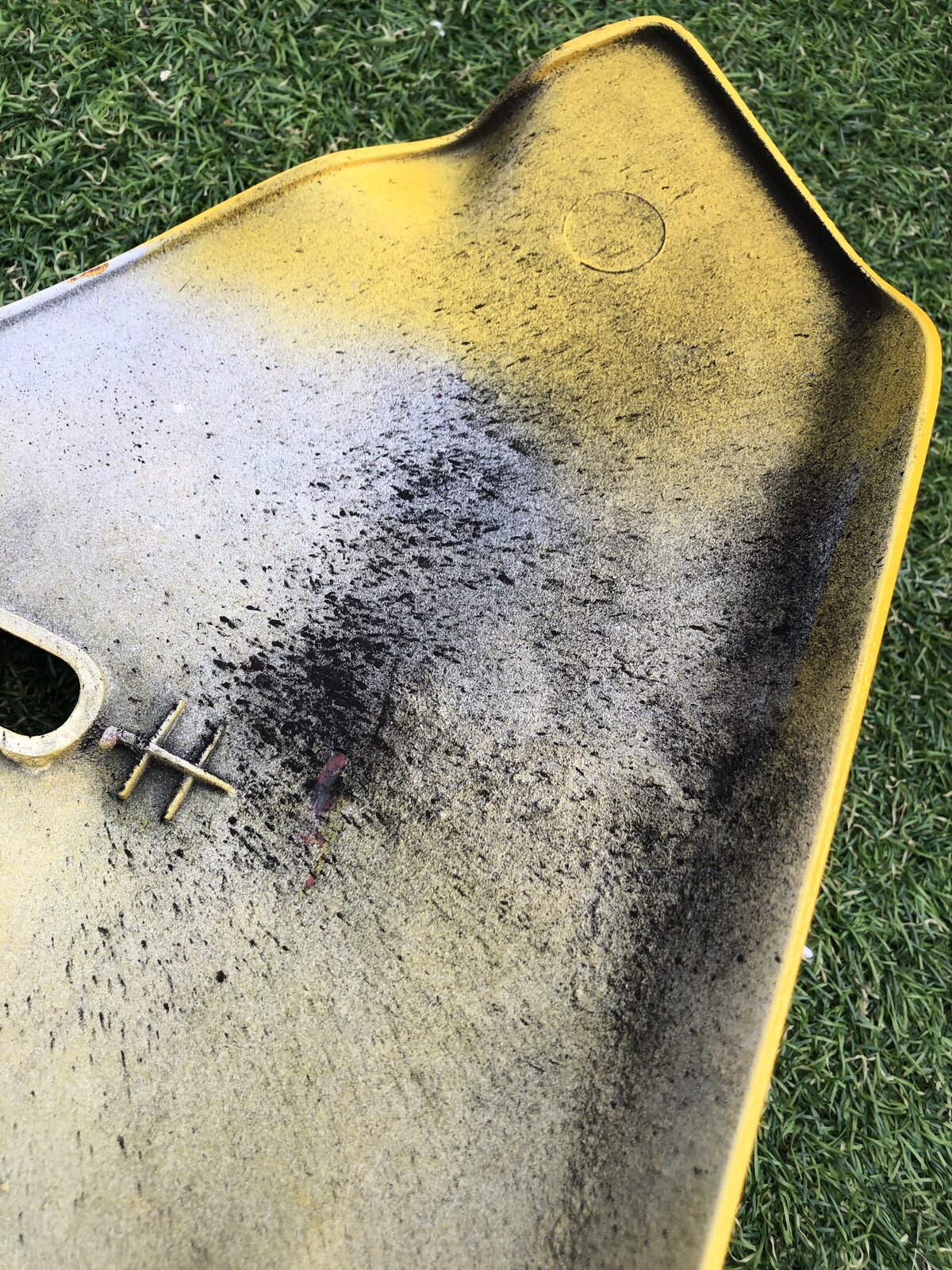

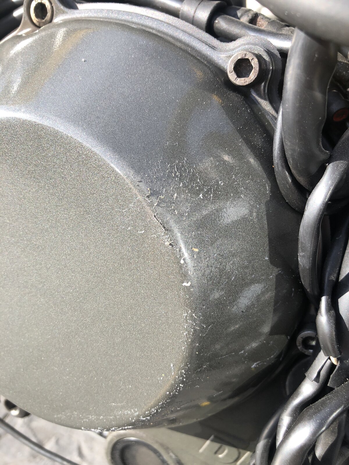

    As the bike fell on its side, it’s broke the carbon clutch cover and left shards. This has been replaced with a standard clutch cover and the bike now churns out an unhealthy amount of dust from the clutch.

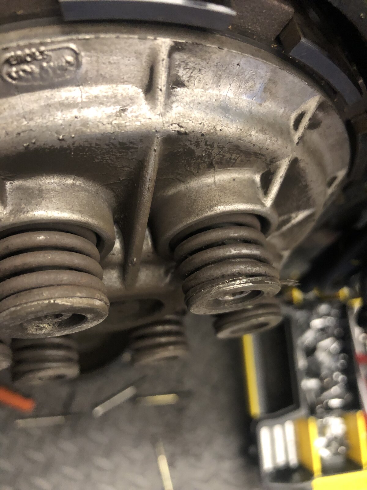

    I remove the clutch cover and found carbon fibres still stuck in the springs, a couple of the collars are damaged where they’ve hit the floor and the basket is loose.
    The clutch is only 250 miles old and will now need replacing.
