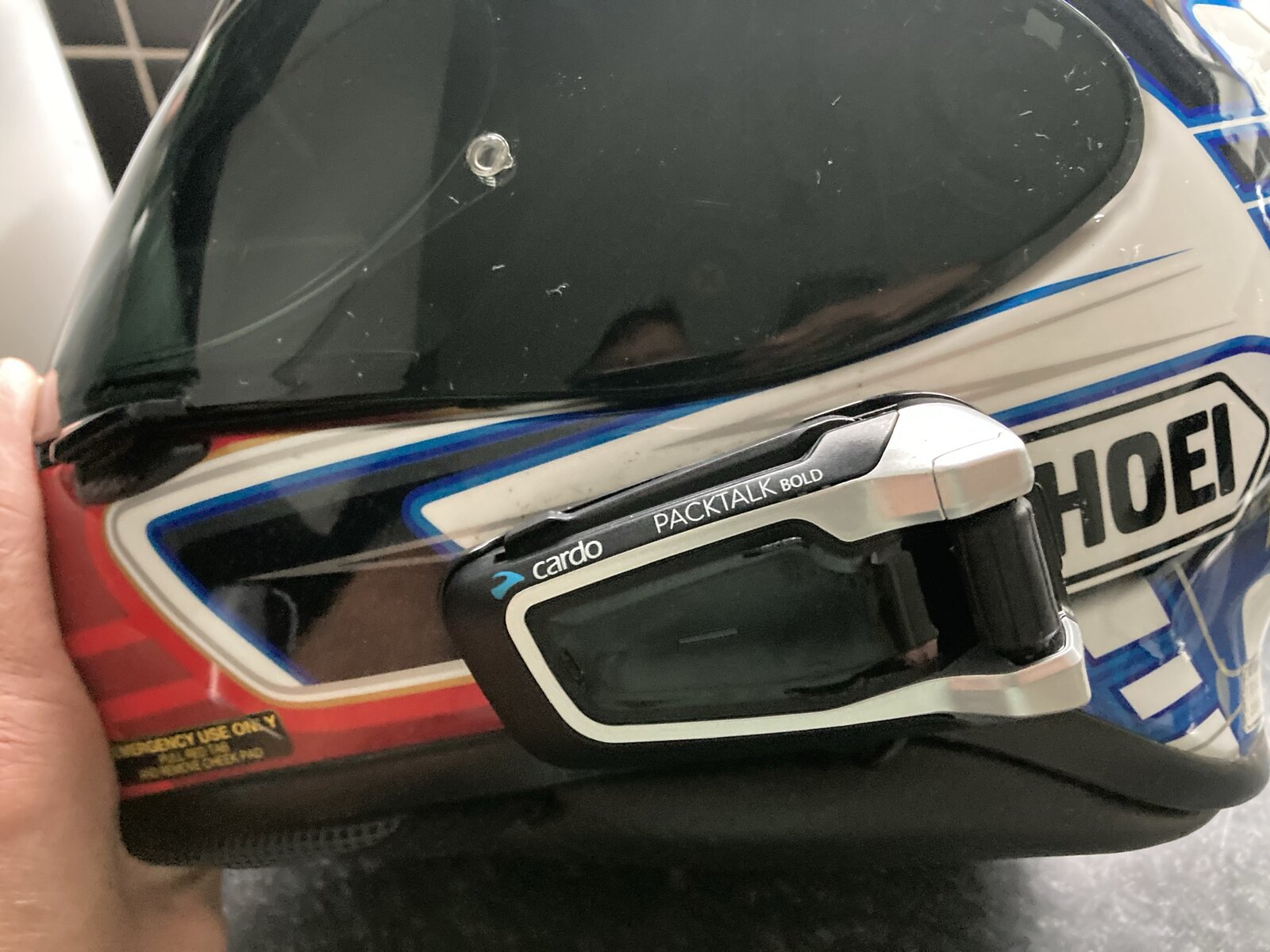

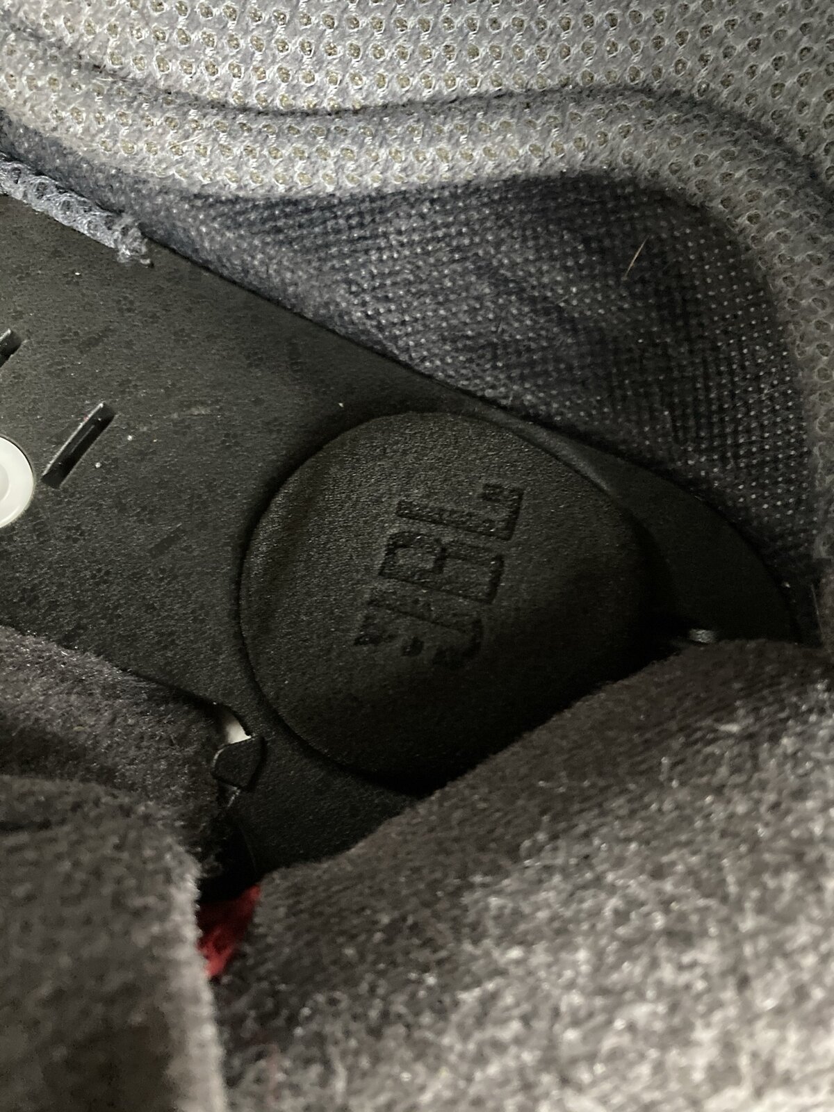

  16. Looks like the Bold is a better fit and I had no issues fitting their speakers A57F6E7A-2119-4C51-BDF8-0107A94BF741.jpeg 264579BA-7EC0-4855-A01D-2AF4F300FF59.jpeg
  17. So the jbl ones that come with the bold in the box fit flush in the nxr?
    Also no problem using the bracket and squeezing that up the side between the outer and inner helmet?
    I really want to avoid the adhesive bracket

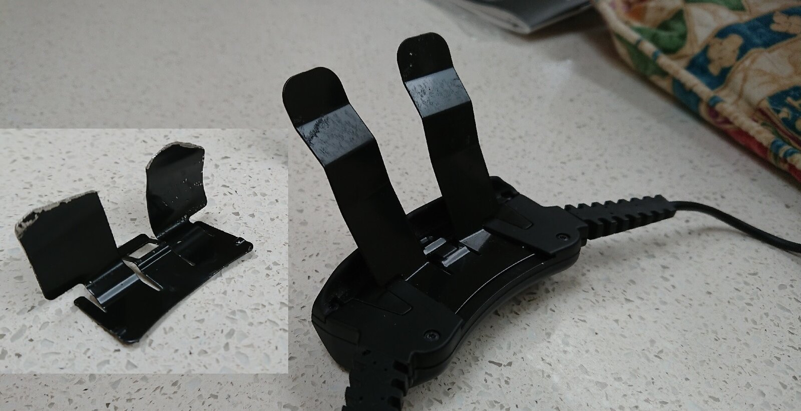

  18. Yeah I don't think there's any way the Packtalk slim control unit could be pushed fully home onto the hard shell but there's a fair bit of padding below the shell so it doesn't look like it's just hanging in mid air. Also, the prong that goes up under the shell is 4 inches at least, there's no way it's falling out. However, I did have to cut down the prong for the battery to maybe 2cm (see pic) but it's a tight fit so again it's totally secure, and it's hardwired to the control unit so even if it did work loose it wouldn't fall to the ground.
    PS if you have any comments about my metal cutting skills, please keep them to yourself. I didn't think to use the Dremel, I just went with tin snips and a file.

  19. Fits flush and I used the adhesive pad as it was a better fit, What I can remember I think it was a little bit tight using the metal bracket
