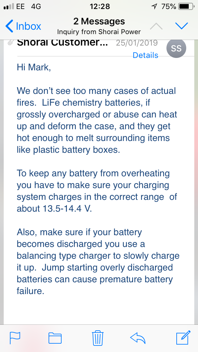

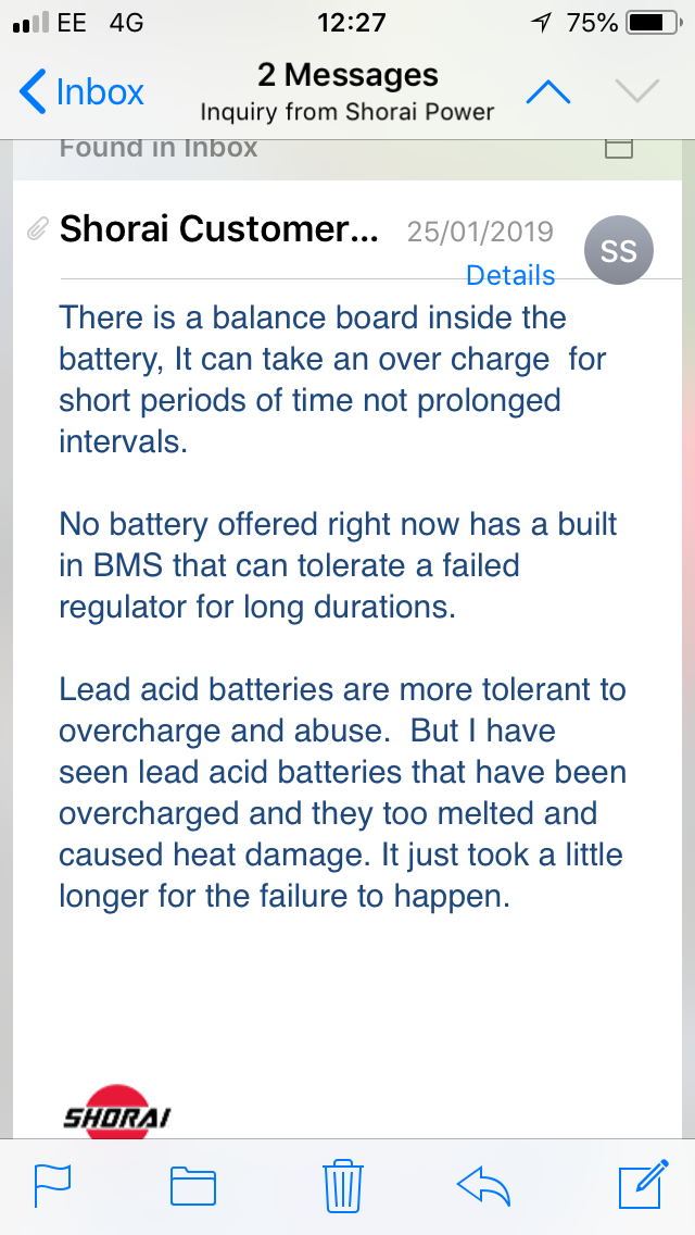

  1. I have never had any problems with Lithium batteries but I thought I’d ask Shorai what would happen if ones reg/rec failed when out for a ride...
    AC2F69FA-039E-44B9-B62D-DA8DC39CEA8D.png 95167F41-D124-4F23-A5B2-E05AEA024CED.png Above is what they said, how many is “not too many” ?

  8. I think you’ll find it’s shoite regulators that make the batteries go boom overcharging same for yuasa as a lithium

  13. I wonder what Shorai meant by they don't see many fires :thinkingface:
