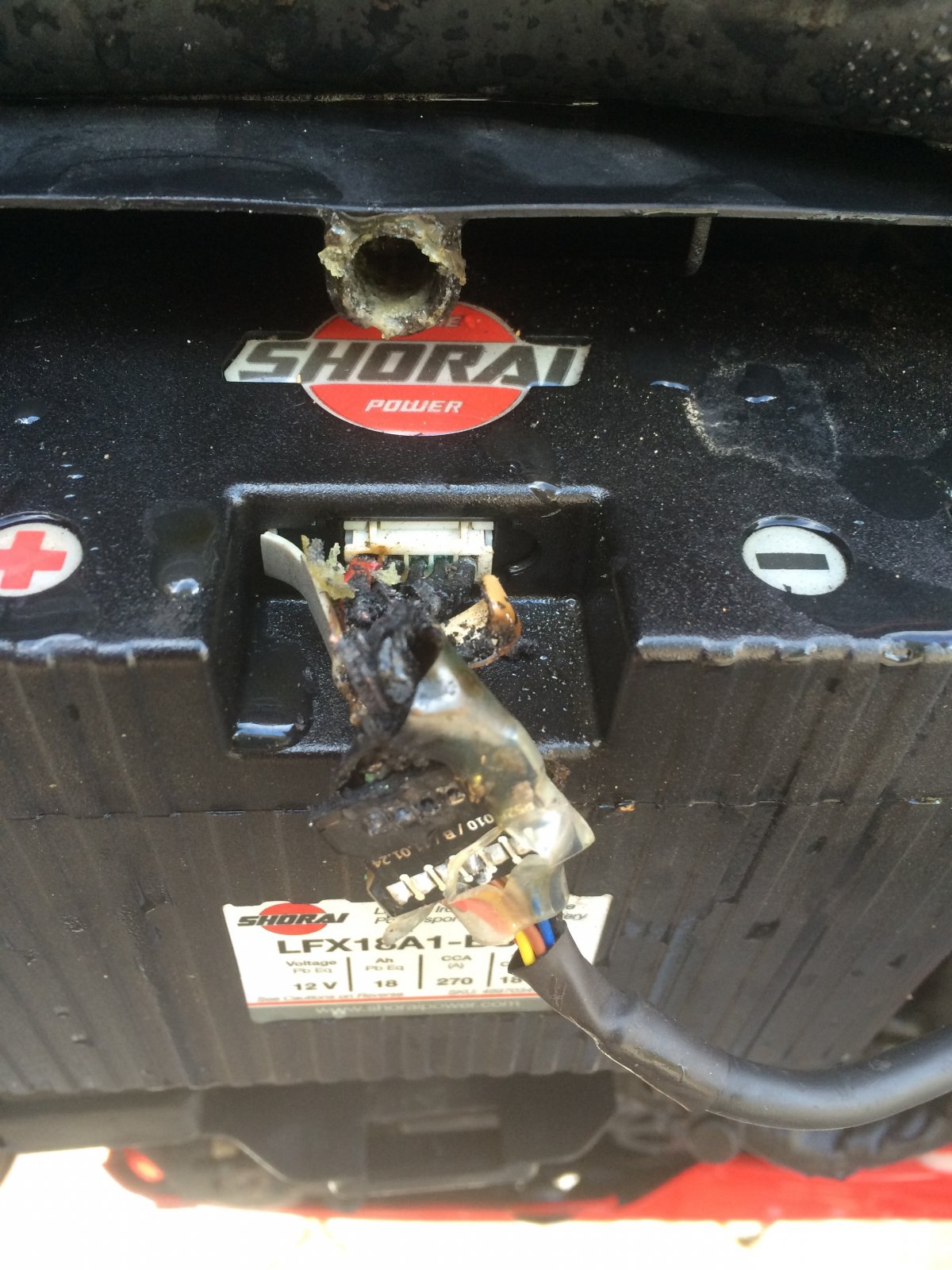

  1. was washing the 1098 today when I smelt burning, had a quick sniff and look to find smoke coming from the the area of the battery. Ripped the side panel off as quick as I could given the ridiculous amount of varying sized Allen heads to find this image.jpg anyone else had this happen? Need a new charger extension cable I reckon.

  5. Nope, just a bucket and sponge, actually I think the washing is unrelated, looking at the terminal pins in the battery it looks like they've have corroded for some reason. Seems there's been some sort of short.

  11. That connector cover looks like a real water trap, and the connector itself looks a little under rated for the amps going through a bike battery as well!
    May have just been corroding over time until it finally got so bad it got hot, melted the shroud and then shorted.
